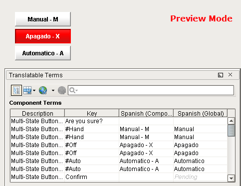

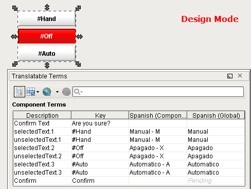

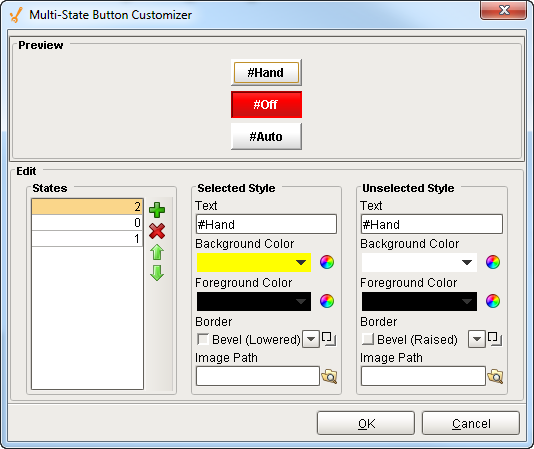

The "#" can also be used on components for text that you don't want accidentally translated. This example uses the Multi-State Button component. The only way to change the states / words on the buttons (i.e., Hand, Off, Auto) is to use the Multi-State Button Customizer. Add the "#" for each of the three Keys so they don't get translated by global terms that have already been set up.
Here's what the translations look like in Design Mode and Preview Mode:

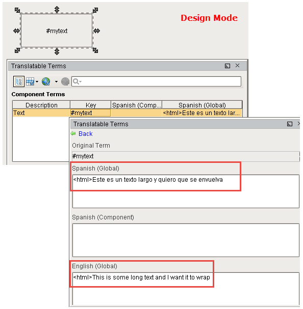

Using HTML for Text Wrapping​
Another good practice is to use HTML to wrap text within your component's buttons, labels, etc.,. You can use it with translating terms that contain lots of text. HTML is just a good way to wrap text to fit within a label and button components.

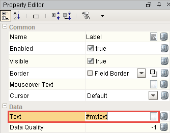

  1. In the Property Editor of a Label component, go to the Text property and give the Text a unique name (i.e., #Mytext).
  2. Right click on the Label component and click on Translations. Double click on the row for Mytext. Enter the text as shown below for both the Spanish Global and English Global translations. Make sure you precede your text with <HTML>. Click the Back link.
    Mytext
    #English
    <html>This is some long text and I want to wrap it
    #Spanish
    <html>Este es un texto largo y quiero que se envuelva
  3. Once in Preview Mode, your long text will be wrapped!
