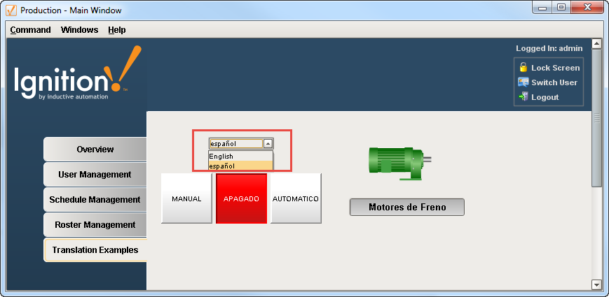

Selecting a Language in the Client​
Once you have the Language Selector component setup, it's super easy to select and switch between languages in the Client. There is no binding involved in selecting a language because they are compared directly against the Translation Manager database. All matching terms are automatically translated.
There are three simple ways to select a preferred language once the translation terms are created:
  1. Add a Language Selector on your window in the Designer. After you Save and Publish your project, open the Client, and the Language Selector will be visible so you can switch between languages on the fly.

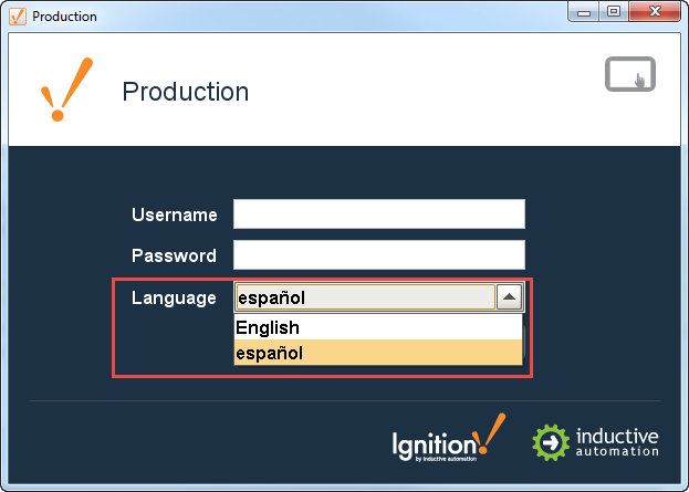

  2. Once you create a second language, the Client Login Screen will automatically display a Language Selector where you can select your preferred language. There is Project Property setting that allows you to Show or Hide the Language Selector at login. By default, it is set to Automatic so you will see the Language Selector at login when two or more languages are created unless you choose to hide it.
  3. If a user that has a preferred language selected in their user profile settings, Ignition will login to the Client with their preferred language automatically. No Language Selector component is necessary. This is especially cool if your company is using Active Directory which automatically logs you in and opens the Client in your preferred language.
