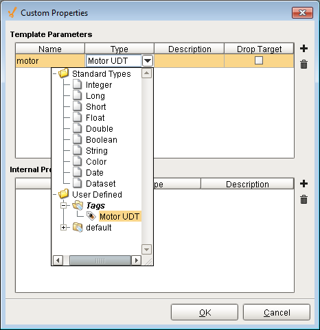

  3. Create a Custom property on the template's Root Container, and make the Custom property's Type a User Defined type instead of a Standard data type and click OK.
