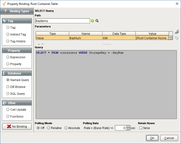

Using Named Queries on Dataset Properties​
The majority of your Named Query bindings will most likely be on a dataset type property. When placed on a Dataset type property, only a single Named Query needs to be specified. An explanation of the various fields on the binding are detailed below:
  • Path: Here you can enter in the path to the Named Query. Click on the magnifying glass (magnifying glass button) button to get a list of all available Named Queries that you can choose from.
  • Parameters: Here you can see a table of all defined Named Query parameters. You can pass in property or Tag values to the parameters by first highlighting the parameter and then selecting either the property (property button) button or the Tag (tag button) button.
  • Query: In the query section, there is nothing to configure, but you can see what the Named Query you have selected looks like.
  • Polling Mode: Here you can set the Polling Mode of the Named Query binding based on the Polling Rate.
  • Retain Rows: If true, any rows that you have returned within the Designer will be saved along with the window. This may slow window load times.

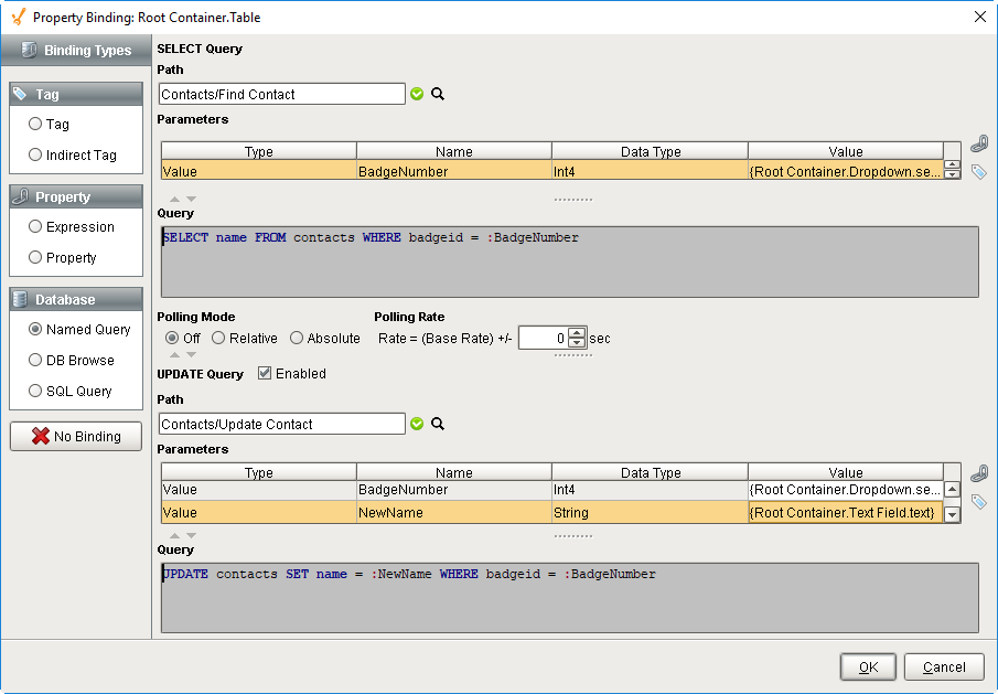

Using Named Queries on Scalar Properties​
When placed on a non dataset type property (such as a String or Integer) then the Named Query binding allows for a second Named Query to be specified in the case that the user can update the value on the property. This provides an opportunity to both return and update values in the database from the same component.
The configuration is very similar to a Named Query binding on a dataset property. You need to specify a Named Query path, set up your Parameters, and choose a Polling Mode. You can finish setup at this point, leaving the update query disabled so that the property will simply pull the value from the database.
However, if you want the binding to be bidirectional, you need to specify an UPDATE query. This also works much the same as the SELECT query in that you need to select the path to the Named Query and setup any Parameters. However, it is important to make sure that the Named Query chosen for the update query is in fact setup as an update query by setting the Query Type property on the Authoring section of the Named Query.
