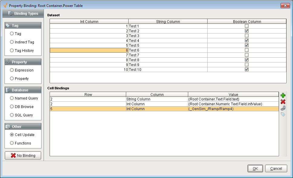

The cell update binding has a few tools that help you make certain cells dynamic.
Cell Update Binding: Binding a Dataset Property to Realtime Values
The top table called Dataset displays the original dataset, while the bottom Cell Bindings table displays each of the cell updates that will be occurring. Each Cell Update binding can have multiple cell updates happening on a single dataset. To the right of the Cell Bindings table are four buttons that are used to create the Cell Bindings:

Adding Values to the Cell Bindings Rows​
Each row in the Cell Bindings table needs three values to work properly:
  • A Row identifier, which is used to figure out which row the cell binding is on.
  • A Column identifier, to determine the column of the cell.
  • A Value, which will replace the original value of the cell.
These three values can pinpoint a specific cell, and replace its value with the dynamic Tag or property value specified. The examples in this section use the dataset in the image above.

No two rows should specify the same cell, as this will throw an error.

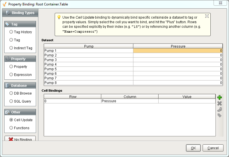

Let's use the table above table to create a Cell Update binding to get the pressure readings into the table.
  1. Open the property binding (property binding icon) on a Data property, click the Cell Update binding type, and you'll see your dataset along with a Cell Bindings area.
  2. Select the first pressure reading, and click the add (add button icon) button in the Cell Bindings area to add a row. You'll notice it added a row number, column name, and blank value cell because we selected a cell from above. What you place in the blank Value cell determines what the value will be in the table.
    Cell Update Binding - Realtime Tag Values in a Table Step 2

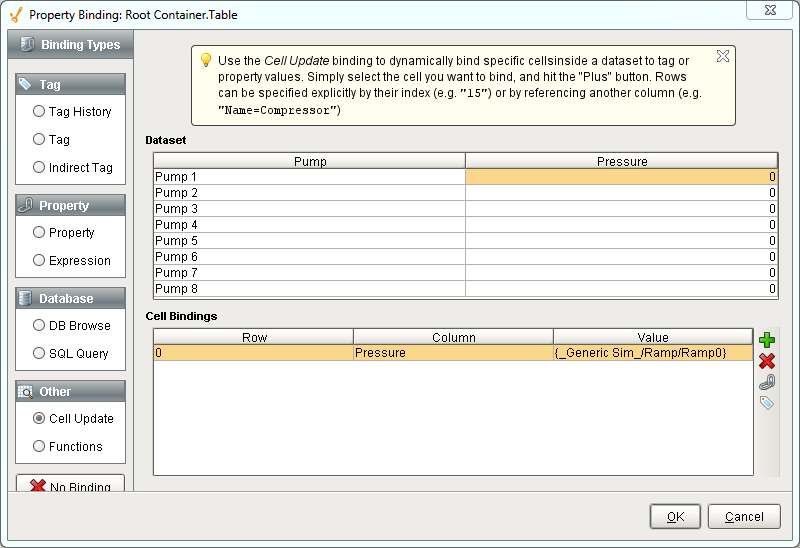

  3. Select the first Row and first Value cell in the Cell Binding area. Use the Tag (tag icon) button to the right to select the Tag reference. You can also manually type in your Tag reference, or place in a property reference instead.
    Cell Update Binding - Realtime Tag Values in a Table Step 3

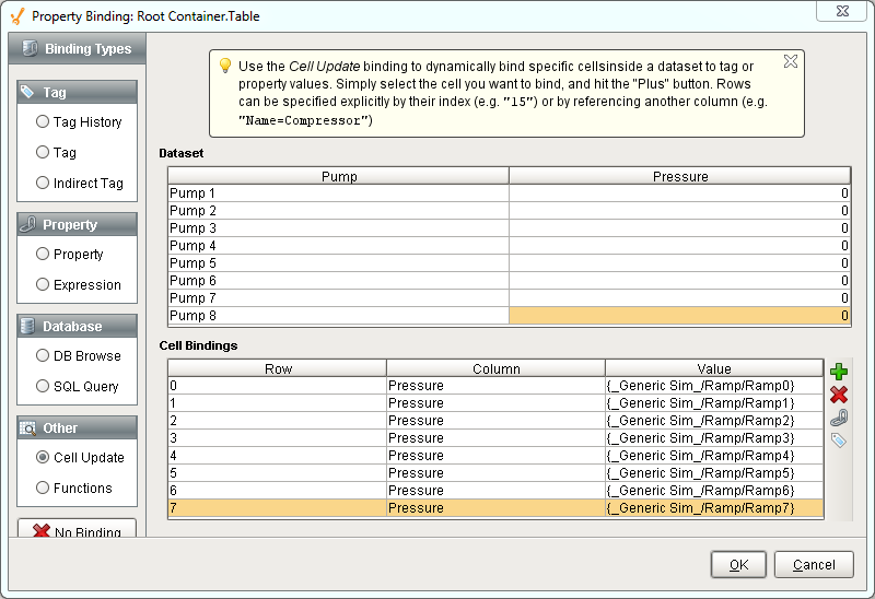

  4. Now, you have the value of that Tag to the Pressure column in row 0. Repeat Step 3 for the other seven Pumps so that the Cell Binding area looks like the image below, then click OK.
    Cell Update Binding - Realtime Tag Values in a Table Step 4
  5. You can see that the Table values are now updating with the value of their respective Tag.
    Cell Update Binding - Realtime Tag Values in a Table Step 5

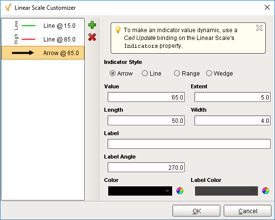

The Linear Scale is a component that has a special Scale Indicators customizer that allows you to configure setpoints. You can setup the value, color, style, and more for each of the indicators. During runtime, these values are normally static, as there is no way to setup a binding in the customizer. However, the customizer merely configures a dataset that the component uses to create the indicators. If you look at the Indicators dataset property of the Linear Scale, it has all of the properties that are configurable in the customizer. Changing them from the customizer will alter the dataset, and changing the dataset values will alter what you see in the customizer. Knowing this, we can setup a Cell Update binding to manipulate the values during runtime.
Let's add another indicator to the Linear Scale component and configure it.
  1. Select the Linear Scale and right click on the Customizers > Scale Indicators.
  2. Create a new indicator using the Arrow Style. This new indicator will be whatever the current value is. Set the following properties for the Arrow, and click OK.
    1. Value: 65.0
    2. Length: 50.0
    3. Width: 4.0
    Cell Update Binding - Adding Realtime Indicator to Linear Scale Step 2

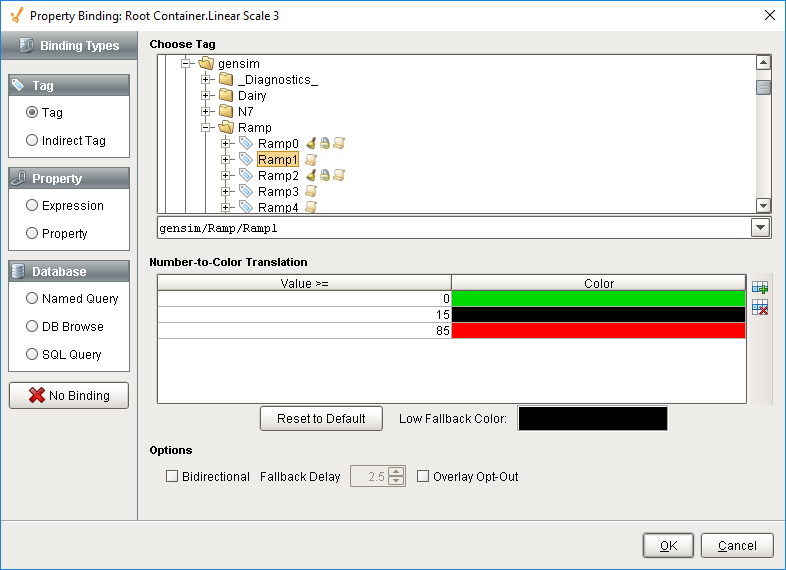

  3. In addition to changing the value of the realtime Indicator, you can also change its color based on its value. If the value is above the high indicator (i.e., 85), the Arrow will change to red, and if the value is below the green indicator (i.e., 15), it will change to green. To accomplish this, setup a custom property on the Linear Scale of type Color:
    1. With the Linear Scale selected, right click on the Customizers > Custom Properties.
    2. Choose Color from the dropdown list, and click OK.
      Cell Update Binding - Adding Realtime Indicator to Linear Scale Step 3b
  4. Next, setup a Number-to-Color Tag binding on the custom Color property. The values shown in the image below are based on the static setpoints that were set in the Linear Scale customizer.
    Cell Update Binding - Adding Realtime Indicator to Linear Scale Step 4

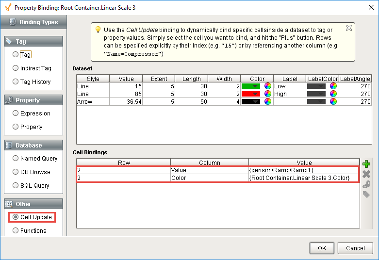

  5. Finally, setup a Cell Update binding on the Indicators dataset property of the Linear Scale. Notice below that both of the cell bindings are for the same row, just different columns. This is fine, as long as there aren't duplicate bindings for the same cell.
    1. Bind the Value cell to the same Tag (i.e., Ramp1) used in the custom property Color binding to get the value.
    2. Bind the Color cell to the Color custom property we just created.
    Cell Update Binding - Adding Realtime Indicator to Linear Scale Step 5
  6. Now, the Linear Scale has an Indicator that moves to show a realtime value, and changes color whenever it goes outside the setpoints. The image below is out of range and the arrow turned red after exceeding the setpoint.
    Cell Update Binding - Adding Realtime Indicator to Linear Scale Step 6
