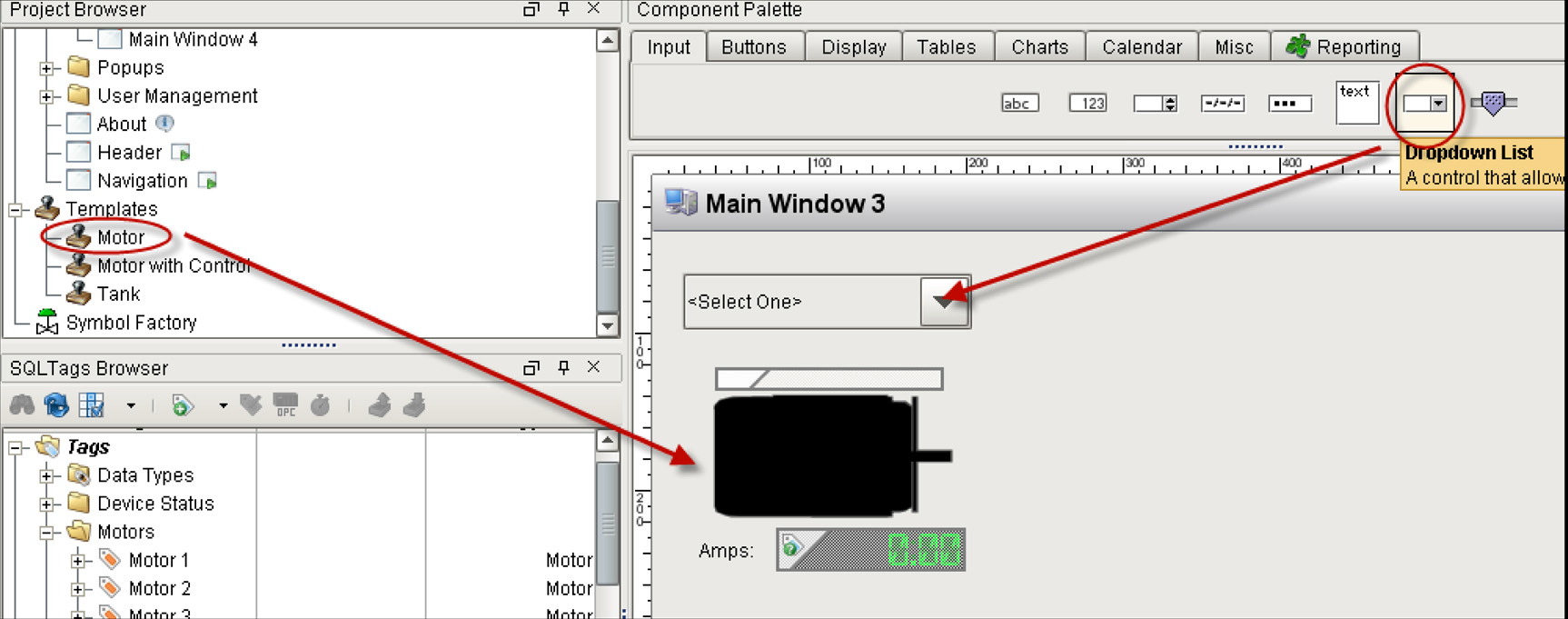

To Create a Window with a Drop-down list and a Motor Template
  1. From the Project Browser, under Templates, drag in a template. In this example, it is a Motor template.
  2. From the Input tab of the Component Palette, drag a Dropdown List component.
    Create Window with Dropdown List and Motor Template Step 2

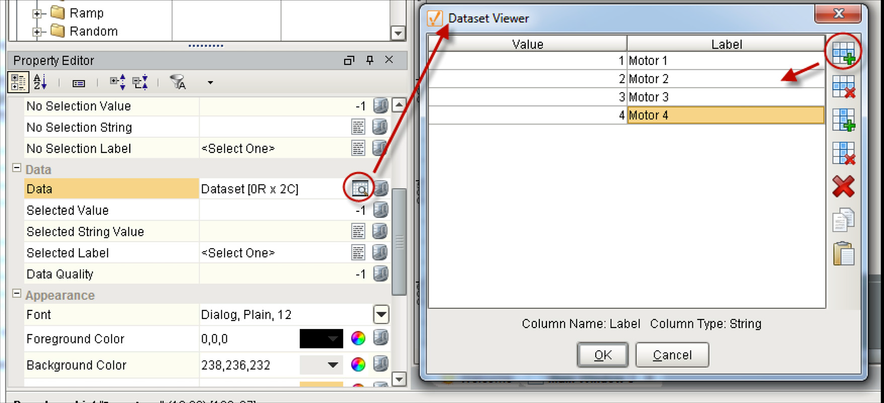

    Now we need to setup the options for the drop-down list in the Property Editor. The drop-down component has the Data property which is a dataset. There are three ways to set up the dataset and the corresponding behavior is as follows:
    Column DetailsExampleDescription
    One Column [String]Apples
    Oranges
    Bananas
    • Drop-down displays values from the first column.
    • Selected Value is undefined.
    • Selected String Value represents value from first column.
    • Selected Label represents value from the first column.
    Two Column [Integer, String](Default)201 Apples
    202 Oranges
    203 Bananas
    • Drop-down displays values from second column.
    • Selected Value represents value from first column.
    • Selected String Value represents value from second column.
    • Selected Label represents value from second column.
    Two Column [String, String]APL Apples
    ORN Oranges
    BAN Bananas
    Let's use the default mode which is the second option above. Two Columns [integer, string], to set up the options in the drop-down list.
  3. Select the drop-down component and click the Dataset view icon next to the Data property.
  4. On the right side of Dataset Viewer window, click the + green row icon four times to add 4 rows.
  5. Set the rows to the following values:
    Row NumberValue
    1Motor 1
    2Motor 2
    3Motor 3
    4Motor 4
    Create Window with Dropdown List and Motor Template Step 5
  6. Click OK to save.

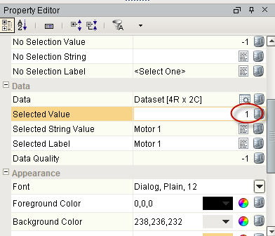

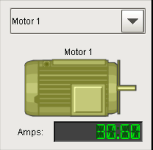

  7. Set the Selected Value property to 1. Notice the values for Selected String Value and Selected Label fill in for you.
    Create Window with Dropdown List and Motor Template Step 7

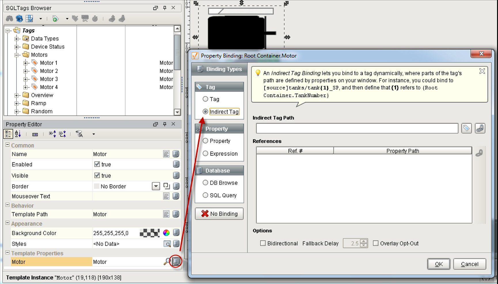

    We want to use the Selected Value in an indirect binding on the template to dynamically select which motor to look at.
  8. Select the Motor template on the window and bind the Motor UDT property to an Indirect Tag.
    Create Window with Dropdown List and Motor Template Step 8

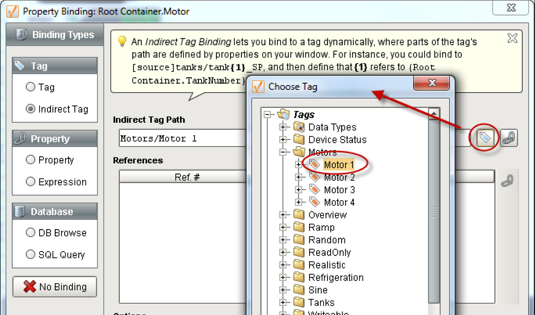

    The easiest way to use the indirect Tag binding, is to select a Tag as a starting point and then make it dynamic.
  9. Click the Tag button on the right of Indirect Tag Path and select the Motor 1 Tag as the reference.
    Create Window with Dropdown List and Motor Template Step 9

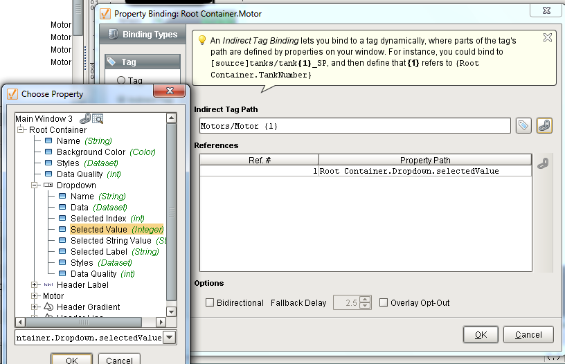

    The drop-down list contains which motor number to look at. So we need to link the Motor Tag number to the drop-down’s selected value.
  10. Highlight the number 1 (in Motors/Motor 1) in the Indirect Tag Path, then click on the link button to the right to bring in the drop-down's Selected Value property.
    Ignition replaces the 1 with a {1} and links it to the drop-down. That means Ignition substitutes {1} with the value of the drop-down allowing it to select which motor Tag to look at.
    Create Window with Dropdown List and Motor Template Step 10
  11. Click OK. Now you can try it out.
  12. Save your project and open the runtime. You can change the drop-down list and it will select a different motor.
    Create Window with Dropdown List and Motor Template Step 12a Create Window with Dropdown List and Motor Template Step 12b
    It is as easy as that to setup Tag indirection. You can apply this method to popups or anywhere in Ignition.
