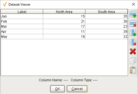

Initial Dataset​
When a Bar Chart is first created, the component will contain a dataset that looks like the following:

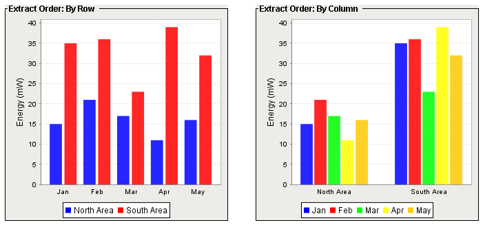

Extract Order​
The Extract Order property on the chart determines how data series are defined. By default, the property is set to By Row, which means each row is a series, and each column (except the first) is a category. Based on the initial dataset, datapoints are grouped by area (column) and then grouped by each month (row). If we set the Extract Order property to By Column, then we see that each data point is grouped by the month (row), and then grouped by each area (column). Note, that the underlying data has not changed, but rather how it is rendered as shown in the images below.

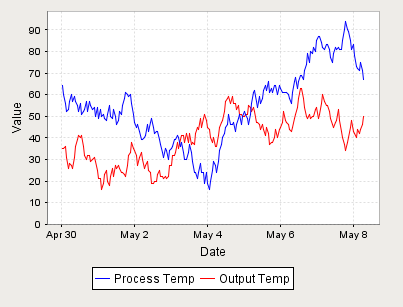

The Chart component, also known as the Classic Chart can be used to create many different types of charts by rendering the data in different ways. This means that depending on the type of data you have, you may use the Chart component in very different ways.
By default the chart is setup to be used as a time series chart, with default data that shows this behavior. However with the right data, the chart can also display an XY coordinate plot or a categorical plot.
chart-component
Using the Chart​
The default settings on the Chart allow it to be used as a time series chart. Simply alter the dataset in the Data property with new time series data to display it in the chart. You can also alter the renderer in the Dataset Properties to any of the XY renderers to change the way the data is displayed.
To use the chart as an XY coordinate plot, Data should be loaded with a two column dataset, where one column is the Y coordinate, and another is the corresponding X coordinate. The chart will also need to be setup with a new X axis, since the default axis is a date axis.
To use the Chart as a categorical plot, a few things need to change from the defaults. The Data property will need to be loaded with some categorical data. Categorical data will have one column of the dataset be categories of information in the form of a string. The chart will also need to be setup with a new categorical X axis, as well as a category renderer in the Chart Customizer. Lastly, the Chart Type will need to be a Category Chart. When the chart is a Category Chart type, the Extract Order property can be changed to alter how the data is pulled out and displayed in the chart. It works very similarly to the Bar Charts Extract Order seen above.

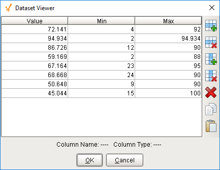

Initial Dataset​
Each new Radar Chart randomly generates a new dataset. The Data property on the Radar Chart must have at least a Value, Min, and Max column. Any additional columns are ignored. To render properly, the dataset must have at least three rows. Datasets with only one or two rows will be drawn as a vertical line.

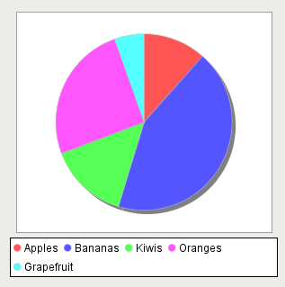

A Pie Chart displays values from several categories, each category is a separate "wedge" of the chart. The total is the sum of all wedges. The key to the Pie Chart component is the Data property, which contains the items that will be displayed as pie wedges.
pie chart
Using the Pie Chart​
Typically, data is pulled into the chart from a database using either a Named Query or SQL Query binding on the Data property. The data typically consists of a list of name-value pairs of things that are related.

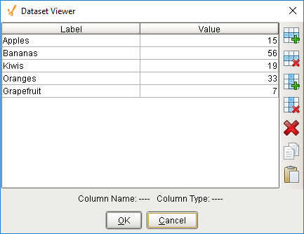

Initial Dataset​
The Pie Chart component contains an initial dataset with two columns, Label and Value. As the name implies, the Label column determines the text associated with each wedge of the pie, while the value is the weight of the wedge.
Pie Chart Initial Dataset
Pie Chart Sample Data Extracted by Column
"#NAMES"
"Label","Value"
"#TYPES"
"str","I"
"#ROWS","5"
"Apples","15"
"Bananas","56"
"Kiwis","19"
"Oranges","33"
"Grapefruit","7"
Extract Order​
When Extract Order is set to By Row, then the data must be formatted differently. This order expects each column to be a wedge. Note that only the first row is utilized when extracting by row: subsequent rows are ignored.
Pie Chart Sample Data Extracted by Row
"#NAMES"
"Grapefruit","Apples","Bananas","Kiwis","Oranges"
"#TYPES"
"I","I","I","I","I"
"#ROWS","1"
"7","15","56","19","33"

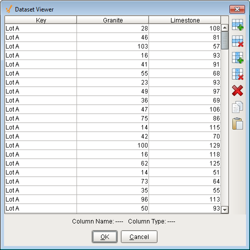

Initial Dataset​
The first column in the Box and Whisker Chart's dataset is the Key column. The Key column determines which series the data pertains to (domain lables). Values in the Key column are case sensitive. The second and additional columns denote categories (legend labels). The initial dataset contains two categories: Granite and Limestone. Additional columns in the dataset would add additional boxes to the chart.
box and whisker chart initial dataset
Box and Whisker Sample Data
"#NAMES"
"Key","Granite","Limestone"
"#TYPES"
"str","I","I"
"#ROWS","200"
