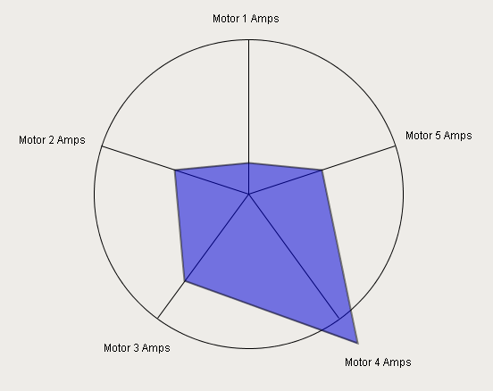

The following shows that the Motor 4 Amps are higher than the maximum allowed for Motor 4. In this example each motor has an independent min and max value for its amps. The radar chart allows an operator to quickly assess a group of independent variables to determine if anything is out of its specifications.
A Radar Chart with five spokes labeled Motor 1 Amps through Motor 5 Amps. The shaded polygon stays inside the circular outer ring on four of the spokes, but extends past the ring on the Motor 4 Amps spoke, showing that its amps exceed the maximum allowed for that motor.
