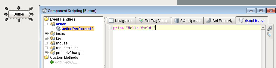

Python - Button Action Performed
# On the actionPerformed of a button, this will print Hello World! to the console each time the button is pressed.
print "Hello World!"

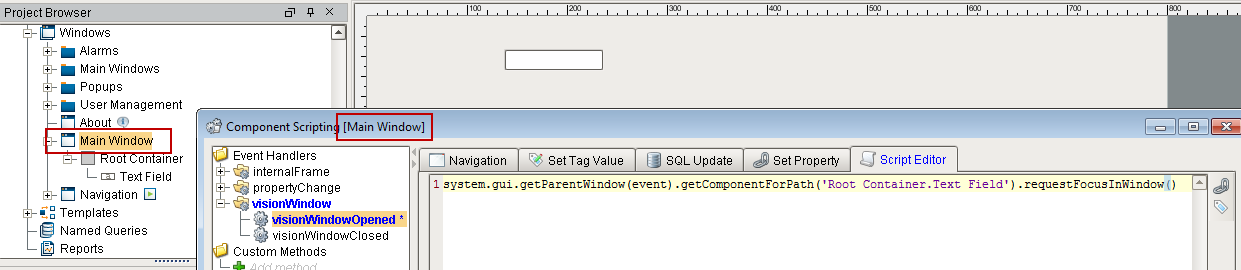

Python - Grabbing Focus on Window Opened in Two Different Ways
# From a visionWindowOpened event on a window, you can request the focus of components in the window, to start the focus on a component other than the upper left most component.
# Here we grab the reference to the component using the property selector on the upper right side of the script editor.
system.gui.getParentWindow(event).getComponentForPath('Root Container.Text Field').requestFocusInWindow()
# Here we can manually enter in the path to the component using our knowledge of the component hierarchy and
# the getRootContainer function. Both of these functions work in the same way.
system.gui.getParentWindow(event).getRootContainer().getComponent("Text Field").requestFocusInWindow()
