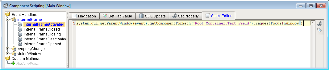

Requesting Focus in the Window​
You can programmatically request that focus be given to a component by calling the function requestFocusInWindow() on that function. This function is called on a component and will pull the focus to that component so it is selected and ready to use. It is best used with an input component, such as a Text Field, so the user can immediately begin typing into the component. You can use it on the internalFrameActivated event to bring focus to the component right when the window opens.

Python - Requesting Focus on Frame Activation
system.gui.getParentWindow(event).getComponentForPath('Root Container.Text Field').requestFocusInWindow()

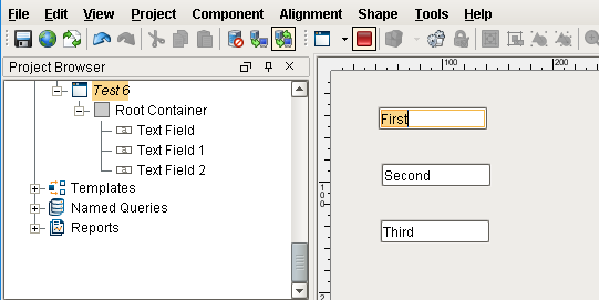

Controlling Focus Between Components in a Window​

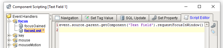

In some cases, you may wish to control which component gains focus when the user clicks on a different component, or tabs away, instead of using the default focus order. You can call requestFocusInWindow() from the focusLost event to control which component should gain focus next.

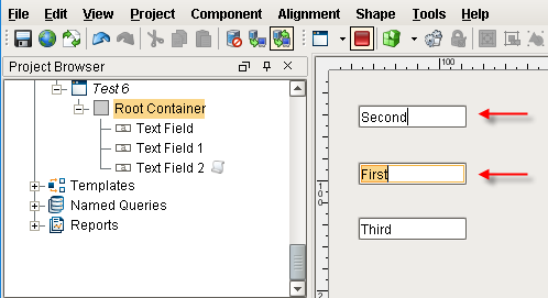

However, calling requestFocusInWindow() may cause some irregular behavior as shown below. Notice below how the "first" and "second" Text Fields both have a text cursor in the component, but only the "second" text field has focus. This is because requestFocusInWindow() is being called on the focusLost event, which runs when one of our components loses focus. This means that while focus is being pulled to one component (the "second" Text Field), our script changes focus again to a different component.

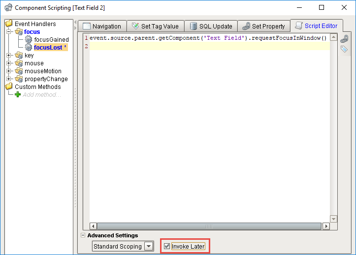

To resolve the focus manipulation issue mentioned above, we can take one of two approaches:
Script Editor Advanced Settings​
The simplest approach would be to use the Invoke Later option under Advanced Settings in the Script Editor.
