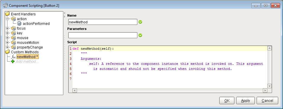

Custom Methods​
Custom Methods function much like Project or Shared Scripts in that you write a script and call it from somewhere else. However, Custom Methods are written on a component instead of a separate scripting section, and are also automatically passed the value of self, just like an Extension Function. The self object provides the script with easy access to everything within the window. In addition to self, Parameters can be added that you can use to pass in other objects into your Custom Method.
Custom Methods can then be called from the same component or from other components. Custom Methods are called just like any other method on a component: .methodName(). So if I had a custom method on a text field, and I wanted to call it from the actionPerformed event on a button in the same container, I would use:
