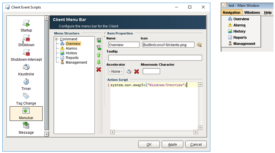

You can setup a special menu within the Menubar that allows you to navigate throughout the project using the scripting functions. They can be simple, like swapping to a window, or be more complex in how they navigate around the project. The benefit of using the Menubar for navigation is that it keeps navigation tucked away instead of using up valuable screen space. You can find the screen below in the Client Event Scripts space.
