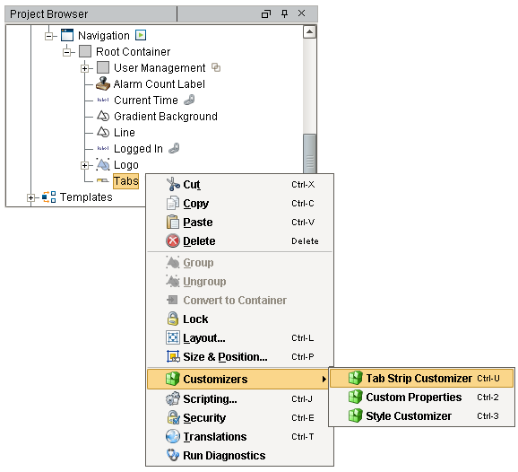

  1. Go to the Project Browser, expand the Navigation window, to see the Tabs component inside of it.
  2. Right-click on the tab component, choose Customizers > Tab Strip Customizer.

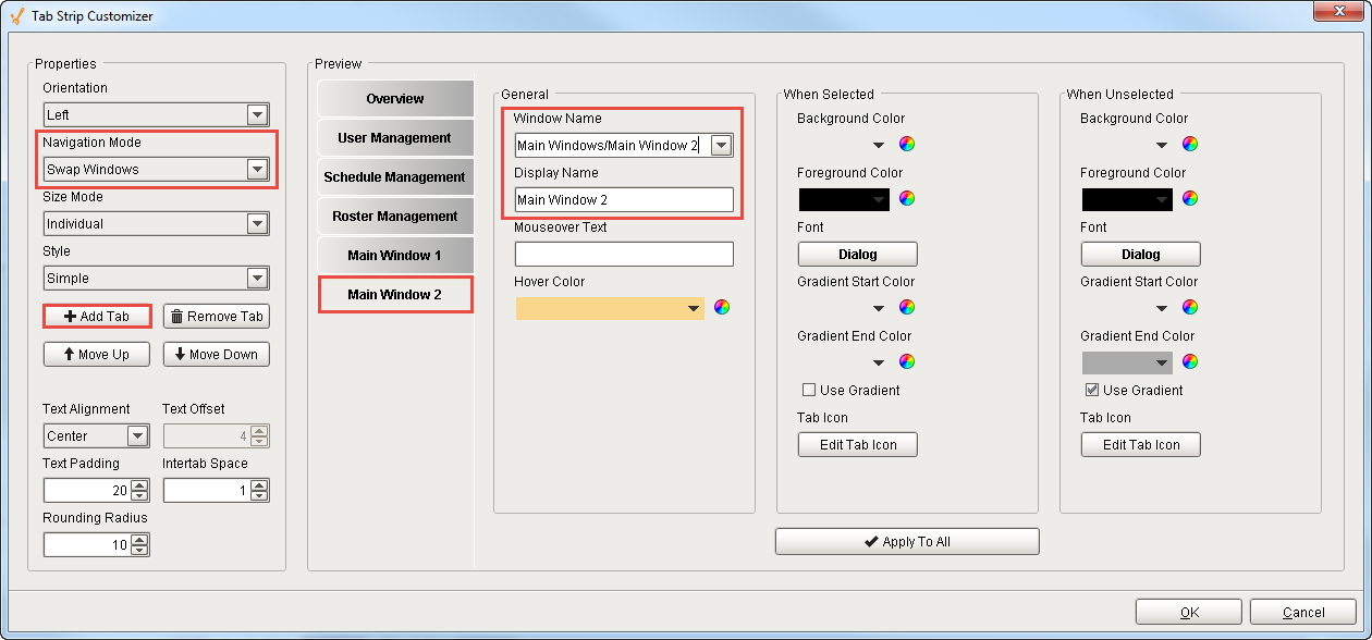

  3. In the Tab Strip Customizer you can specify which window to open with each tab. Notice the Tabs component has a Navigation Mode property which is set to Swap Windows as shown in the screenshot below.
  4. To create a new tab, click Add Tab (this example creates a Main Window 2 tab). If you have a tab already selected, clicking the Add Tab button creates a duplicate of the selected tab.
    Main Windows already created
    This step assumes you already have your main windows created in your Project Browser.
    1. Under Window Name dropdown list, select the window you want to open. Note it is the full path from the window and not just the name (i.e., Main Windows/Main Window 2).
    2. Enter the Display Name for your new tab (i.e., Main Window 2).
    3. With the Move Up, Move Down, and Remove Tab buttons you can move tabs up and down on the tab strip, and remove a tab if it is no longer required.
    4. When you're finished, press OK.

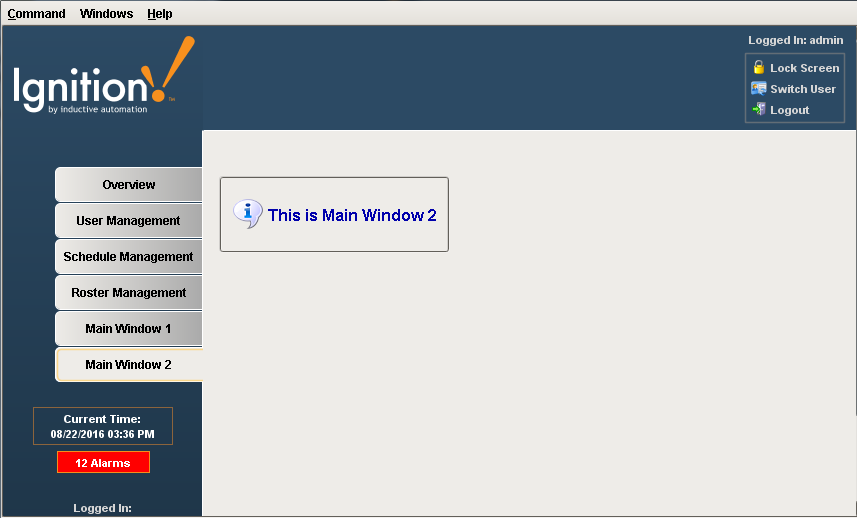

  5. Save and Publish your project.
  6. Open your project in the Client, and see that each tab navigates to a different window. You can also test your window navigation in the Designer, but only one window can be open at a time. To do so, use the Preview Mode to switch between windows.
  7. As you can see, the Tab Strip works by clicking on a tab to swap one main window for another. If one of the windows happens to be a Popup Window, it will be treated as a Main Window by the Swap Windows mode.
