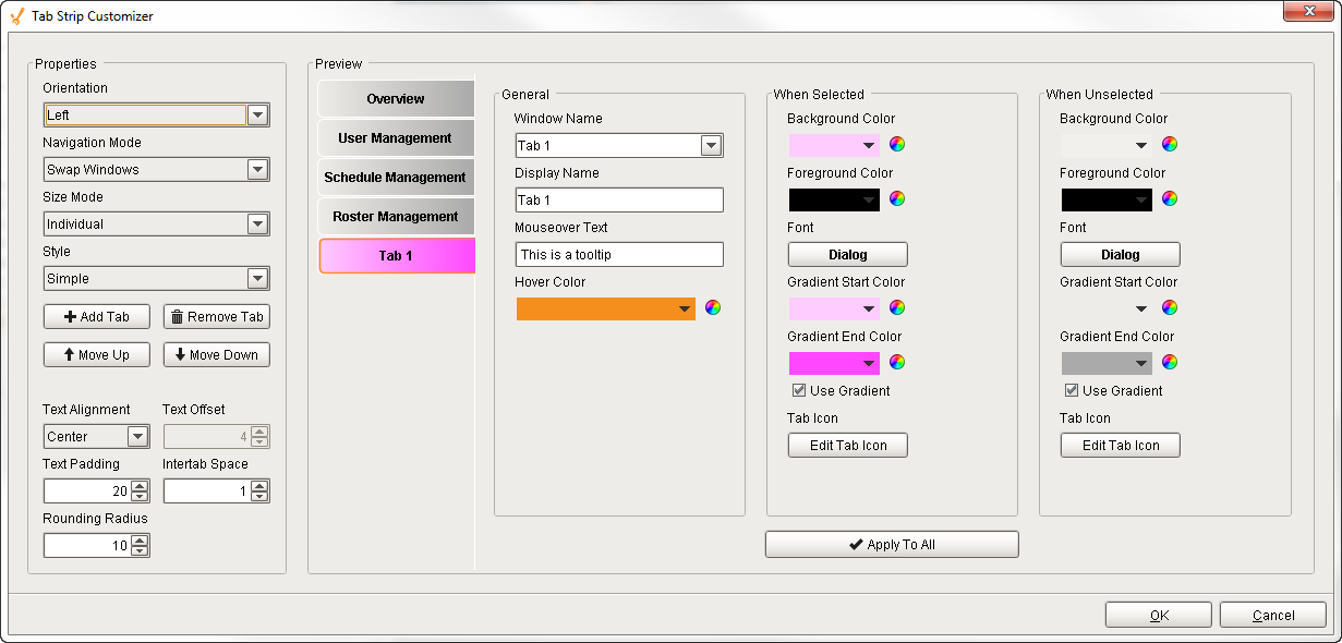

The Tab Strip Customizer has it's own set of properties that you can set and modify which dictate how the Tab Strip component looks and behaves whether or not it is used for window navigation. The tabs and the styles are stored in the Tab Data dataset property.
When customizing the Tab Strip, keep in mind how you are using the component when setting your properties. Some Tab Strip properties may behave a little differently based on style, tab orientation, or text alignment. It's a good idea to use the preview window to verify the style you configured is the style you want.
PropertiesDescription
OrientationOrientation of the Tab Strip on a window: Top, Left, Bottom and Right. For example, use the Top orientation to place the Tab Strip component at the top of your window.
Navigation ModeTwo Navigation modes:
  • Swap Windows - the Tab Strip automatically calls system.nav.swapTo() to perform a window swap from the current window to another window when a tab is pressed. Swap Windows is the default mode.
  • Disabled - the Tab Strip only sets the Selected Tab property when pressed. You can set the component's behavior using property bindings or by responding to the propertyChange scripting event.
Size ModeTwo Size modes:
  • Individual - all the tabs are the same size.
  • Automatic - all the tabs are sized to fit the text.
StyleThree style options to change the appearance of the individual tabs: Simple, Fancy, and Folder.
Add TabAdds a new tab next to the selected tab.
Remove TabRemoves a selected tab.
Move Up / Move DownDepends on the current Orientation selection. Moves the selected tab Up or Down in the tab strip when using the Left or Right orientation.
Move Left / Move RightDepends on the current Orientation selection. Moves the selected tab either Left or Right in the tab strip when using the Top / Bottom orientation.
Text AlignmentInserts text in the Center, Left, or Right inside a tab.
Text OffsetSpecifies how many pixels to move text to the left or right within a tab.
Text PaddingSpecifies the number of pixels around the text in the tab.
Intertab SpaceSpecifies the number of pixels between tabs.
Rounding RadiusSpecifies the number of pixels to round the corners of the tab depending on the tab orientation.
General Section​
Window NamePathname of the window location
Display nameThe name to display on the tab.
Mouseover TextThe text to display in the tooltip which pops up when mousing over a tab.
Hover ColorThe color to display in the tootip which pops up when mousing over a tab.
When Selected/When Unselected​
Background ColorThe background color of the tab.
Foreground ColorThe foreground color is the color of the text.
FontSelect the font type, font size, and style.
Gradient Start ColorSelect a start color to begin the gradient. Gradients are not valid for the Fancy style, and are shown as being grayed out. Select Simple or Folder style to use the gradient feature.
Gradient End ColorSelect an end color to end the gradient. Gradients are not valid for the Fancy style, and are shown as being grayed out. Select Simple or Folder style to use the gradient feature.
Use GradientSelect Use Gradient checkboxes to use gradient features. Uncheck the Use Gradient checkboxes to disable the gradient feature.
Tab IconSelect an image from the Image Browser to insert on a tab.
Apply to AllThe button applies all of the currently shown settings (except Window Name and Display Name) to all of the tabs. Note: this does not save your changes.

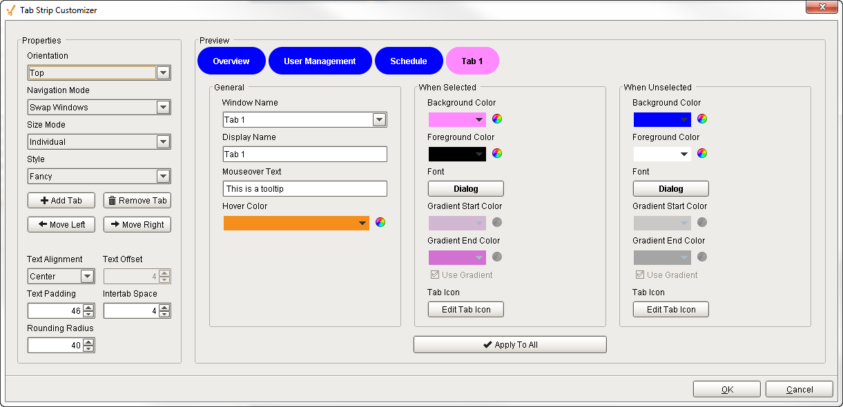

Example​
Horizontal Tabs​
StyleFancy
OrientationTop
Tab DataDataset customized with the Tab Strip Customizer. Notice how the Gradient features are grayed out with the Fancy style.
