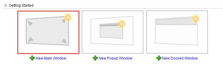

Creating windows is as easy. There are three ways to create a new window and each way is shown below.
  1. When you open your project, the three window types are displayed. Click on the New Main Window, or any window type you want to create.
    Working with Vision Windows - Create a Window Step 1

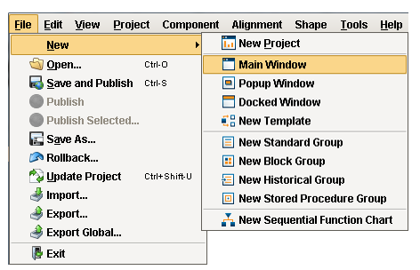

  2. Go to your menubar at the top of the Designer and select File > New > Main Window or any other of the window types you want to create.
    Working with Vision Windows - Create a Window Step 2

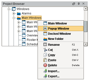

  3. In the Project Browser, click Main Windows and select any of the window types. This example creates a Popup Window.
    Working with Vision Windows - Create a Window Step 3
That's it! You now have a new window. To see it in action, all you have to do is add components, drawing tools, and tags to your window. Once your components and Tags are added, save and publish your project. Open your project in the client to see how your components look in the window.

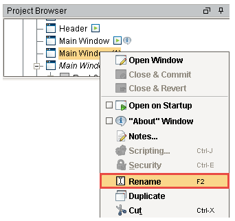

In the Project Browser, right-click on the window and choose Rename or press F2. Enter a new name for the window and press <CR&gt;. The window name must be unique in its folder. A descriptive window names is always recommended.
Working with Vision Windows - Naming and Renaming a Window

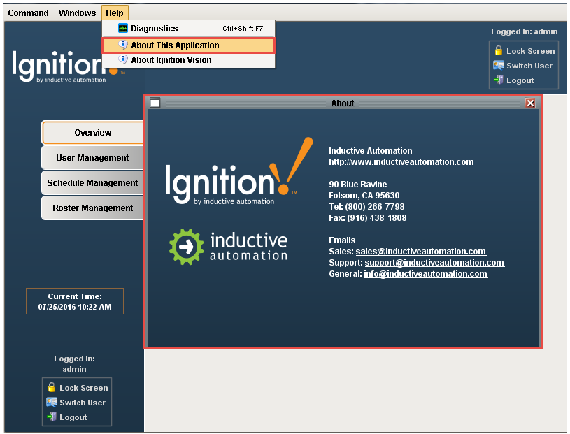

About Window​
About Window - DesignerAbout Window - Vision Client
In the Project Browser, expand the Windows folder. Right click on About and select the check box next to "About" Window to make the window accessible from the Help > About This Application menu in the Client.
Working with Vision Windows - About Window Designer
In this Project Template example, the About Window provides some contact information for Inductive Automation. Working with Vision Windows - About Window Vision Client

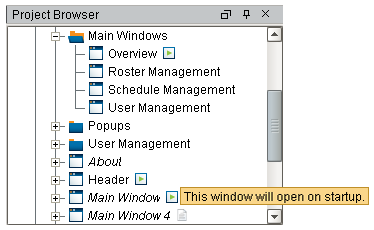

Open on Startup​
Open on Startup - Context MenuOpen on Startup - Green Arrow
By default, most projects open a static set of windows automatically when the client is opened. You can select which windows to open on startup by going to the Designer, right click on a window, and choose Open on Startup.
Working with Vision Windows - Open on Startup Context Menu
All windows that Open on Startup have a little box with a green right arrow next to the window name. Working with Vision Windows - Open on Startup Green Arrow

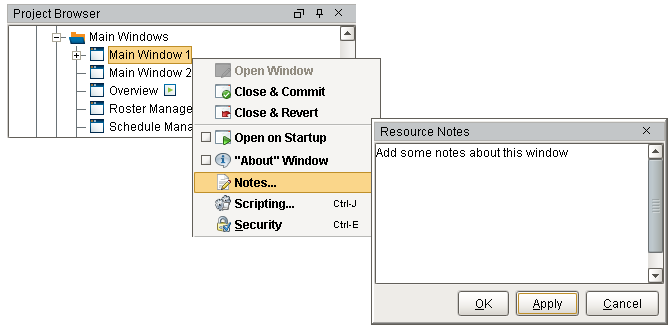

Adding Notes on Windows​
Through the right-click menu on a window in the Project Browser, you can access the window's Notes. This free-form text field is provided to let you document the purpose of the window and/or any technical information about how the window works.
Working with Vision Windows - Adding Notes on Windows

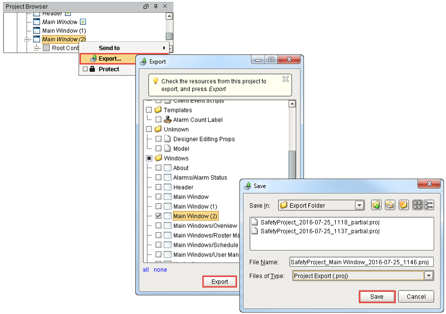

Exporting and Importing Windows​
In the Designer, you can export and import windows from one project to another project using external files. You can even use the Export function to do a backup of your window(s).
Exporting a Window​
  1. In the Project Browser, select a window folder, right click, and select Export. The Export wizard will open.
  2. Check the windows and the resources that you would like to export.
  3. Click Export and choose a folder path for your backup file. Ignition will provide a default filename with the file extension ".proj".
Working with Vision Windows - Exporting a Window

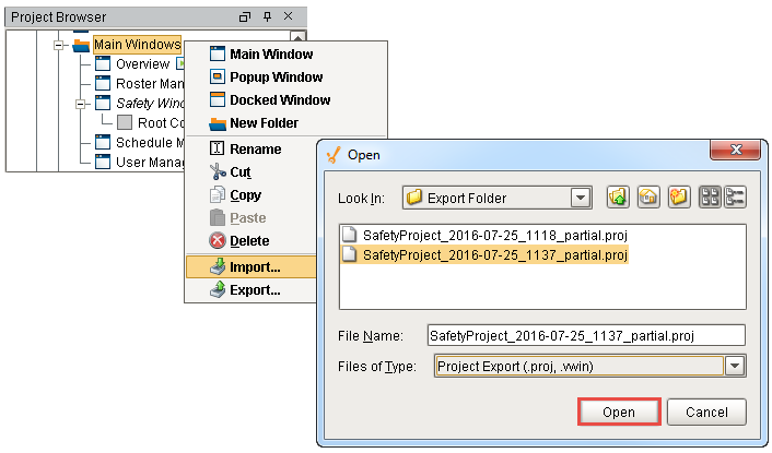

Importing a Window​
Importing windows is just as easy as exporting. You can replace or restore a window using the exported *.proj file.
  1. In the Project Browser, select the folder location where you want to add your window. Right click and select Import.
  2. Select the *.proj file from the folder location where you saved your export, and press Open. Ignition will create the folder path and window if it doesn't already exist, or replace the existing window. That's it!
Working with Vision Windows - Importing a Window
Default export/import file type ".proj, .vwin"
In previous versions of Ignition, the export file type for windows was .vwin instead of .proj. Because Ignition is backwards compatible, it will accept both the current .proj and older .vwin file types when importing.
