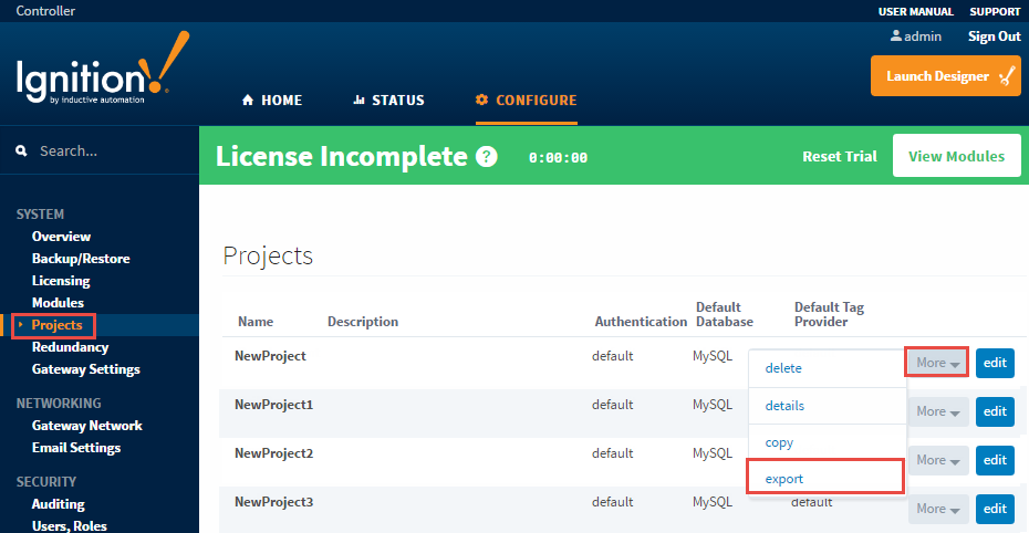

  1. Go to the Configure section of the Gateway webpage.
  2. Select System > Projects.
    The Projects page is displayed and you can see your existing projects.
  3. To the right of project name, click the More button and select export. This exports your project as a .proj backup file. By default, the .proj backup file is saved in your web browser's default Downloads folder. This export of the project can be uploaded to any other instance of Ignition that is running the same version or later.

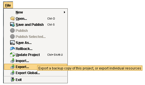

  1. In Designer, select File > Export.

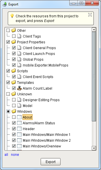

  1. An Export window will open. Check the resources from your project that you want to export, and click Export.

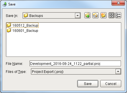

  1. If you are exporting selected resources, Ignition will enter 'partial' in the filename.
  2. Click Save.
