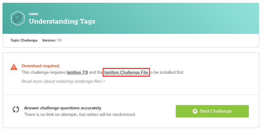

When a challenge requires the challenge file, you'll find a link to download the challenge file. For example: https://inductiveuniversity.com/challenge/understanding-tags
Clicking on Ignition Challenge File will download the challenge file.
The challenge file only needs to be installed once. All challenges that require the challenge file make use of the same file.

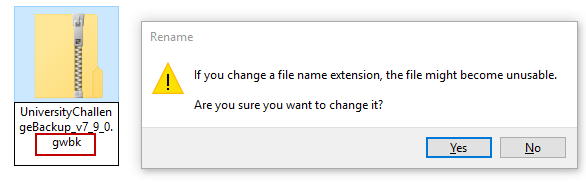

I Downloaded a ZIP File​
Sometimes, you may download the Challenge File and it will download as a zip file with the name UniversityChallengeBackup_vX_X_X.zip. This is NOT a zip file that needs to be unzipped. Microsoft Edge and Internet Explorer don't recognize the ".gwbk" extension, but can detect that the file is compressed, so they change the file extension to ".zip" in an attempt to help you. If possible, we recommend using an alternate browser to download these files such as Google Chrome or Mozilla Firefox.
If using a different browser is not an option, then the file simply needs to have the extension changed back to gwbk after downloading. To do this, go to change the filename, but instead erase the extension zip and enter in gwbk. It will then confirm that you want to change it. Once it has been changed, it can be restored to an Ignition Gateway like any other Gateway Backup.
