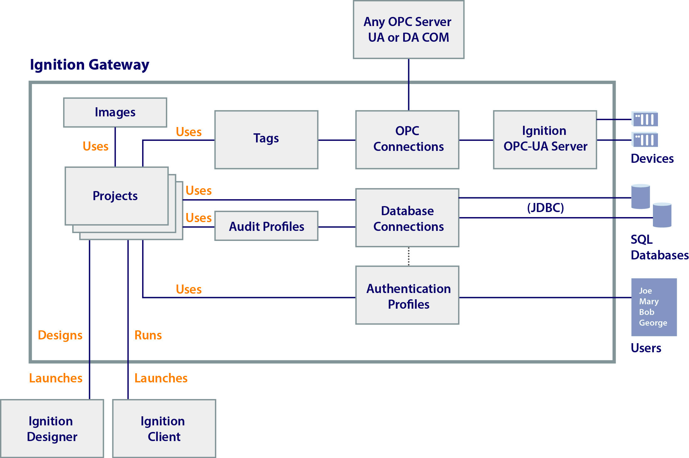

Gateway's Architecture​
The Gateway’s architecture contains many parts, each one letting you perform a specific task. The Gateway parts are as follows:
  • System Management
  • Project and Module Management
  • Security and Auditing Settings
  • Database Connectivity
  • Alarming and Notification Settings
  • Tags Provider Settings
  • OPC Connectivity
  • Mobile Settings
  • Enterprise Administration Settings
  • Projects - the most important part!
The following figure shows the different parts of the Gateway and how projects work within the Gateway. Note the parts that are outside the Ignition Gateway box, non-Ignition OPC servers, databases, devices, etc are all separate from Ignition but can be connected.
