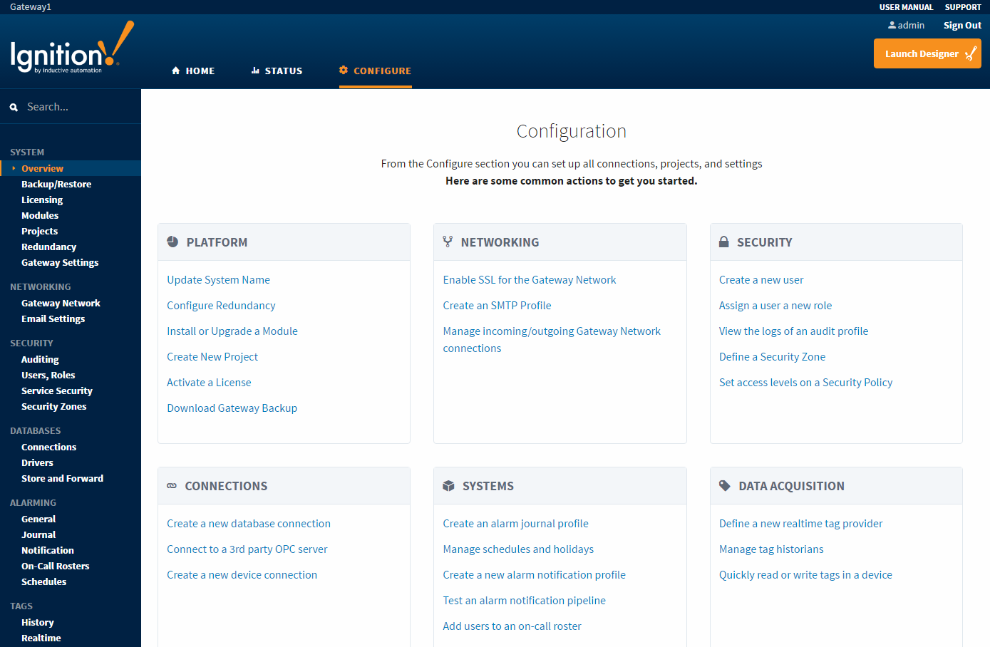

The Configure tab provides access to configuration options for gateway settings. Here we can adjust the settings for alarming, add users and roles, or even setup a gateway backup to be taken automatically at specific times. This is where most of the settings that affect the whole Gateway will be setup.
System​
The System section is a sort of catch all section that can do a lot of different things. The first window is the Overview page, which is what will first show up when navigating to the Configure tab. The Overview page only has links to other sections of the Configure tab, but it is useful if you aren't exactly sure where the setting you are looking for is located, because the Overview page lists the most common configuration changes.
