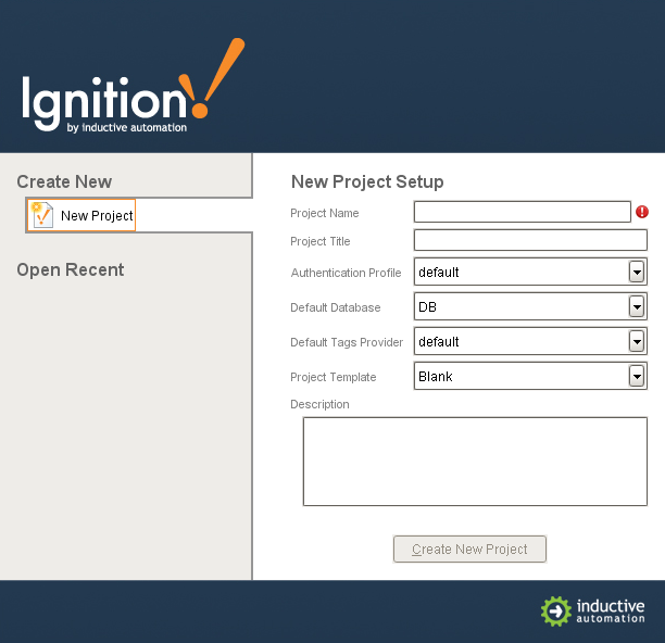

New Project Setup
To create a new project, click on New Project and define following information:
  • Project Name: A unique name for the project in the system. The name can only consist of alphanumeric characters and the '_' character. Spaces and other special characters are not supported.
note
It is not advisable to change the name after it's been created. Instead, change the Project Title if you want to change how the project appears later.
  • Project Title: This is the name that will be displayed on the launch page of the Gateway and in the runtime Client. There are no restrictions to special characters or spaces.
  • Authentication Profile: The profile to use for granting access to the project. For more information or to add users, see Security.
  • Default Database: Any queries to the database will use this default database connection unless explicitly specified otherwise.
  • Default Tags Provider: The primary Tag provider for the project. Most installations will likely only have one provider, but in situations where there are more than one, this is the provider that will be used unless explicitly specified otherwise.
  • Project Template: Gives you the option to choose a quick start template for your project. Most people start with a simple 1-tier navigation option. Click the dropdown to see all the available options.

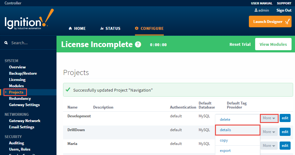

Once you have a project or two (or twenty) setup, you might want to change some of the base settings. You can manage the projects from the Configure section of Gateway by going to System > Projects. The Project window is displayed showing all your projects. To the right of the project name, click the More button, and here you can edit, delete, view details, copy, or export your project.

To view the project details, go to the Configure section of the Gateway webpage, and select System > Projects. Find your project, press the More button to the right of the project name, and select details. The details link on the Project window, takes you to the Project details for <Project Name> page where you can choose to view the Published or Staging version of the project, and view the project's edit history.

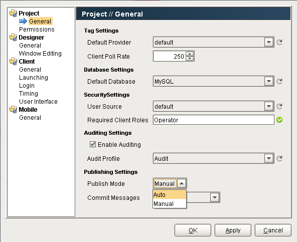

In the Designer, choose the Project > Properties menu item, then go to the Project > General page to set the Publish Mode. By default, a new project is configured to be in Auto publish mode, however you can change it to Manual publish mode.
  • In the default Auto mode, when you want to save your project, Designer lets you do a File > Save and Publish, which means both the Staging and the Published versions will be the same and identical.
  • In Manual mode, when you want to save your project, Designer lets you do both a File > Save, or a File > Publish. File > Save updates the Staging version, and File > Publish updates the Published version.
