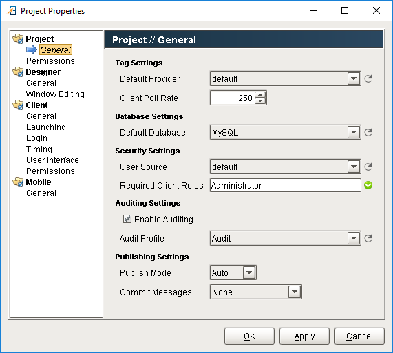

Project - General Properties​
Tag Settings​
PropertyDescription
Default ProviderThe Tag provider chosen here will act as the project's default tag provider. To use the default provider, simply omit the source section of a Tag path, or leave it blank, for example: Path/To/MyTag or []Path/To/MyTag.
See also: Keeping Tags Organized
Client Poll RateThe Client poll rate (in milliseconds) is the rate at which a Vision Client or Ignition Designer polls the Gateway for updates to its subscribed Tags.
Database Settings​
PropertyDescription
Default DatabaseThis is the default database connection to use for this project. To use the default database connection, use the special <default> connection, or in scripting, the empty-string connection "".
Security Settings​
PropertyDescription
User SourceChoose the User Source that governs this project's security: specifically, which group of users (User Sources) is allowed to log into the client. The User Sources are all defined in Gateway's Configure section under the Security > User, Roles page.
Required Client RolesThis property is for Client logins, and determines what role(s) a user must have before they can log into the Client. You can optionally specify a list of roles that are required for a user to log into this project. Use commas to separate the roles. Users must have at least one of the roles in order to log in. If no roles are specified, the user only needs to correctly authenticate with the User Source in order to log in. To define the roles, go to the Gateway's Configure section under the Security > User, Roles page, click the manage users link, and then go to the Roles tab.
See also: Security
Audit Settings​
PropertyDescription
Enable AuditingIf auditing is enabled, audit events that relate to this project will be stored in the chosen audit profile.
Audit ProfileThe audit profile stores the audit events when auditing is enabled.
Publishing Settings​
PropertyDescription
Publish ModeHere you specify how project publishing is handled. By default, the project is set to Auto, which means both the staging and published version of the project will always be synchronized.
  • Manual: In this mode, you can do a File > Save to update the Staging version, and then a File > Publish to update the Published version.
  • Auto: In this mode, the only command available for saving your project is File > Save and Publish which saves and then publishes, so the two Staging and Published versions are always the same.
See also: Published vs Staging.
Commit MessagesYou can specify whether or not commit messages are required, and if so, under what conditions. You can specify the condition as: None, OnPublish, or OnSaveandPublish.

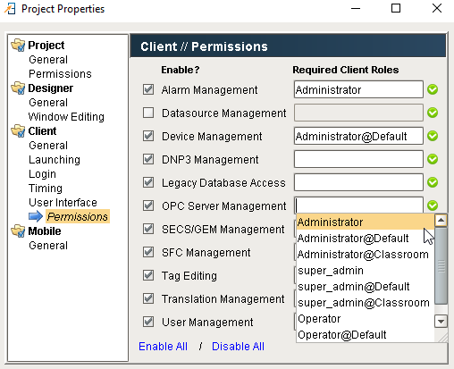

Client - Permissions​
New in 7.9.4
Inductive University
Client Permissions
Watch the video
These properties allow you to limit the Client's ability to perform certain tasks. The tasks are grouped by category. Access can be configured statically for all users, or require specific roles.
