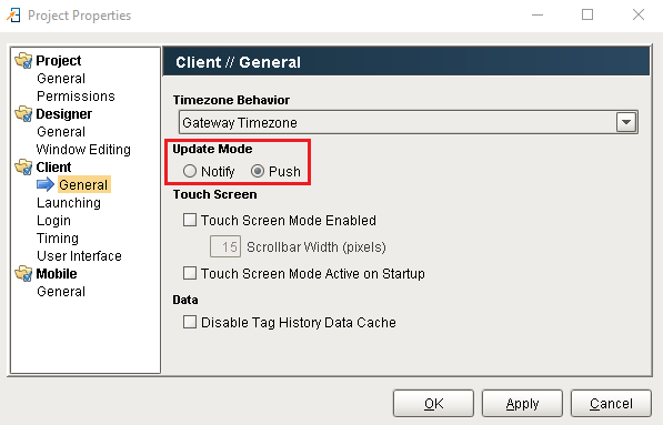

To Set the Client Update Modes​
  1. In the Designer, from Project Browser, double-click on Project > Properties, or from the top menus go to Project > Properties. The Project Properties window is displayed.
  2. Go to Client > General page, set either Notify or Push as your client update mode.
    Set Client Update Mode Step 2
