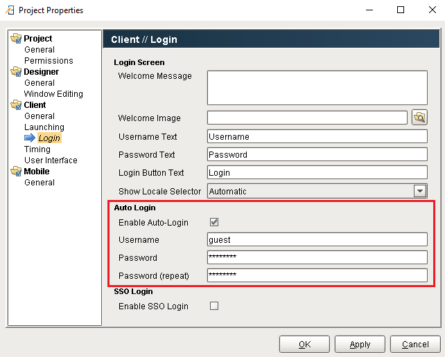

Client Auto Login​
Clients can log in automatically when launched, once you specify the Auto Login settings in the Client/Login section of the Project Properties window. This is typically used in situations where the client should login with a low access user, such as a 'guest' account.
To Set the Clients to Automatically Login​
Inductive University
Setting up Client Auto Login
Watch the video
  1. In the Designer, go to Project > Properties. The Project Properties window is displayed.
  2. Go to the Client > Login page, and select the Enable Auto-Login box.
  3. Type any Username and Password you want. For example, you can type:
    • Username: guest
    • Password: password
  4. Click OK.
    set up client auto login step 4
  5. Select the File > Save and Publish to save your changes to the Gateway and publish your project.
    set up client auto login step 5

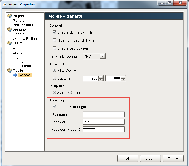

Mobile Auto Login​
Mobile Clients can log in automatically when launched once you specify the Auto Login settings in the Mobile/General section of the Project Properties window. This behaves the same as the above auto-login, but requires separate credentials for Mobile. This option will only be available when the Mobile Module is installed.
To Set the Mobile Clients to Automatically Login​
Setting up Mobile Auto Login
Watch the video
  2. Go to the Mobile > General page, and select the Enable Auto-Login box.
    • Username: guest
  4. Click OK and select File > Save and Publish to save your changes to the Gateway and publish your project.
    set up mobile auto login step 4
  5. Go to the Gateway Home page, find the Mobile Launch section, and click on the link. This launches the Client in your mobile device and automatically logs you in the web browser.
