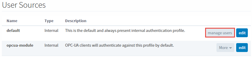

  1. On the Gateway webpage, go to the Configure section, and choose Security > Users, Roles from the menu on the left. The User Sources page is displayed.
  2. Click on the manage users link for the User Source you want to manage.

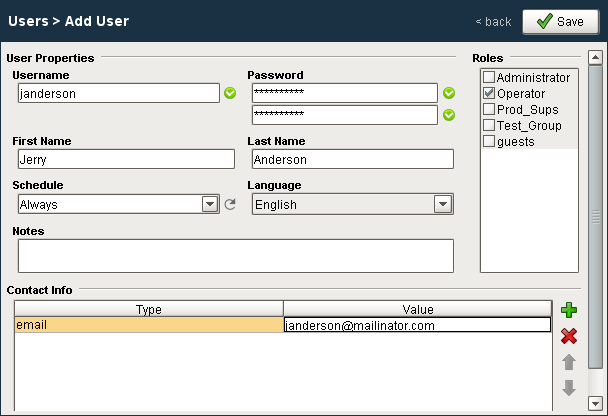

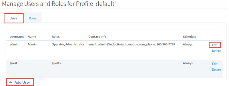

  3. Click the Edit link for the User you want to edit, or click the blue Add User link to add a new user. (When adding a new user, you can also add their roles at the same time).
  1. If you're creating a new user, the Add User window will open. Enter the user's properties including the roles you want this user to have. If no roles have been created, then follow the instructions in the Creating a Role section from above. If your user already exists and you simply want to modify their roles, the Edit User window will open. (The Edit User window and the Add User window look identical).
To assign a role, there is a Roles property with a list of roles that have already been created. Select the role(s) that you want this user to have. (It's not required for a user to have a role, but be aware that they might not have access to an area of the project that requires them to have a role).

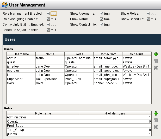

Ignition has a special User Management component that allows you to add, modify, and delete users and roles (and more) inside the Designer and the Client. This is extremely simple to set up and use.
Using the User Management Component in the Designer and Client​
  1. In Designer, drag a User Management component to your window.
  2. If you already have some users and roles setup using the Gateway interface, you will see those users and roles in the User Management component. If you don't have any users or roles setup, you can create them here. Use the icons on the right side to add, edit, or delete a user or role.
    The image below shows a header and some checkboxes because we are looking at the User Management page from one of the Project Templates.

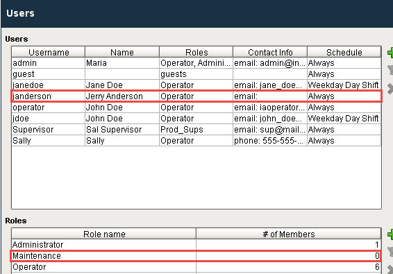

  1. Now you can see the user and role that were just added in the User Management window.
