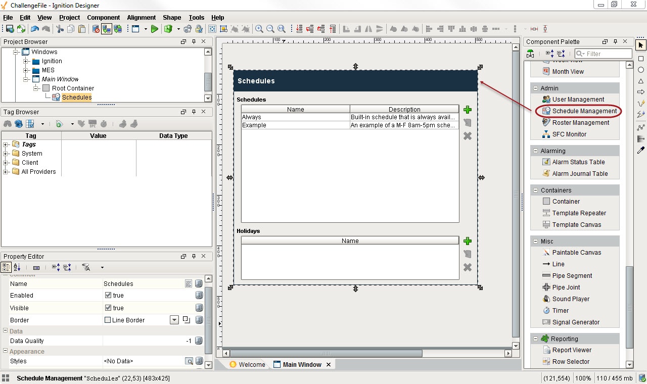

There are a few ways to manage user schedules from the Client. The first is to use the Schedule Management component on a window. This component allows you to quickly and easily manage the schedules from the Client.
Schedule Management Component in Designer
