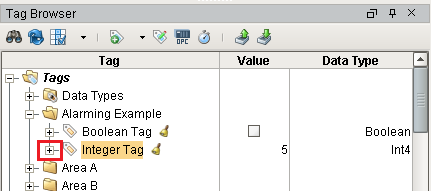

  3. Once the Tag has been created, click on the '+' icon next to the Tag in the Tag browser.
    Alarm Status Example Step 3

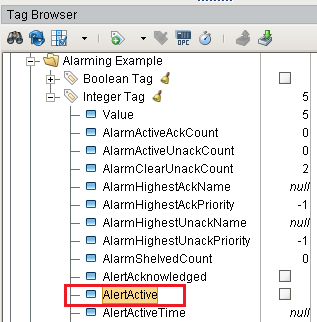

    This will expand the Tag and show all of the Tag properties, including the AlertActive property.
    Alarm Status Example Step 3b

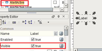

  4. With the Label component selected, drag and drop the AlertActive property from the Tag to the Visible property on the Text Field component. This will create a binding directly to that Tag property.
    Alarm Status Example Step 4
  5. You'll find that the component will appear when an alarm is active, and become hidden once all alarms on the Tag are cleared.

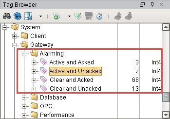

Ignition provides a set of System Tags to view information about the Ignition server which includes four Tags that count the number of alarms in each state. A quick way to see if any alarms are currently active and get an alarm count is to add a label on the Navigation window. The four system alarm states are:
  • Active and Unacknowledged
  • Active and Acknowledged
  • Clear and Acknowledged
  • Clear and Unacknowledged
In the Tag Browser of the Designer (default position in middle-left side of the Designer), scroll down to the System > Gateway > Alarming folder. You can see all 4 of the system Tags that Ignition provides. You can also see how many alarms are currently Active and Acked, Active and Unacked, Clear and Acked, and Clear and Unacked.
Alarm Status Tag Browser
These system Tags can easily be used to visualize all alarms in the system.
