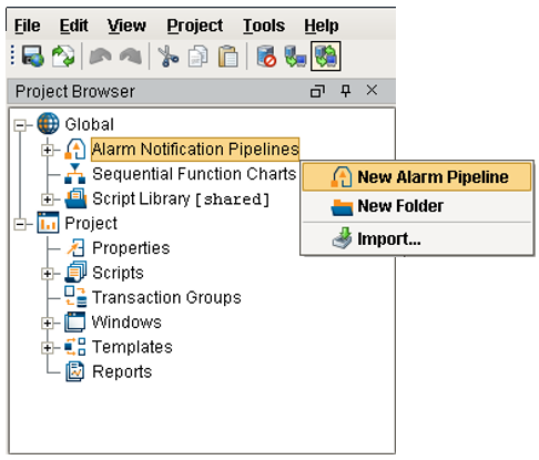

Creating Pipelines​
Before you create a pipeline in the Designer, you need to configure at least one alarm notification profile and at least one roster in the Gateway. Then in the Designer, you create the Pipelines under the Global node of the Project Browser. Alarm Pipelines, unlike other types of resources such as windows and Transaction Groups, are global resources, and are not part of a project. A defined pipeline runs in the Gateway, and you can see the same pipelines available to edit regardless of the project that is currently open. If you already have a Remote Gateway configured to support alarm notifications, you can expand the already significant power of alarm pipelines by also exposing alarm pipelines that are configured on the Remote Ignition Gateway system.
Creating Pipelines Project Browser

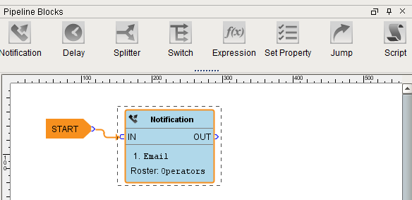

When you create a new pipeline, or select one to edit, the Designer Switches to the Pipeline Workspace. The workspace is basically a blank canvas, on which you arrange and connect together various Pipeline Blocks. Each pipeline block has an input, and potentially has outputs. Using the mouse, you can draw connectors between the output of one block into the input of another. The START block, which you will see when you first create the pipeline, cannot be deleted and is the only fixed part of the workspace. It represents the entry point for alarm events into the pipeline, and is treated like an output block.
Notification Pipeline Builder
Multiple outputs can be connected to a single input. Also, it is perfectly acceptable to write the output of a downstream block back to the input of an earlier block, creating a loop. Of course, some care should be taken when doing this, as it can easily result in unexpected behavior, like sending out emails indefinitely for one event!

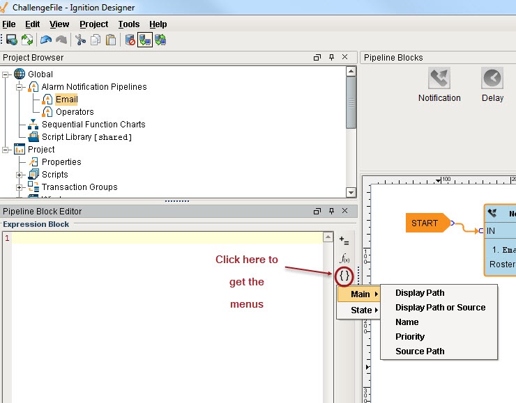

Commonly Used Properties​
The following screenshot shows how you can access the two commonly used sets of properties in the Expression Block: the Main and State properties.
Notification Pipeline Properties
The Main properties are information about the alarm that are independent of whether the alarm is currently active, clear, or acknowledged. They are:
  • Display Path
  • Display Path or Source
  • Name
  • Priority
  • Source Path
The State properties are information about the alarm that change while the alarm is changing, and some of them even change each time the alarm goes from active to clear to ack (acknowledged).
  • Ack Time
  • Ack'ed By
  • Ack'ed By (Name)
  • Acked?
  • Active Time
  • Active?
  • Clear Time
  • Clear?
  • Current State
  • Event State
  • Event Time
  • Event Value
  • Is Shelved?
