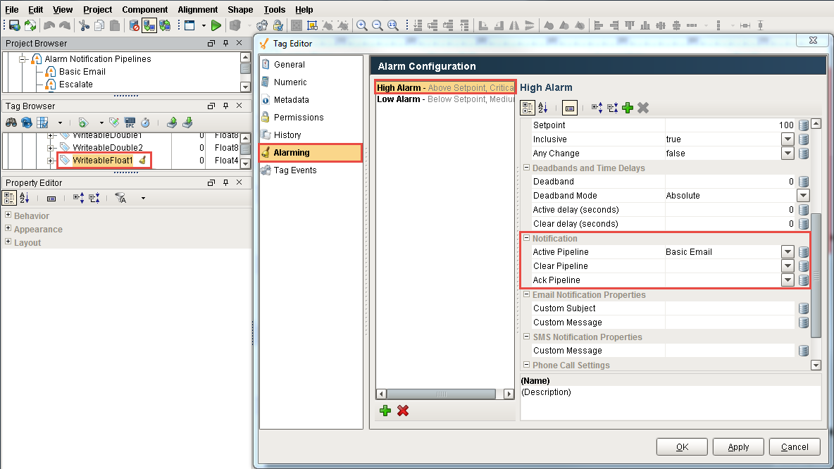

  1. Double-click on a Tag that already has an alarm configured (i.e., WritableFloat1). The Tag Editor is displayed and you can access its properties.
  2. Go to the Alarming tab.
  3. Select an Alarm. If you don't have an alarm configured, create one. To learn more about creating alarms, go to Configuring Alarms.
  4. Under the Notification section, select the desired alarm pipeline from the drop-down for any of the alarm status states. Typically, operators want to know when an alarm goes active. This example uses the Basic Email pipeline when the alarm status becomes Active.
  5. Click OK.
    Add Pipelines to Tags
Now, every time the High Alarm Tag goes Active, it will use the logic in the Basic Email pipeline to notify the operators.
