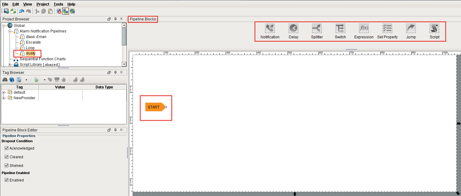

Start Block​
When you create a new pipeline, you always get a Start Block placed in your Pipeline Workspace. You cannot delete the Start Block because it represents the entry point for alarm events into the pipeline.
Alarm Pipeline: Start Block

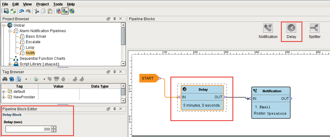

Delay Block​
The Delay Block simply blocks alarm events for a specified period of time before moving them to the next block. They are generally used to wait for the dropout condition to become satisfied for an alarm.
For example, a 5 minute delay might be used to give operators viewing control screens a chance to acknowledge, and only send notifications if they haven't (the "active delay" deadband on the alarm could be used to delay the alarm as well, but in that case it wouldn't actually be active, and therefore not displayed, for the delay time).
Delays are often also used to control flow in a pipeline. For example, in an "escalation" scenario, a notification block might be used to send emails. Since emails are sent instantly, and acknowledgment occurs "asynchronously" (the user must see the email and click the link or log into the system), a delay block could be used to provide time for the user to acknowledge, before moving on to a voice notification block. There is no practical limit to how long a delay can be. The delay is calculated independently for each event entering the block, meaning that each event will be held for the specified time.
Click the Delay Block and a spinner will appear in the Pipeline Block Editor. You can specify the number of seconds to delay. In this example, if you enter '300' seconds, the alarm will wait 5 minutes before sending the notification to the Operators.
Alarm Pipeline: Delay Block

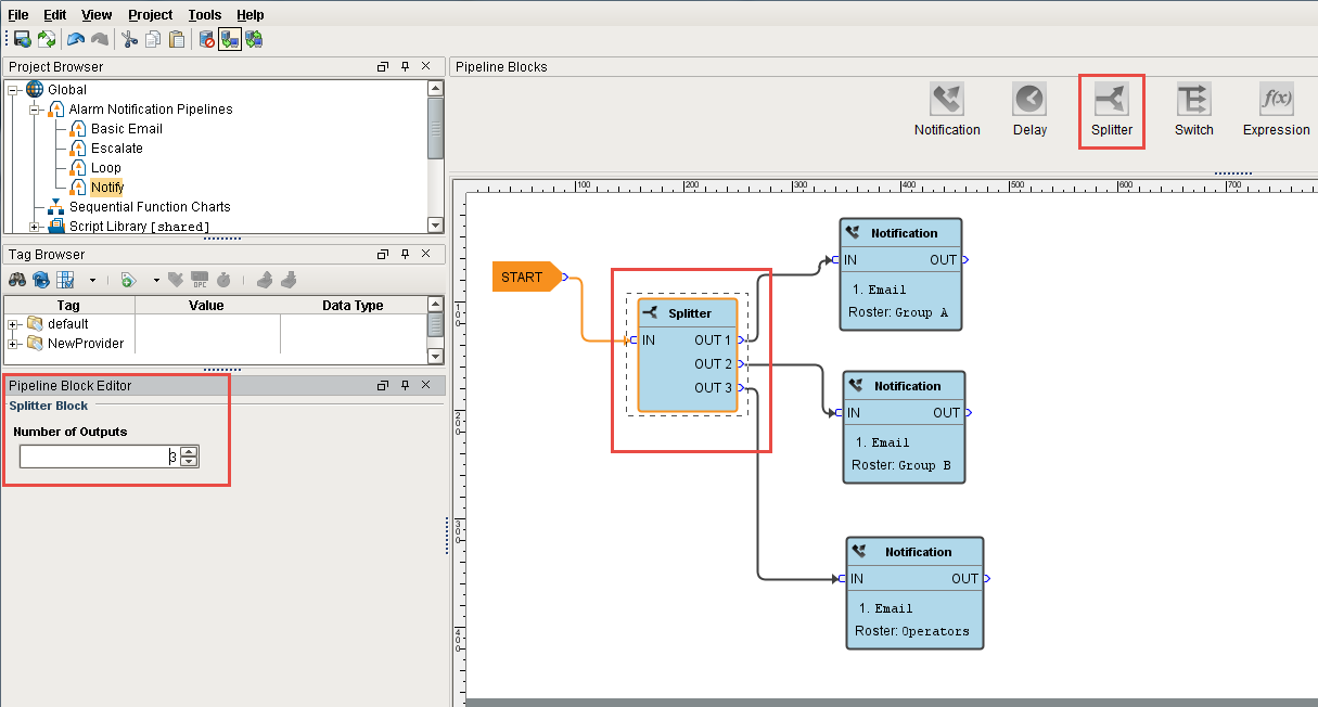

Splitter Block​
The Splitter Block simply forwards a single alarm event to multiple outputs at the same time. It creates a copy of the alarm event for each output and executes the alarm notifications along multiple paths in parallel. You can specify as many outputs as you want. If care is not taken, it is possible to end up with an exponential number of alarm event copies active in the pipelines at one time. Since each notification block operates on a specific on-call roster, Splitters are useful for delivering events to multiple notification blocks at once as shown in this example.
Alarm Pipeline: Splitter Block

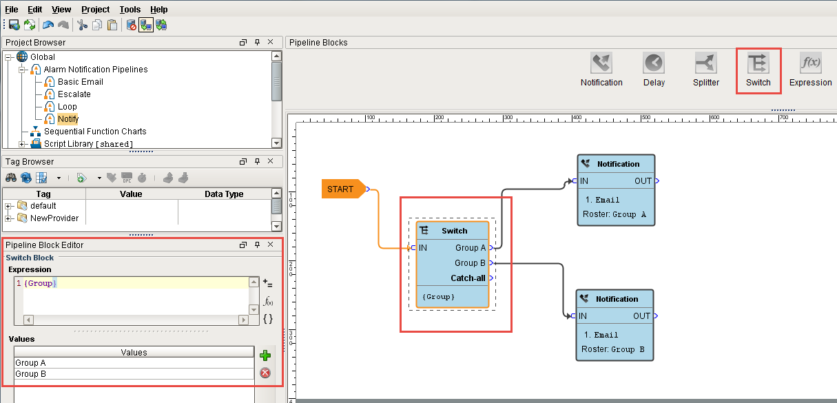

Switch Block​
The Switch Block evaluates a non-boolean expression and forwards it to an output based on a given result. It can be a number or string, and it will be looked up against a defined list of expected results. If a match is found, the alarm will follow that path, otherwise the "Catch-all" output is used.
You can create an expression and even use the alarm event's priority, associated data, value and more. The following example has associated data for the 'Group' that they belong to with 'Group A' and 'Group B' values. The Switch Block will evaluate the expression results against these defined values, and if a match is found, the alarm will follow that path. If neither of the values are met, the Catch-all output will be used.
This example demonstrates that a pipeline can send out an alarm to 2 different lists of people based on the 'Group'.
Alarm Pipeline: Switch Block

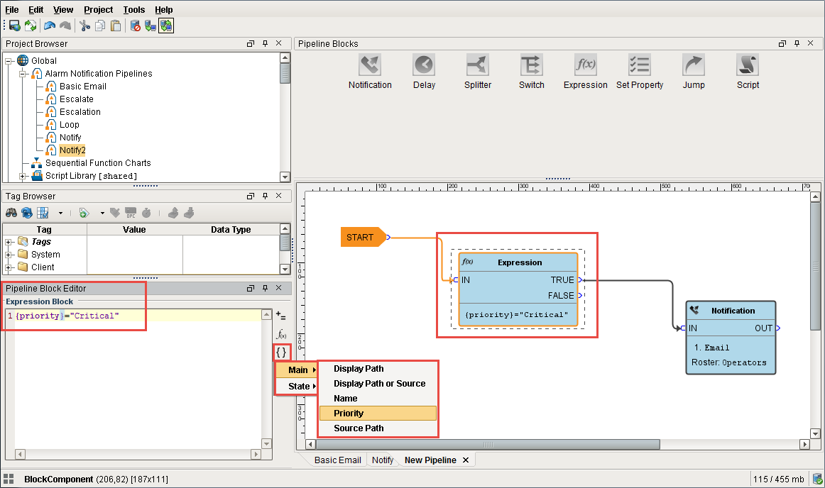

Expression Block​
The Expression Block contains an Expression which is evaluated against each alarm that enters it. The result is expected to be a boolean value, either 'True' or 'False' and forwards the alarm to the specific output. The Expression executed by the block is written in the same syntax as other Expressions in Ignition. However, in this context, it is possible to refer directly to properties of the alarm event that is being evaluated by using the standard {path} reference syntax. In addition, the following functions are available to quickly determine the state of the alarm.
Examples​
isActive() ​
This single function returns whether the current event is active or not. An Expression block like this could be used to then dispatch to an "active" pipeline, and a "clear" pipeline (both the active and clear pipeline settings on the alarm would be set to this dispatch pipeline). This kind of setup allows you to later modify how actives are handled vs. clears in one place, without having to modify many alarms.
toInt({priority})>2 && {displayPath} like "East Area"​
This block would forward all High and Critical alarms from the "east area" to the true path. The others would go to false, which may not actually be bound to another block, making this Expression block act like a filter.
isPropertyDefined("isEscalated")​
This Expression checks if a property exists on the event. The "isEscalated" property is not a system defined property. Instead, in this example, it might be set using a Set Property block before forwarding back to the start of the pipeline. The first time through, this Expression would fail, but the next time, it would pass, and the "escalated" behavior could be executed.
In the Pipeline Block Editor, you can select the Alarm Properties from any of the icons in the Expression Block. This example uses an expression ({priority}="Critical") to check to see if the priority is 'Critical,' and if so, the alarm notification will follow the 'True' path.  If it is not 'Critical', it will follow the 'False' path.  As you can see, the 'False' output is not configured.  You don't have to configure every output if you don't want to.
Alarm Pipeline: Expression Block

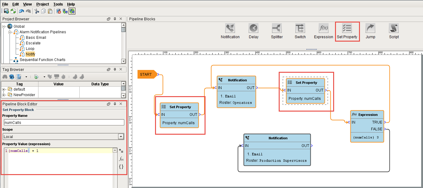

The Set Property Block allows you to define or redefine a property on the alarm event. The value is created from the Expression Block, which can refer to other properties or the same properties. Typically, the Set Property Block is used as a counter for the number of times the alarm has been looping or notifying people in your on-call roster. Settings modified in this way will only exist while the alarm is in the pipeline, they will not be stored to the journal, or show up in the status table.
Examples​
If you want to attempt notification up to three times before stopping, you could create a pipeline that looked like [Notification Block] > [Set Property] > [Expression], with the Expression looping back to the notification block (perhaps with a delay in between).
The Set Property block would look like:
Property Name: counter
Expression: coalesce({counter}, 0) + 1
Note that the first time the block is hit, the counter property will not exist, and therefore the value will be null. The coalesce function returns the first non-null value, allowing us to start with 0. Another way to write this might be:
if(isPropertyDefined("counter"), getProperty("counter"), 0)+1
The getProperty() function is functionally equivalent to simply referencing the property in brackets (that is, {counter}). The Expression block in this example would simply be: {counter}<3.
Here is another example where the operators are notified of an alarm event 3 times before being escalated to the Production Supervisors. Drag 2 Set Property Blocks to your pipeline workspace. Assign the first Set Property block to a Property Name 'numCalls' and a Property Value of '0'.  The second Property Block you need to increment the counter. Enter {numCalls} + 1 as shown in the Pipeline Property Editor. Each time the alarm goes through this block, the 'numCalls' variable increments by '1.' If no one acknowledges the alarm, it is sent to the Production Supervisor's on-call roster.
Alarm Pipeline: Set Property Block

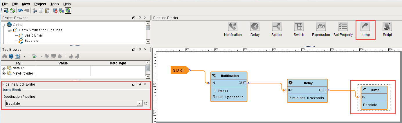

The Jump Block forwards an alarm event to a different pipeline. You can breakup a pipeline into several different pipelines and use the Jump Block to go back and forth between pipelines. This is perfect for an escalation pipeline because often times they can become one massive pipeline, and the Jump Block can make the escalation pipeline less complicated and more compact.
In the Pipeline Block Editor, enter the Destination pipeline called 'Escalate'.
In this simple example, the Jump Block forwards the alarm to the Escalate pipeline and ends there.
Alarm Pipeline: Jump Block

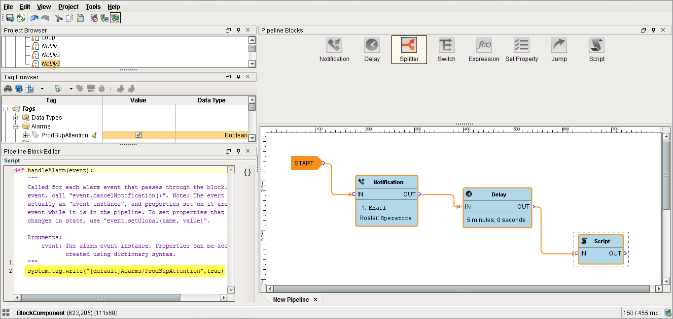

Script Block​
The Script Block allows you to execute a task outside the pipeline like writing to another alarm tag or database. In this example, the Script Block was used to notify the production supervisors of an alarm using another alarm tag as shown in the Pipeline Block Editor.
Alarm Pipeline: Script Block
