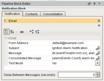

Email Settings​
  • From Address - Email address used for the "From" field.
  • Message - The body of the email. Like the subject, may refer to properties of the alarm. Message supports HTML formatting. Simply add the <html> tag at the beginning of Message property. An end tag (</html>) is not required.
    <html>This is my message. <br>That was a line break.
  • Consolidated Message - The message sent when consolidation is turned on, and more than one alarm is being sent. Can refer to properties, and additionally support a special expansion syntax of "{{ ... }}", where everything inside of the double curly braces will be repeated for each alarm in the consolidation group.
  • Test Mode - If enabled, logs to the console each time an email would be sent, instead of sending the actual email.
Notification Block: Notification Tab Email Settings

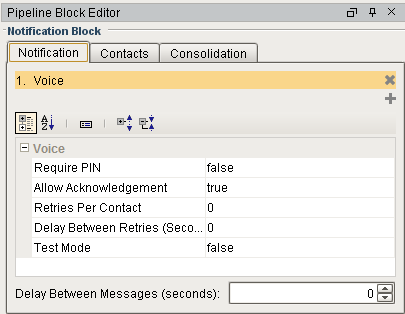

Voice Settings​
  • Require PIN: If true, the user will need to enter their PIN in order to ehar the alarm notification messages. The user's PIN is defined in the user management section of the Gateway. If false, then anyone will be allowed to hear the messages after answering the phone.
  • Allow Acknowledgement - If flase, users will only be allowed to listen to alarms, not to acknowledge them.
  • Retires Per Contact - The number of retry attempts per contact per alarm. The default is set to 1.
  • Delay Between Retries - Introduces a delay between calling each contact, for each alarm.
    • The pipeline dropout conditions are checked regularly between calls and while waiting, so this would provide time for the alarm to drop out before calling the next person.
    • The delay is only enforced after following a "successful" call (a call that was answered). Unanswered or errored calls will move on to the next contact right away. Note that long delays can block other alarms in the call queue.
    • The delay is applied to all contacts for a particular alarm. For most phone systems, a delay of at least 1 second is advised.
    • The system must have time between each call to hang up properly before dialing again.
  • Test Mode - If enabled, messages will be logged to the console indicating when and to whom calls would have been made, without actually making a call.
Notification Block: Notification Tab Voice Settings

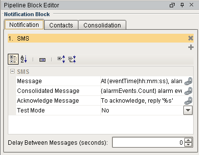

SMS Settings​
  • Message - The message to use for single events.
  • Consolidated Message - Like email, the message to use when multiple events are sent together, due to the block's consolidation settings.
  • Delay Between Notification - As with voice, a delay between each message sent, to give the recipient time to acknowledge and prevent further notification.
  • Test Mode - If enabled, logs messages that would have been sent to the Gateway console, and does not actually send them.
  • New in 7.9.1
    Acknowledge Message - When two-way SMS notification is enabled, this property allows for the configuration of the acknowledgment instructions the users receive in the notification. The '%s' will be replaced by the user's acknowledgement code.
Notification Block: Notification Tab SMS Settings

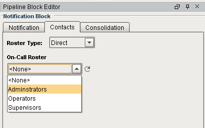

Direct​
The Direct roster type is the simplest to set up and use, but also the least flexible. Any On Call Rsoter defined on the Gateway can be used directly.
Notification Block: Direct Roster

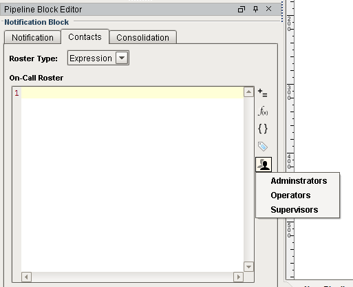

Expression​
The Expression roster type makes it possible to dynamically choose a single, predefined roster from within the pipeline. The expression can make use of Tag values, alarm properties, and associated data. The alarm properties are accessible from the Alarm Properties (Alarm Properties Button) button located on the right side of the panel. Associated data can be manually entered using the { and } characters. A list of rosters is available from the On-Call Rosters (On-Call Rosters Button) button.
Notification Block: Expression Roster
The expression below checks for associated data named "Group" on the alarm. If the value is equal to "A", the Group A roster is used, otherwise the Group B roster will be notified.
if({Group}= "A","Group A","Group B")
When Should I Use Quotation Marks on the Roster Name?​
It is recommended to always place quotation marks around roster names. However, it is not always required for notifications to be sent out successfully.
If the expression consists of only the name of the roster, then quotes can be omitted. For example, specifying that a Notification block should always use the roster named "Operators" could look like the following with quotes:
// This expression will evaluate successfully.
"Operators"
Which would return the string Operators, a valid Roster.
In this scenario, quotation marks could be removed. This normally causes a syntax error, because strings in expressions must be encased in quotation marks. However, in this case, the Notification block will assume you simply typed out the name fo the roster, so the following example will also successfully use the Operators roster:
// This will fail to evaluate as an expression, so the block will instead look for a roster named "Operators",
// and the users will still be notified.
Operators
If the expression is any more complicated than the above example, such as using an expression function, then quotation marks must be used. The following example would check the priority of the alarm. If the alarm's property was "critical", then the High Priority Roster would be notified. For all other properties, the Low Priority Roster would be used.
if({priority} > 3, "High Priority Roster", "Low Priority Roster")
In this scenario, if the quotes were removed from the roster names, the expression would fail with a syntax error:
//This expression will fail, so all the text is assumed to the name of a Roster
if({priority} > 3, High Priority Roster, Low Priority Roster)
When this expression fails, the Notification block will assume that the text is actually the name of a roster, and will attempt to use a roster named **if({priority} > 3, High Priority Roster, Low Priority Roster)**. For this reason, it is a good idea to always place quotes around Roster names, as well as check your expressions for syntax errors.

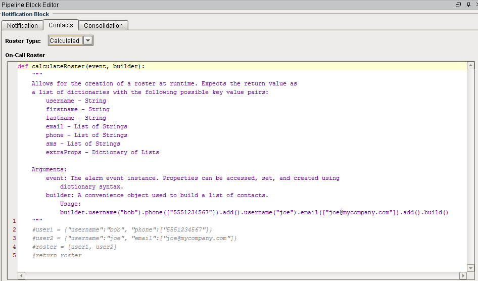

Calculated​
The Calculated roster type allows you to use scripting to create a roster at that time using scripting. This becomes extremely useful for situations when you are not sure who should be contacted at the time. Instead of creating an on-call roster for each possible combination of users, you can determine who needs to be notified in the script based on the circumstances of the alarm, and then build the roster to fit that scenario. While this is extremely powerful and offers the most flexibility, it is the most difficult to configure, so you should only use it when absolutely necessary.
Notification Block: Calculated Roster
The Calculated roster type requires a return value which is a list of dictionaries, where each dictionary is a set of contact information. The contacts that you use are specific to that instance, meaning neither the user nor contact information have to exist on the Gateway. This can either be done manually, by putting together dictionaries with the appropriate contact info and then placing them into a list, or you can use the builder to put together the list for you. Both end up with the same results, so we advise that you use the one that you find easier. The builder has a set of methods which align with the key:value pairs the dictionary is expecting.
NameDescriptionDatatype
usernameA username for this particular user. Note: this can be anything that you want, the user does not have to exist in the Gateway. This will be used for acknowledgement and auditing purposes, so it is important you create meaning usernames.String
firstnameA first name for this particular user.String
lastnameA last name for this particular user.String
emailA list of possible email addresses for the user.List of Strings
phoneA list of possible phone numbers for the user for voice notification purposes.List of Strings
smsA list of possible SMS numbers for the user for SMS notification purposes.List of Strings
extraPropsExtra properties that can be added to a user. This is useful when dealing with any third party functionality.Dictionary of Lists
User Data Created Manually​
When putting together a dictionary manually, uou can use some or all of the properties listed in the table above. You can create as many dictionaries of users as you want, adding in as much or as little contact info. Once you have your dictionaries created, you then need to place them in a list. You then need to use that list as the return value, which the pipeline will use determine who to contact.
Manual User List
# create your user dictionaries
user1 = {"username":"mary", "email":["mary@company.com"]}
user2 = {"username":"john", "firstname":"John", "lastname":"Smith", "email":["john@company.com"], "phone":["1234567890"], "sms":["8905671234"]}
# create a list of the user data
userList = [user1, user2]
# return the user data
return userList
You can use this in conjunction with a database query to dynamically create a list of user information. See below for an example using the Builder.
User Data Created with the Builder​
If you instead opt to use the builder, the builder object has a few extra methods that it can use besides what were listed above.
  • add() - will add all previous info as a single dictionary.
  • build() - will return the completed list of dictionaries.
The builder object is used by calling consecutive methods on it. Using the same info as the example above, you can add all of the contact info to the builder on a single line.
One Big Builder
# Here, we are putting together contact information in our builder using one big string of code.
# Notice that even though it is one long string of code, we are adding both users.
# The first add() at the end of Mary's information acts as a divider between the details, adding hers first.
# The second add() at the end of the code will then add all of John's information.
builder.username("mary").email(['mary@company.com']).add().username('john').firstname('John').lastname('Smith').email(['john@comapny.com']).phone(['1234567890']).sms(['8905671234']).add()
While the above will work just fine, it may be a bit confusing to put together. However, you don't have to add all of the users at once like that. You can instead break it up, making sure to call add at the end of each user's information.
Breaking up the Builder
# Here, I still add all of the same contact information to my builder, but this time, I do it in two stages.
# The difference here is that I have to call builder again in the second line when adding John's information.
builder.username('john').firstname('John').lastname('Smith').email(['john@comapny.com']).phone(['1234567890']).sms(['8905671234']).add()
This can be really useful as it can allow you to add users one at a time, making use of flow control methods like a for loop. You can then use external information, such as database records or Ignition's built in user and security functions to determine who to add.
Looping through Users
# This would grab a table from the database that contains a username, email address, and SMS number.
# We must specify the database connection name because this is in the gateway scope.
data = system.db.runQuery("SELECT username, emailaddress, smsnumber FROM user_info_table", "DB")
# loop through the returned query data
for row in data:
# add users to the builder row by row
# note the extra [] in the email and sms functions
builder.username(row["username"]).email([row["emailaddress"]]).sms([row["smsnumber"]]).add()
Once you have all of the appropriate contact information added to the builder, you then call build() on the builder object. This will give us a new built object. We then return our userList as before. Using our example from above:
Complete Builder Example
# get user information from the database
for row in data:
# add each user to the builder
# use the builder object's build() function to create the finished list of data
userList = builder.build()
return userList
