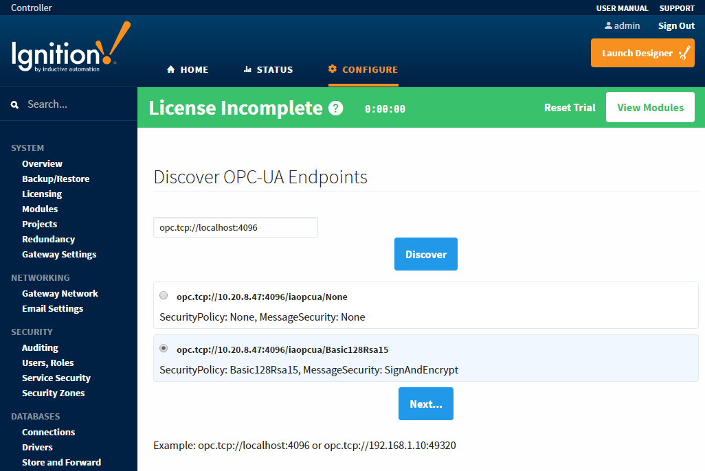

Connecting to a OPC-UA Server - 7.9.13 and Prior​
  1. On the Configure page of the Gateway, go to OPC Connections > Servers.
    The OPC Server Connections page is displayed.
  2. Click on the Create new OPC Server Connection link.
  3. Select OPC UA Connection from the list and click Next.
    The Discover OPC-UA Endpoints page will appear.
  4. Enter an OPC-UA endpoint for the OPC-UA Server Ignition should connect to. The format should be as follows:
    opc.tcp://IpAddress:Port
    Instead of an IP addresss, a hostname can be used:
    opc.tcp://myhostname:1234
  5. Once an endpoint has been entered, click the Discover button. A list of available Security Policies and Message Security options will appear.
  6. Select a Security Policy and Message Security configuration to use when connecting to the endpoint, then click Finish. The policies that appear here are determined by the server you're connecting to.
  7. On the New OPC-UA Connection Settings page, give the connection a name. Some OPC-UA servers may require a Username and Password, but this is not always the case. Check with the OPC-UA server's documentation for more details. By default, Ignition's OPC-UA server requires the following credentials:
    • Username: opcuauser
    • Password: password
  8. Once credentials have been entered, click the Create New OPC Server Connection button.
    Ignition is now connected to the OPC UA server.

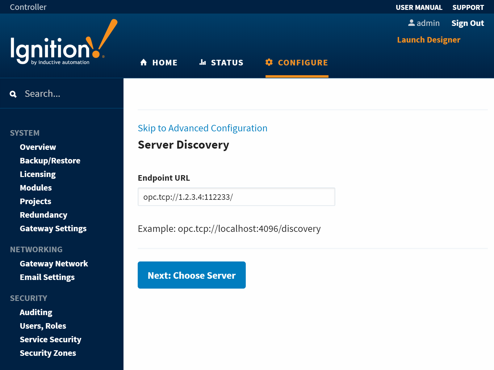

Connecting to a OPC Server - 7.9.14+​
New in 7.9.14
The connection workflow was updated in 7.9.14. The steps below detail UA client connections for more modern versions of Ignition.
    The Server Discovery page will appear.

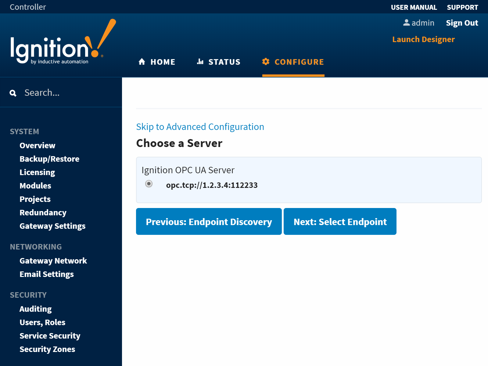

  4. Type in the endpoint for the server, and click Next if you want to use the discovery wizard. Alternatively, you can click the Skip to Advanced Configuration link that allows you to manually enter the Discovery URL, Endpoint URL, and a Endpoint Host Override. You can continue to follow the basic wizard workflow, but users that opted into the Advanced Configuration can skip to Step 8.
  5. From here, you'll be shown a list of servers at the endpoint you entered. Select your server and press Next.
  6. You will then be presented with a list of available security policies and security modes for the server. Select the policy and mode you wish the connection to use, and click Finish.
  7. You'll arrive at the Confirm Connection Settings page, which allows you to review your configuration thus far. If everything is accurate, press the Finish button, which exits the wizard, and takes you to the server configuration page.
  8. On the Server Configuration page, give the connection a name. Some OPC-UA servers may require a Username and Password, but this is not always the case. Check with the OPC-UA server's documentation for more details. By default, Ignition's OPC-UA server requires the following credentials:
  9. Once credentials have been entered, click the Create New OPC Server Connection button.
    Ignition is now connected to the OPC-UA server.

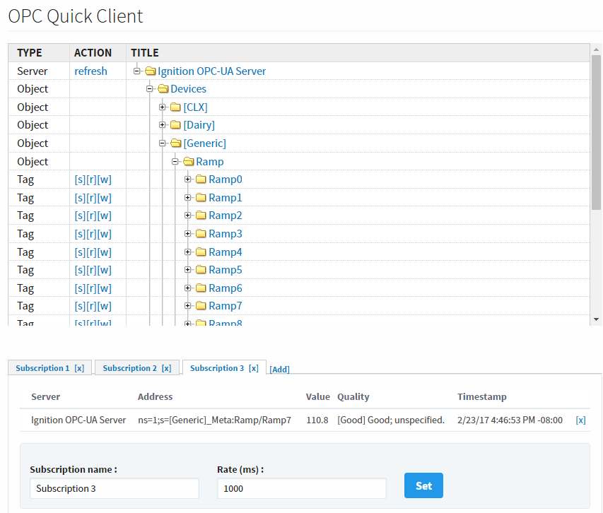

OPC Quick Client​
You can access the OPC Quick Client from under the OPC Connections section of the Ignition Gateway Configure section. It allows for quick, simple testing of any devices connected to the server.
You can browse by expanding tree nodes and read/write to Tags by clicking on the [r] and [w] buttons next to those Tags.
Subscriptions can be made by clicking on the [s] button. For each individual subscription, you can click on the SET button and it will automatically refresh subscriptions and show live value changes (if there are any).
