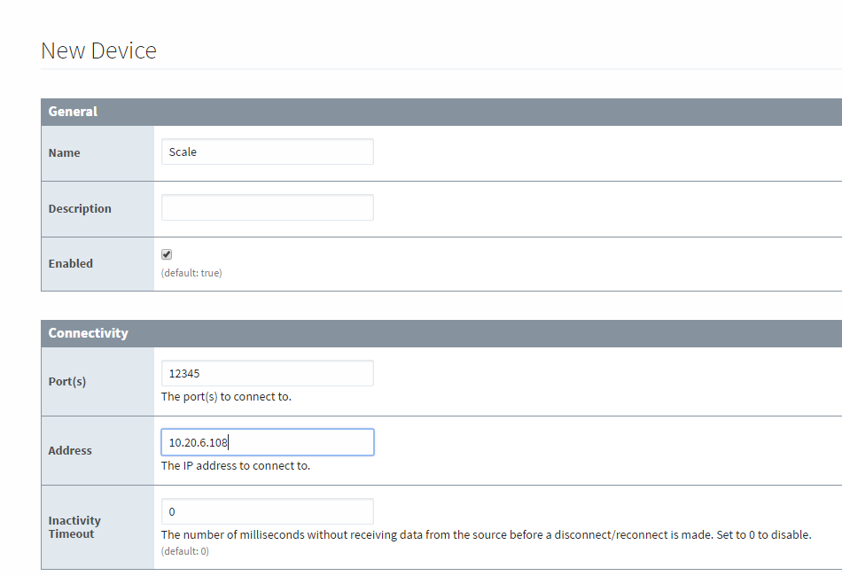

To Connect to a Barcode Scanner or Scale​
You can connect to a barcode scanner or scale by using Ignition's UDP and TCP driver.
  1. Go to the Configure section of the Gateway webpage.
  2. Scroll down and select OPC-UA Server > Devices.
  3. On the Devices page, find the blue arrow and click on Create new Device.
  4. On the Add Device Step 1: Choose Type page, scroll all the way down and select TCP Driver, and click Next.
  5. On the New Device page, leave all the default values and type in the following fields:
    • Name: the name you specify here will appear under Devices folder on the Quick Client page in the Gateway.
    • Port(s): 12345, as an example
    • Hostname: type the IP address, for example 10.20.6.108
  1. You can check the box for Show advanced properties? to see the additional settings, but you can keep all the defaults.
  2. Click Create New Device. The Devices page is displayed showing the Scale device is successfully created and added to Ignition. The Status will show as 1/1 Connected.
  3. Go to the OPC Connections > Quick Client in the Configure section of the Gateway, under the Devices>[Scale]>12345 folder you will see the Last Receive Time and the Message folders. Next to each tag, under the Action column, you will see [s][r][w].
  4. Click on [s] which means Subscription. You will be able to see the Value of the tag displayed on this OPC Quick Client page.
