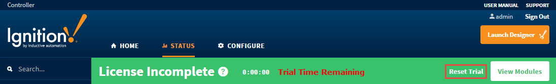

Trial Period
Our goal, at Inductive Automation, is to provide an easy way to access and learn Ignition. We want everyone to have the opportunity to try Ignition and start working with it with no restrictions. You can download Ignition from our webpage, install it, and start using it for 2 hours at a time. At the end of the 2 hour time period, all modules will stop running, but don't panic, you can reset the timer to run for another 2 hours. You can reset the timer as many times as you want, so go for it! The Gateway Webpage and the Designer are not affected by this trial, so you can develop for as long as you want without interruption. If you do have a license, any unlicensed modules will run in this Trial mode, but licensed modules will never timeout. To learn more, go to About the Trial Period.

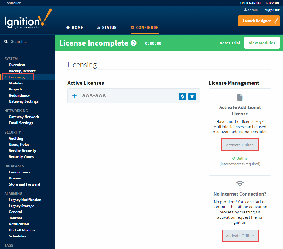

You can activate your license in two ways:
- Over the Internet - from the System > Licensing section on the Gateway webpage, your request to activate your Gateway is activated over the internet.
- Manually - if you don't have an internet connection, you can follow the offline activation process in the Activating Manually section.

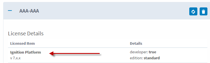

It is important to note that there may only be one license on it with a platform version per gateway. The platform will look similar to the picture below. If you try and activate a second license with a platform onto a gateway that already has a license with a platform, the new license will overwrite the previous license.

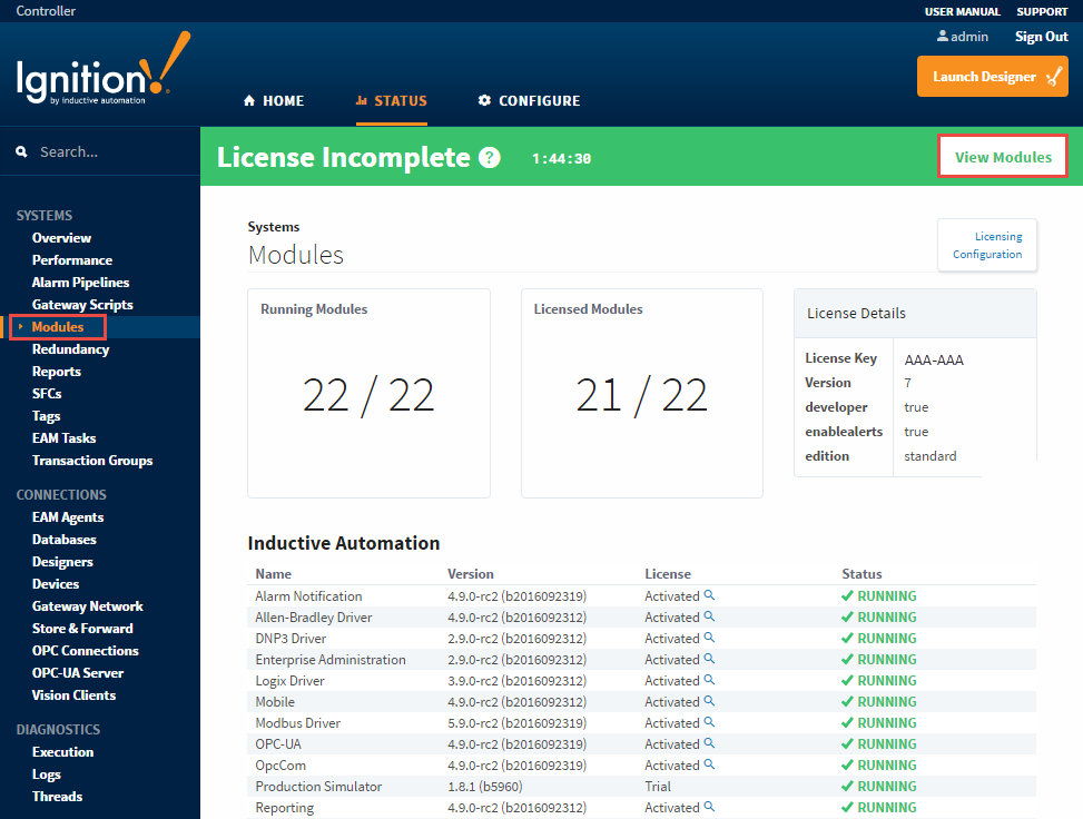

Module Status
It's important to know which version of a module you have installed and which version of the module you are licensed for. You could have a license for another version of a module so it's not going to work correctly until you have the correct version of the license. It's always a good idea for you to verify the versions on your installed modules by going to the Modules page in the Gateway Webpage or by clicking View Modules in the green banner.
Here you can see all the modules that are currently running with their version numbers and license status. The licenses are either in Trial, Activated, or Free mode. On this page, you can add or remove modules from your Ignition. If you are licensed for a module you are running, it will run in Activated mode. If you are not licensed for a module you are running, it will run in Trial mode until the Trial time is expired.

If you want to add more modules to your existing license, just call Inductive Automation Support and we can add whatever you need. Once we upgrade your license with the new modules, your license needs to be updated. You update a license using the same license from the Configure > Licensing section on the Gateway webpage.
Two Methods of Updating a License
You can update your license in two ways:
- With an Internet Connection - from the System > Licensing section on the Gateway webpage, update your Gateway license over the internet.
- Without an Internet Connection - if you don't have an internet connection, you can follow the offline update process in the Without an Internet Connection section.
