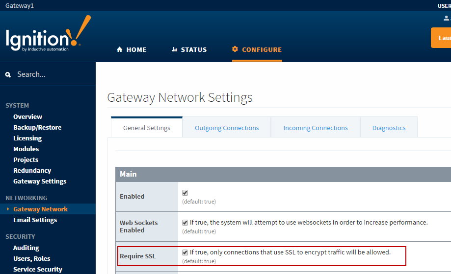

  • To enable SSL on the Gateway Network, you must enable SSL in two places. On the machine that will receive incoming connections (which we will call Gateway1), you must navigate to Configure > Networking > Gateway Network, click on the General Settings tab, and check the Require SSL checkbox. This mode requires all incoming connections to use SSL mode. Any existing incoming connections will become faulted as they are not using SSL. Click the Save Changes button.

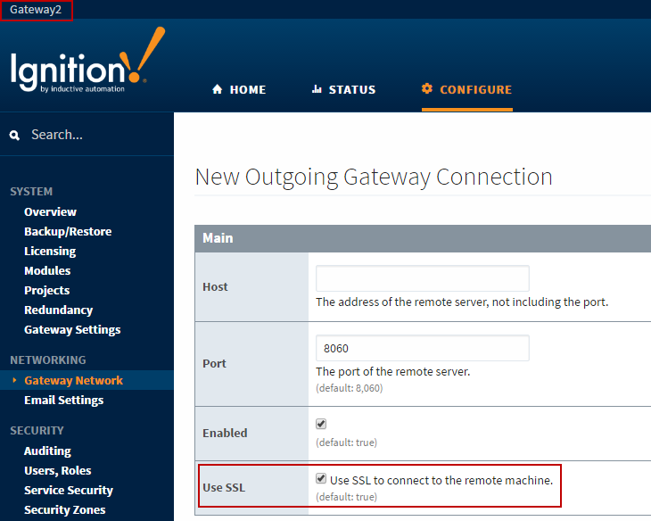

  • Next, log into a Gateway where you wish to establish an outgoing connection. We will call this Gateway2. Navigate to Configure > Networking > Gateway Network and click on the Outgoing Connections tab and click the Create new link. As you are entering the settings for the new connection, check the Use SSL checkbox. Also, change the Port to the SSL port used by the other machine. By default this is set to 8060 (which is defined /data/gateway.xml). Save the new connection.

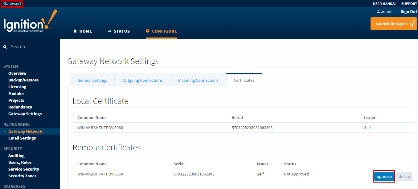

  • At this point, Gateway2 has transmitted its certificate to Gateway1, but Gateway1 has never seen this certificate, and so the incoming connection is not yet allowed. Note that the Gateway2’s connection will NOT show up under the Incoming Connections tab until AFTER the certificate has been approved. But if you click on the Certificates tab, Gateway2’s certificate should be present.
&quot; &quot;
The certificate Common Name field holds the network address of the machine that transmitted the certificate. The Serial field holds a numeric string that is automatically generated when the certificate is created, and is unique to every certificate. Click the approve link to approve the certificate. After certificate approval, the incoming connection will be accepted, and will eventually appear on the Incoming Connections tab. It make take up to 30 seconds for the connection to appear, as reconnect attempts are made every 30 seconds by default (controllable by the Missed Pings outgoing connection setting).
After a certificate has been approved, and the incoming connection is established, you can view the certificate information for a specific incoming connection under the Certificate field in the Incoming Connections tab. The certificate common name and serial number are displayed here, and reflect the actual certificate that was sent by the remote machine.
