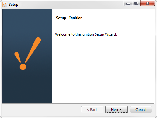

Simple Installation Steps​
You can download and install Ignition in just a few minutes! It's very simple:
  1. Download Ignition from your web browser
  2. Run the installer on any any Windows, Mac, or Linux operating system that can run Java 8
  3. The Gateway Webpage opens automatically after the installer finishes so you can get started immediately!

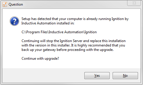

What about Upgrading?​
Upgrading is a snap, too! Just download the installer for your system from our website and run it. That's it! It will figure out if you already have Ignition installed and then change from an installer to an Upgrader automatically.
Simple Upgrading Steps​
Regardless of which Operating System you are using, upgrading has the same simple set of steps:
  1. Download Ignition within your web browser.
  2. Run the installer on the computer that has an older version of Ignition (don't forget to backup your work!)
  3. The installer automatically upgrades all of your projects and opens the Gateway Webpage!
For a complete guide to protect your projects when upgrading, see the Best Practices when Upgrading page.
