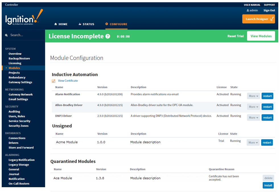

You can check on all the installed and uninstalled modules from the Gateway webpage on the Configure > Modules page. The Module Configuration page is grouped by categories and you can see at a glance what modules are installed, which modules have certificates, and which modules are unsigned.
Inductive Automation modules are displayed first, followed by SepaSoft modules. Modules from other authors are grouped by the trust level of their modules certificate. Authors who use multiple certificates will have multiple groups. On the Module Configuration page, you'll notice all certificates will display a link to the general details about the certificate. Modules in the Quarantined section are not installed, and typically need some action (i.e., accept the certificate and/or license, or install the module). Unsigned modules when not running in Developer mode will also be in the Quarantine section, and the Install button will be grayed-out so the module cannot be installed until the Gateway is restarted in Developer mode

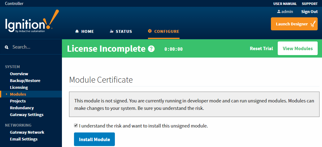

For Inductive Automation and other third party modules that have already been signed, nothing is changing about the installation. For new third party modules with either no certificate, or signed the new way with a certificate that the user has not previously accepted, there is one extra step in the installation process. Go to the Configure > Modules page to accept the end-user license agreement. The user will then be directed to a page where they can view the module details and accept the certificate if there is one, or a message will be displayed that there is no certificate. The user will be asked to accept any risks of running unsigned modules as shown in the example below. An unsigned module will not install unless the user is in Developer mode. As a result, the user will not be able to continue with the module installation if Developer mode is not enabled.
