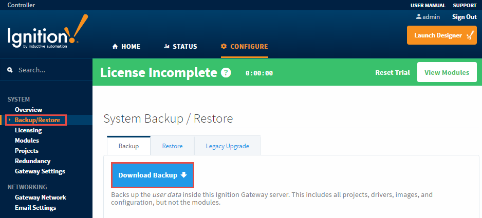

Make a Gateway Backup​
Upgrading Ignition is very easy, but you should always create a gateway backup before upgrading. If you need to rollback to the previous version of Ignition, then having a gateway backup from before the upgrade will allow you to easily move back to your prior version. You can rename your backups to include a version number to make them easy to track.
Go to the Configure section of the Gateway Webpage, select System > Backup/Restore and make a backup before running the installer/upgrader.

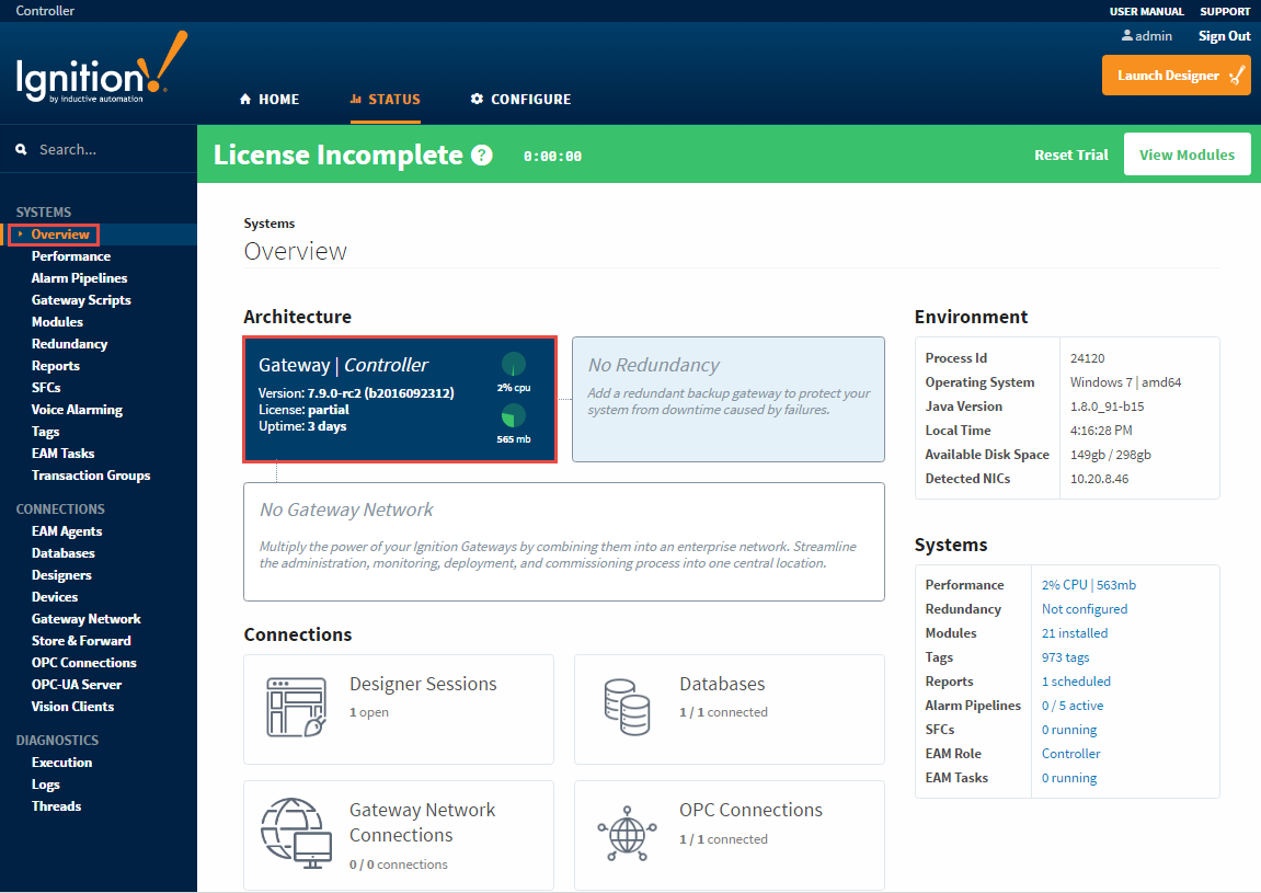

Check Versions​
Is this is a Major version update or a Minor version update? You can check the version of your Ignition in several ways. The easiest way is to log into the Status section of the Gateway Webpage, and select Systems > Overview. The version is listed on the Overview page under Architecture.

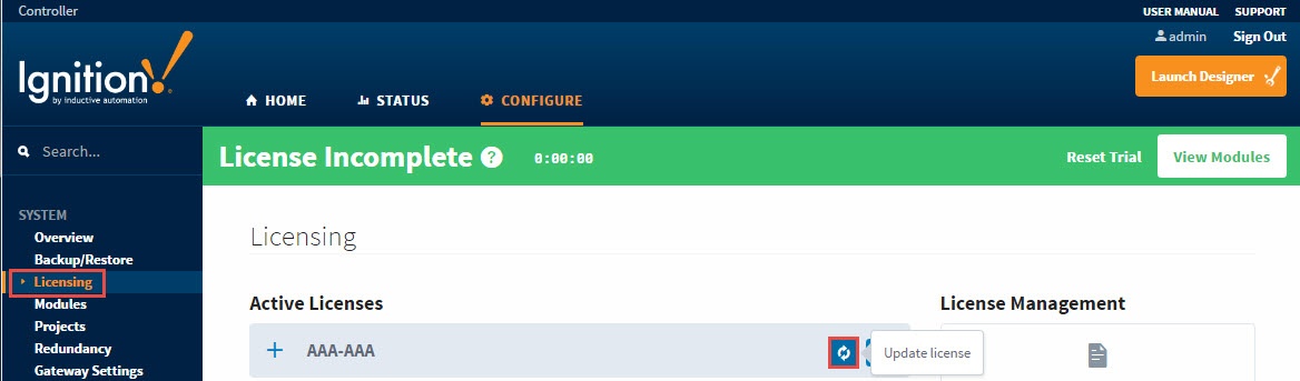

Reload Your License​
Once your license is updated in our system, go to the Configure section of the Gateway Webpage and click System > Licensing. Click on the Update License icon " ".
See our Updating a License page for a detailed guide. If you are coming from an older version, the gateway may look different. Don't worry, all this functionality is still there, but you may have to unactivate the reactivate instead if the Update License icon is missing.

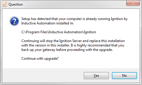

Once you've made a backup and you're ready to upgrade the proudction server, simply run the Ignition installer. The Ignition installer doubles as an upgrader and will automatically check for an existing installation and upgrade any installed modules.
