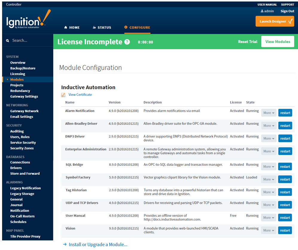

All module configuration is done from Gateway in the Configuration > Modules section. From here you can add, remove, and restart modules. Modules integrate their settings into the Gateway configuration tree, and therefore do not offer settings in this section.
To Install or Update a Module
On the Configuration > Modules page of the Gateway, go to the bottom on the list, find the blue arrow, and click the Install or Upgrade a Module link.

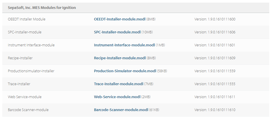

Click Choose File and select a
.modlfile that you have previously downloaded.Don't have an Ignition module already downloaded?Go to the Inductive Automation downloads page. Search for the module you want and save it to your Downloads folder on your computer.
Third Party Modules
All third party Ignition modules require the Ignition platform to be installed.To install third party modules:
- Install Ignition: See Installing and Upgrading Ignition
- Once Ignition is installed, download the module and install it in the Ignition Gateway: See Installing or Upgrading a Module
Note: If you are using Internet Explorer, IE changes the file extension to a '.zip' file. Rename '.zip' to '.modl' (I.e., Production Simulator-module.modl).
Go back to the Install or Upgrade Module screen and browse your Downloads folder for your module, select it, and click Open. Ignition will copy the path to the module to the Browse field and all that's left for you to do is click Install.
Click Install. When the page reloads you can now see the module you installed in the list of modules.

Module Status
The installed module list on the Configuration > Modules page also provides some basic information about the State of the module. The Version, License, and State columns are all displayed in the list. Module licensing is performed centrally in System > Licensing, so the values here are only for information purposes.
