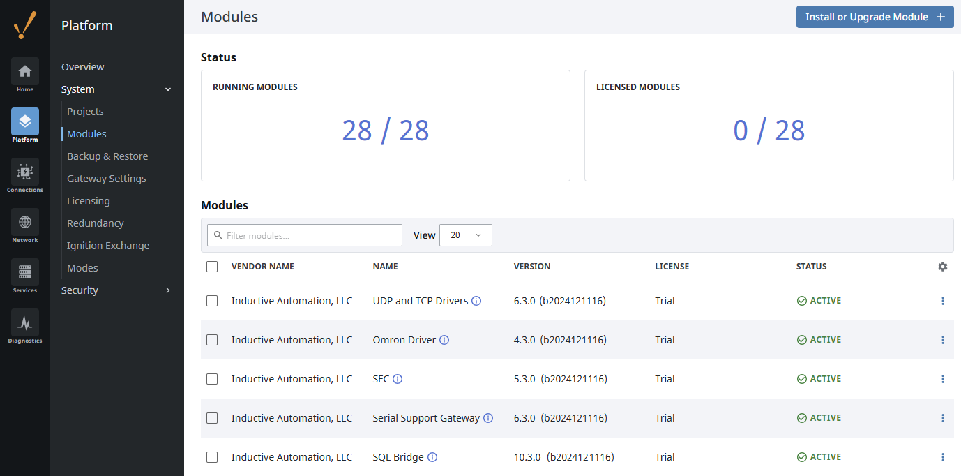

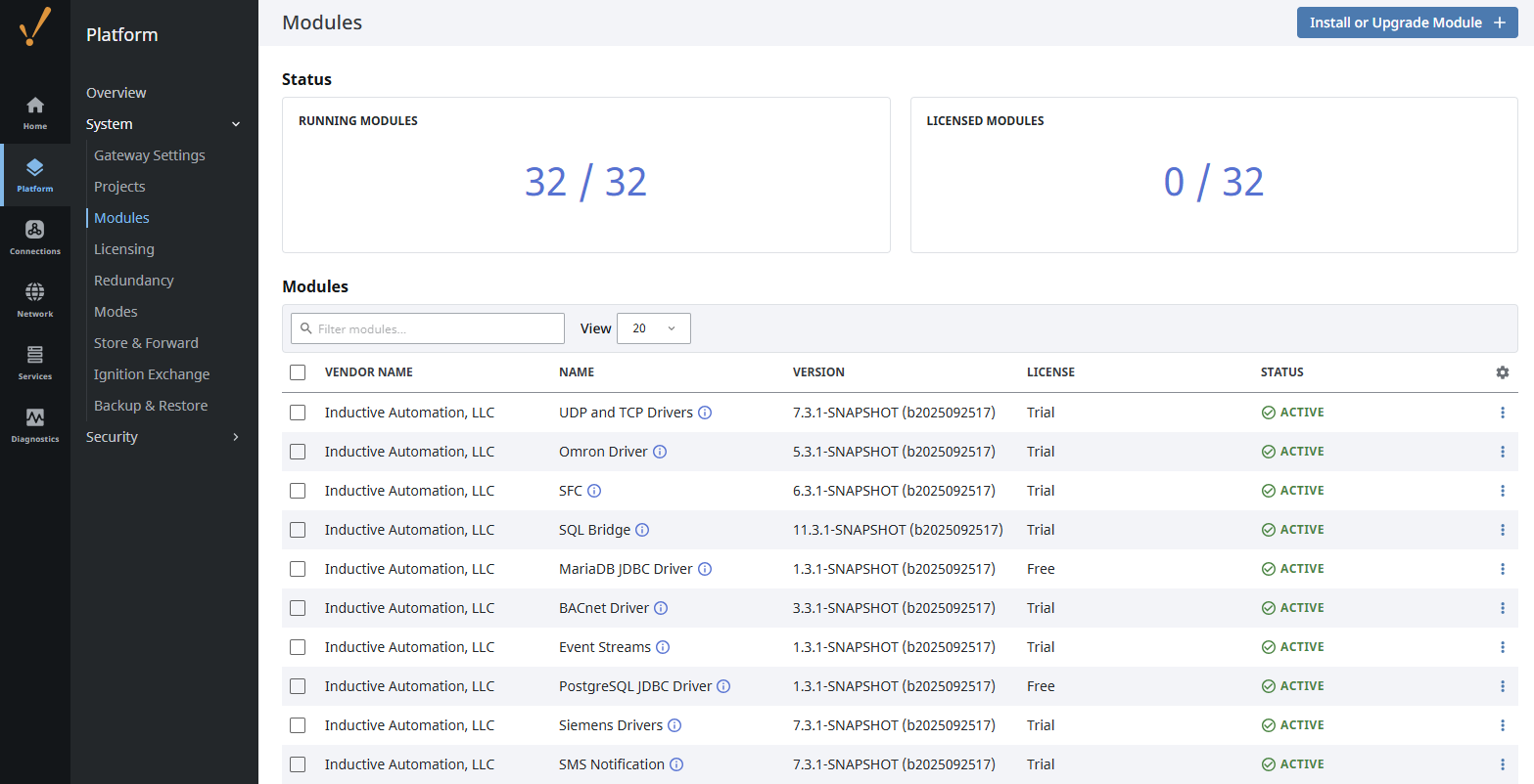

Module Configuration​
All module configuration is done from Gateway Webpage in the Platform > System > Modules section. The Modules page shows a list of the currently installed modules, their current version, and if they are running properly with a license. The top of the page shows a quick count of the running and licensed modules, so you can easily tell if anything is not working. It is then easy to scroll down through the list to see which modules are having issues.
From here you can also add, remove, enable, and disable modules. Modules integrate their settings into the Gateway configuration tree, and therefore do not offer settings in this section.

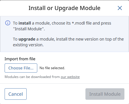

  1. On the Gateway Webpage, select Platform > System > Modules to open the Modules page.
  2. Click the Install or Upgrade Module +.
  3. Click Choose File, select a .modl file that you have previously downloaded.
  4. Click Install. When the page reloads you can now see the module you installed in the list of modules.

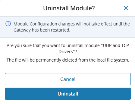

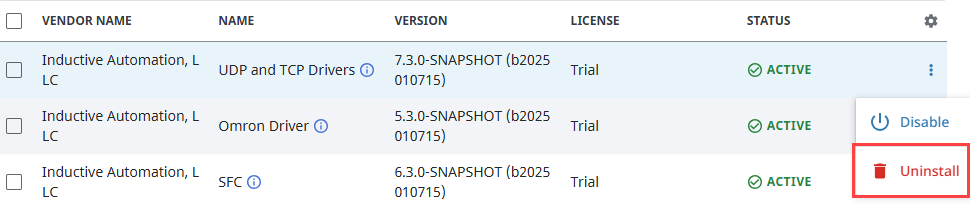

Uninstall a Module​
note
Uninstalling a module will require connected Vision Clients and Designers to restart. Perspective Sessions will not require a restart. Production systems using either Clients or Designers should wait for downtime before uninstalling a module.
  2. Locate the module you want to uninstall.
  3. To the right of module name, click the three dot menu and select Uninstall.
  4. Click Uninstall. The module is no longer installed and is removed form the list.

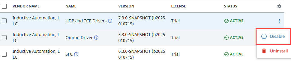

Disable a Module​
  2. Locate the module you want to disable.
  3. To the right of module name, click the three dot menu and select Disable. A confirmation message appears.
  4. Click Disable.
The module status will change to Active Pending Restart until the Gateway has been restarted, and the Gateway Restart Required banner will appear at the bottom of the page. After the Gateway has been restarted, the module will still be listed but will not be functional.

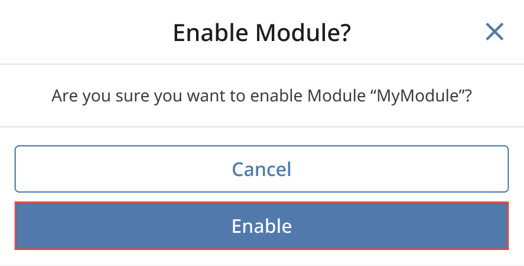

Enable a Module​
This option is only available for a currently disabled module.
  2. Locate the module you want to enable.
  3. To the right of module name, click the three dot menu and select Enable. A confirmation message appears.
  4. Click Enable.
The Gateway Restart Required banner will appear at the bottom of the page for you to easily restart your Gateway. After the Gateway has been restarted, the module will be enabled.

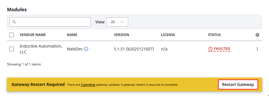

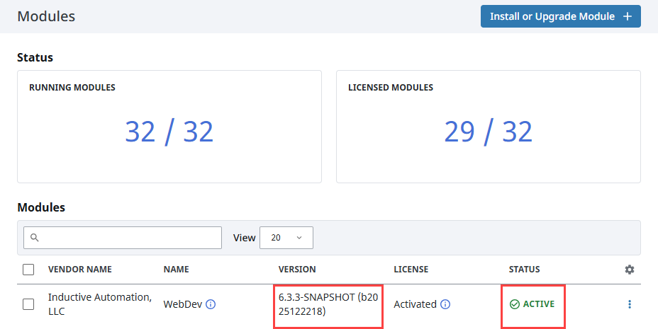

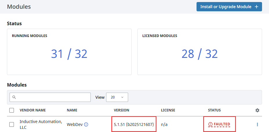

Module Shows as Faulted After Installation​

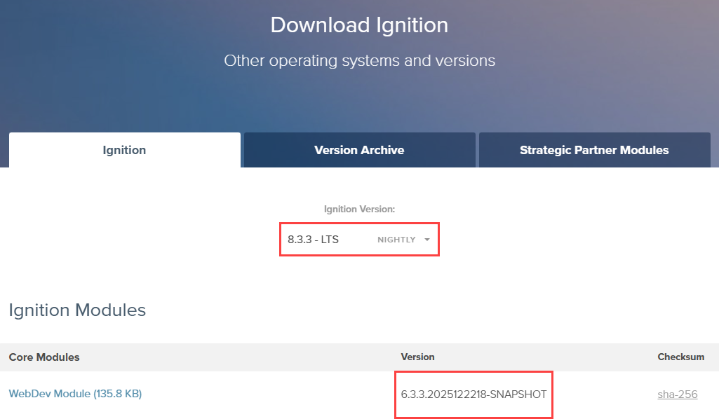

In some cases, a module may appear to install successfully, but its functionality does not become available. A common cause of this behavior is a version mismatch between the installed module and the Ignition platform. For a module to load correctly, the middle digit of the module version must match the middle digit of the Ignition platform version. If a version mismatch is detected, the module will display a Status of Faulted on the Modules page.

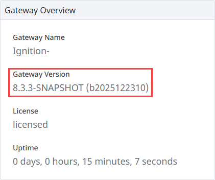

To verify compatibility, navigate to Diagnostics > Overview and note the Ignition version currently running on your Gateway.
Because the WebDev module shown above has 1 as the middle digit and the Gateway has 3, there is a version mismatch and the module will remain in a faulted state. To resolve this, download the correct version of the module from the Inductive Automation Downloads page. Use the Ignition Version dropdown or Version Archive tab to select the Ignition version that matches your Gateway. From the list of available modules, locate the compatible version and download it.
After installing the compatible version, the Gateway Restart Required banner will appear at the bottom of the Modules page. Click the Restart Gateway button to complete the installation.
Once the Gateway has been restarted, the module will show a Status of Active, and will become available for use.

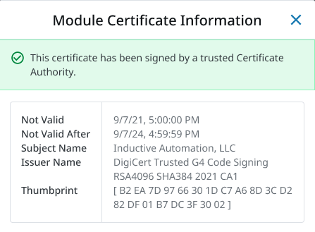

Verify Trusted Modules​
Verify the authenticity of Ignition modules on the Platform > System > Modules page. Expand the three dot menu for your module and select View Certificate to see details about each certificate.
A warning message will appear if the module certificate is expired, however this will not have any impact on security or module behavior.

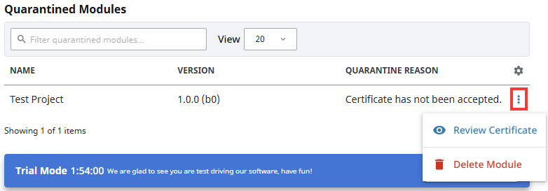

Near the bottom of the Modules page is the Quarantined Modules section. Modules can be quarantined for various reasons, such as a certificate being unsigned or needing review, or licensing issues. The Gateway will list the specific reason a module is quarantined, along with the module name and version.
New in 8.3.2
If a module has been quarantined, you can still trust it and add it to your Gateway. To do this, click on the three dots menu next to the quarantined module you want to use. You will be presented with an option to either resolve the quarantine reason or delete the module.
