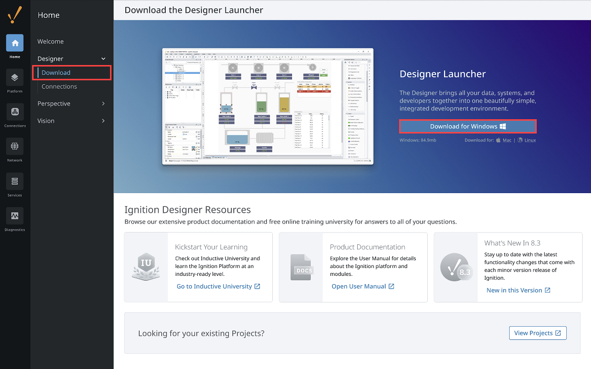

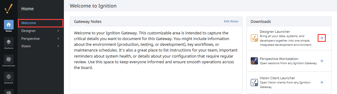

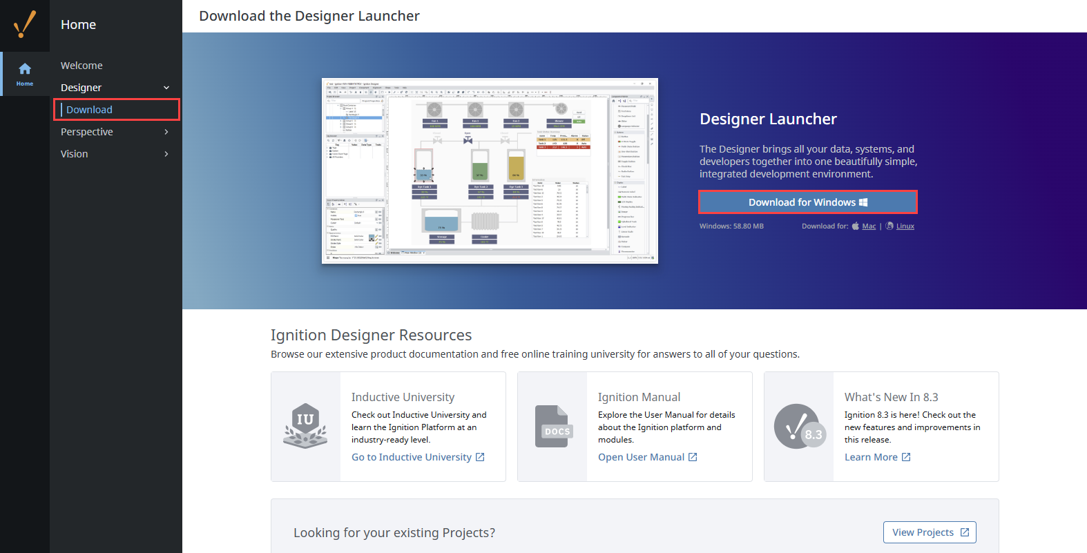

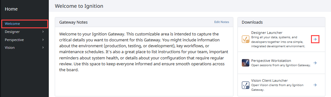

Go to Home > Welcome on the Gateway. You will see a Downloads section with options that lead to separate Download pages for each of the launchers.

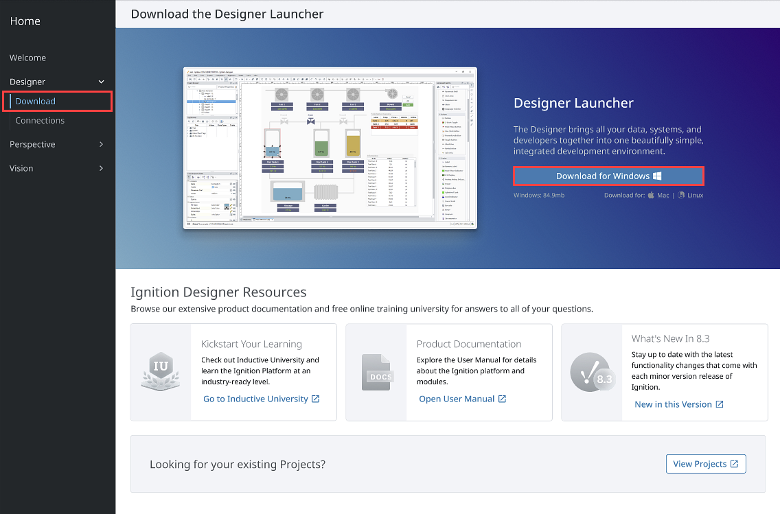

Click the desired arrow icon and you'll be redirected. We'll click on the Designer Launcher arrow.
Your web browser will detect the operating system, and suggest the appropriate download for the Download button. Click to download the installer for the launcher.
Locate the installer on your local system (web browser typically store downloaded files in a "Downloads" folder), and run it.
