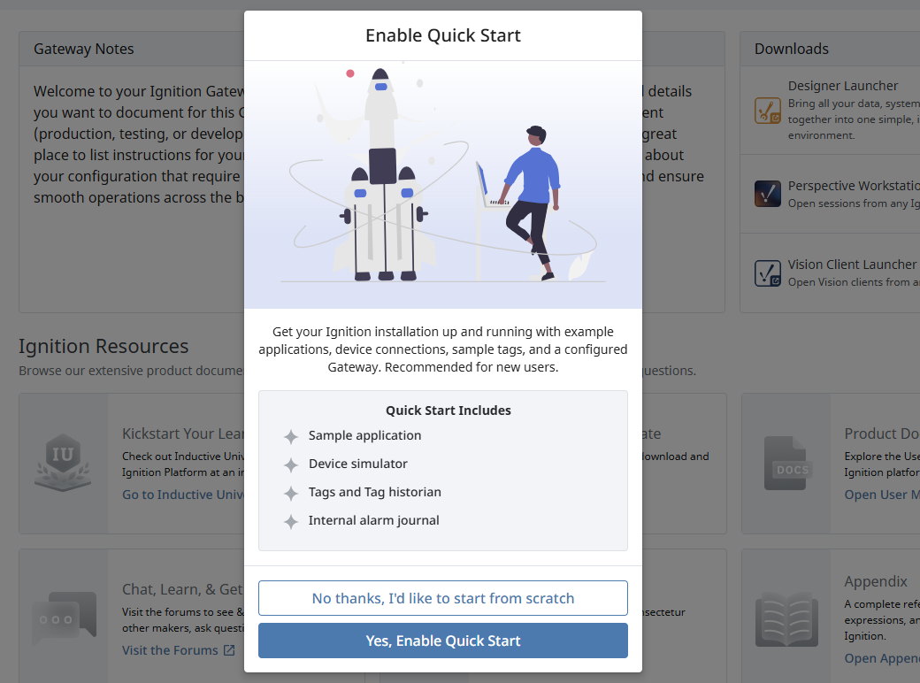

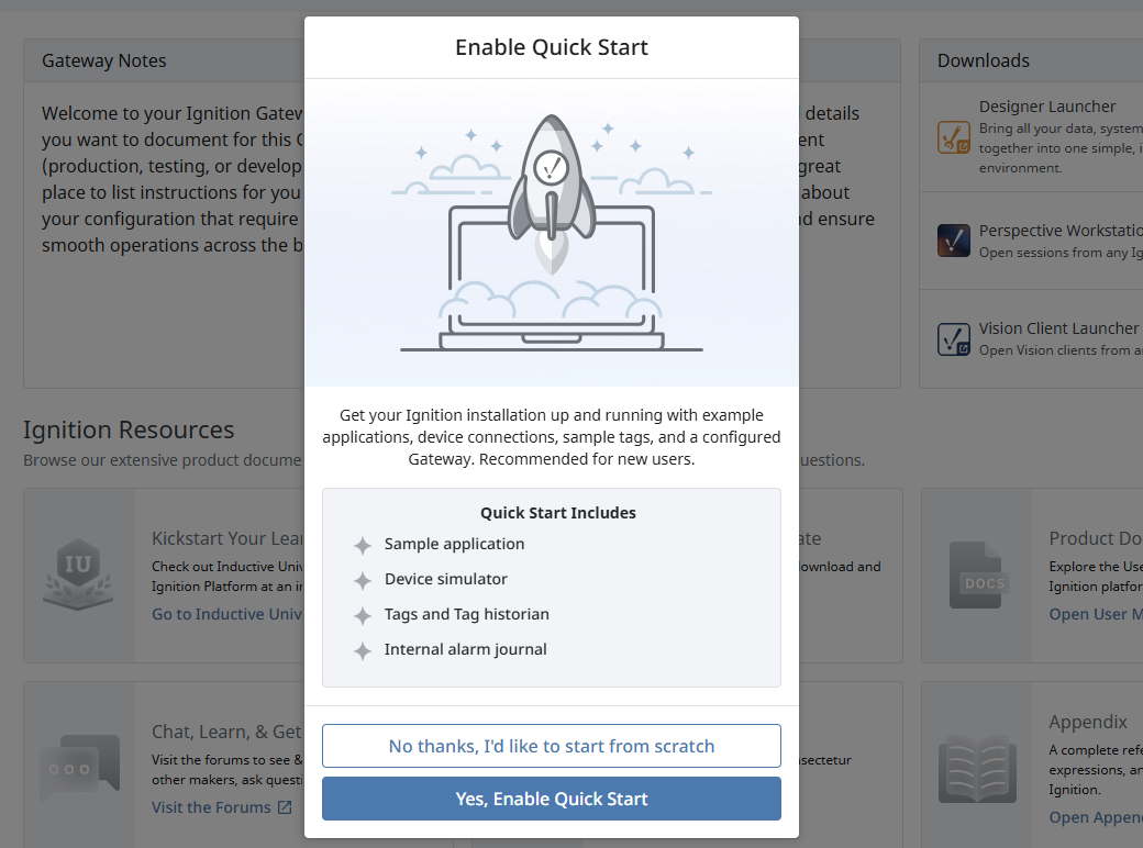

Quick Start Configuration​
Once the installation process has finished, you'll be redirected to the Gateway Webpage. From there you'll be asked to opt into the Quick Start configuration, which makes several configuration changes to the system. Quick Start can only be enabled upon a new installation.
The following changes are made once Quick Start is enabled:
- Creates an internal SQLite database connection.
- Configures a device connection to a Programmable Device Simulator instance, and adds Tags from the simulator into a Tag provider.
- Configures an internal alarm journal.
- Creates a sample project.

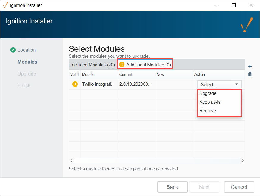

When you upgrade Ignition, you'll also be given the option to update any additional modules you currently have installed, including third party modules. On the Select Modules screen, there is a tab for the modules included in your version of Ignition, and a tab for Additional Modules you may be using. Under the Action column, you can choose to upgrade or remove the module, or leave it unchanged.
