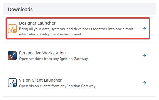

The Designer Launcher locates all the Gateways that are available on your local network. Once the Designer is open, you can access existing projects or create new projects on the Gateway. The Designer Launcher button on the right side of the Welcome page on the Home tab opens the Designer Launcher Download page.
Home Page Designer Download
Alternatively, you can go to the Home tab and click on Designer > Download.
Designer Download Home Tab

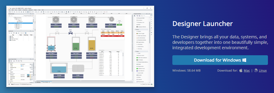

Here, you can find all the Designer Launchers for each operating system: Windows, Mac and Linux. Ignition automatically detects your operating system so all you have to do is download the launcher and follow the steps to install the Designer Launcher.
Designer Launcher Downloads Page

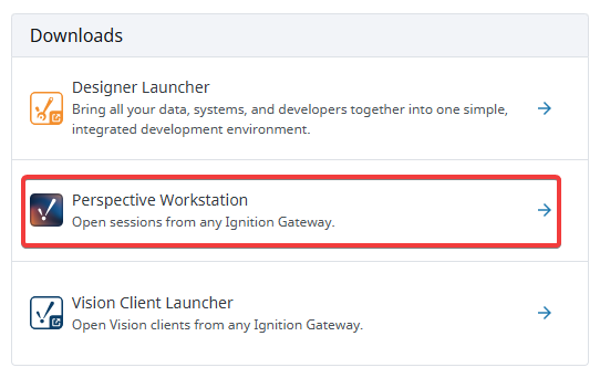

The Perspective Workstation allows you to run Perspective applications originating from any Gateway your network has access to. You can use the Perspective Workstation button on the right side of the Welcome page on the Home tab to open the Perspective Workstation Download page.
Home Page Perspective Workstation Download
Alternatively, you can go to the Home tab and click on Perspective > Download.
Perspective Workstation Download Home Tab

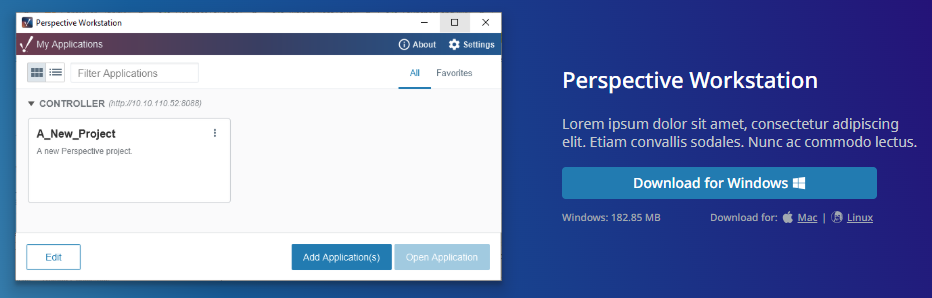

Here, you can find all the Perspective Workstations for each operating system: Windows, Mac and Linux. Ignition automatically detects your operating system so all you have to do is download Perspective Workstation and follow the steps to install it.
Perspective Workstation Downloads Page

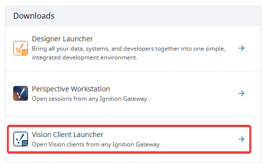

The Vision Client Launcher allows you to run Vision projects originating from any Gateway your network has access to. You can use the Vision Client Launcher button on the right side of the Welcome page on the Home tab to open the Vision Client Launcher Download page.
Home Page Vision Client Launcher Download
Alternatively, you can go to the Home tab and click on Vision > Download.
Vision Client Launcher Download Home Tab

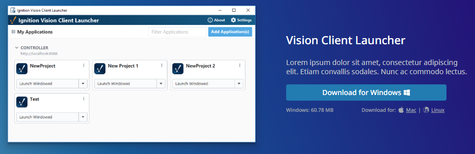

Here, you can find all the Vision Client Launchers for each operating system: Windows, Mac and Linux. Ignition automatically detects your operating system so all you have to do is download the Vision Client Launcher and follow the steps to install it.
Vision Client Launcher Downloads Page
