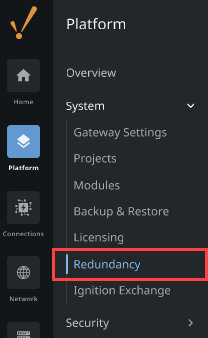

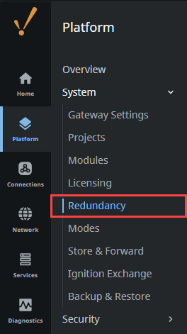

When you have redundant systems in place, you can go to your Gateway and select Platform > System > Redundancy to view the system's status and events.

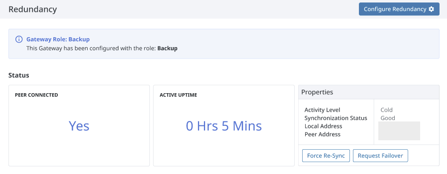

Metrics and Information​
The top section of the Redundancy page for a backup Gateway gives information about the Gateway and your redundancy setup, including:
  • Redundancy configuration settings
  • The current Gateway's role in the Redundant pair
  • If the Gateway has a peer connected
  • The current node's uptime after failover
  • Current redundancy settings
  • Force re-sync and request failover options
Requesting Failover
The Request Failover option switches the active node in a redundant pair. Failover to the other redundant node is allowed if the nodes have different platform versions, which will allow attached clients to remain connected to at least one node during a redundant pair upgrade.

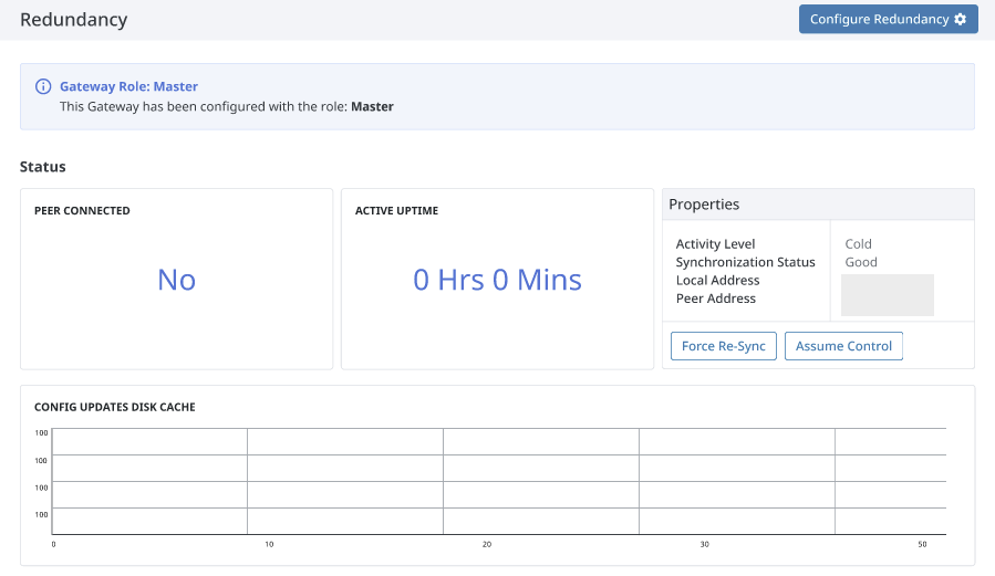

The following image is the Redundancy page from the master Gateway. Many features of the Redundancy page remain the same, with a few notable exceptions.
Redundancy Status Page Overview - Master
  • The Role is different, reflecting the Gateway's role in the redundant pair.
  • There is now an Assume Control option.

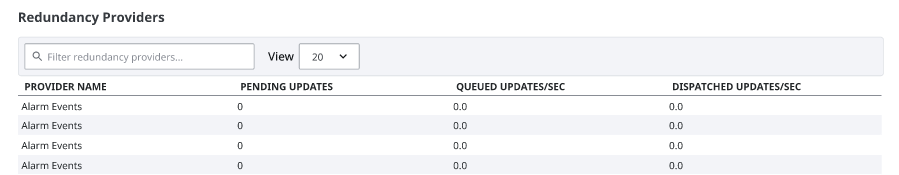

Redundancy Providers Statistics​
The next section of the Redundancy page details metrics about applicable redundancy providers.
Data presented for Backup roles include:
  • Provider Name: The name of the provider.
  • Last Pull: Displays the time since the provider was last pulled.
  • Last Pull Duration: The latest time duration (or how long it takes) for the Gateway to get data from the provider.
  • Last Apply Duration: The latest time duration (or how long it takes) for the Gateway to apply the data received from the provider.
  • Full Sync Needed?: Displays whether a full sync is needed. The Force Re-Sync button forces a full synchronization of the redundant configuration state. The backup node will be forced to restart.
  • System Restart Required: Displays whether a system restart is needed.
Data presented for Master roles include:
  • Pending Updates: The number of updates waiting to be sent to the other node. If the other node is not connected, this number may grow continually.
  • Queued Updates/sec: The number of updates per second over a 1 minute average that this redundant node has posted, which gives an indication of how quickly this node is posting updates.
  • Dispatched Updates/sec: The number of updates per second over a 1 minute average that the other node has pulled, which gives an indication of how quickly the other node is asking for updates.

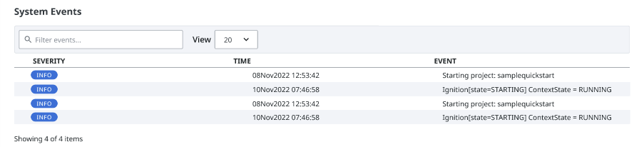

System Event Information​
The third section of the Redundancy page displays a table that will log system events whenever a full sync is required, helping to establish a timeline of when full sync events were requested.
Information displayed in this table includes:
  • How severe the system event was/is
  • When the system event occurred
  • The reason for the system event

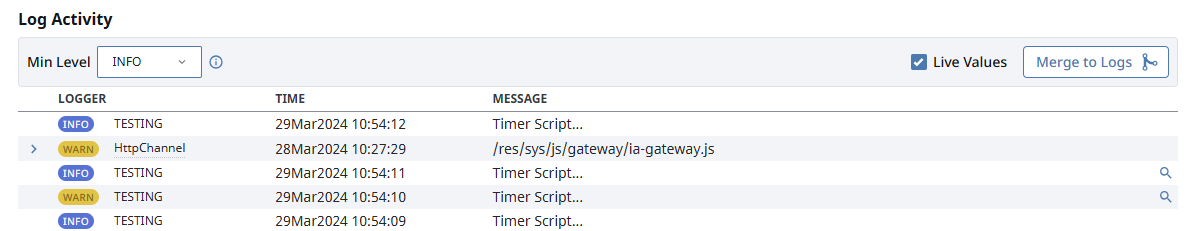

Logging Activity​
The final section of the Redundancy page shows logger activity and allows users to enable DEBUG and TRACE logs for a specific redundancy provider.
Features of the log activity table include:
  • Minimum logging level. Options are:
    • INFO
    • DEBUG
    • TRACE
  • An option to merge logs to the main diagnostic log viewer
  • The specified logger
  • The log's timestamp
  • The issue being logged

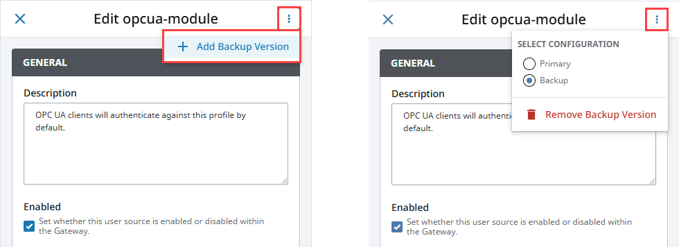

If you want any resource to have a different configuration on the backup Gateway, all you need to do is expand the three dots menu in the upper right-hand corner of that resource page or Edit panel, and select Add Backup Version. Changes saved on the Backup configuration will be applied to the backup Gateway and changes saved on the Primary configuration will be applied to the master Gateway.
