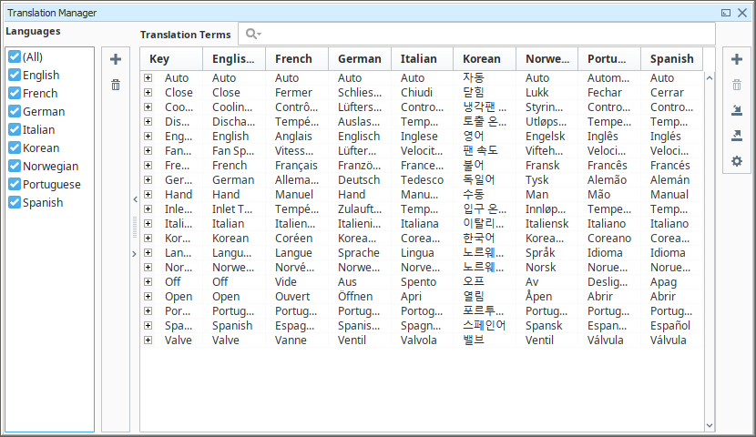

Translation Manager​
All translations are stored in a shared database that makes it possible to manage terms in one place and apply them to any project. Translation functionality is available in Perspective session, Vision Clients, Gateway scripts, and alarm messages. Translation support is built into component text properties and other text-based properties, such as with alarm messages. In most cases, once a translation is defined, no additional configuration is needed for it to be applied. You can view and edit the translation database in the Translation Manager panel in the Designer. Use the Translation Manager to add, edit, or remove terms. You can create translations for single words or longer phrases, define new languages, and import and export translation lists.
To open the Translation Manger panel, go to the menu bar and select Tools > Translation Manager.

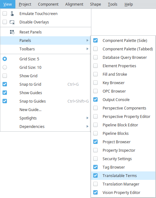

To add the panel to your Designer interface, go to the menu bar and select View > Panels > Translation Manager.

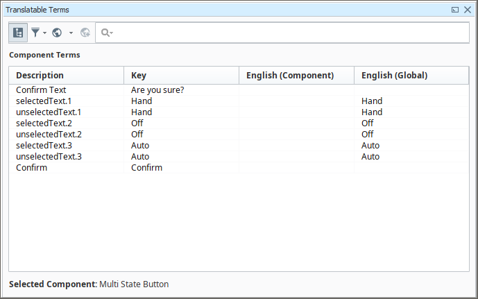

Using the Translatable Terms Panel in Vision​
In Vision, you can view and edit translation keys directly in the Translatable Terms panel. To open it, go to the menu bar and select View > Panels > Translatable Terms.
The panel shows each term for the components in the current window, along with the translations available for the active language.

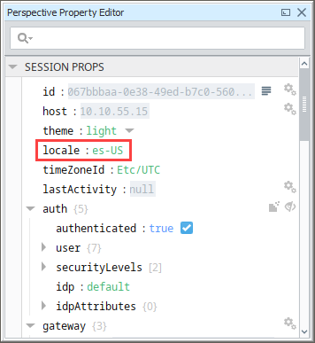

In Perspective, you can preview translations by changing the session's locale. In the Designer, select Perspective in the Project Browser to open the Session Properties, then set locale to the desired language. You can update the locale in a running session through scripting or bindings. When the locale changes, all text mapped to translation keys updates automatically.

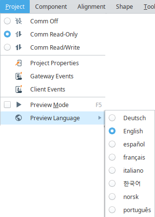

In Vision, you can preview translations by setting a Preview Language in the Designer. Go to the menu bar, select Project > Preview Language and choose a language. When you switch to Preview Mode, text in the window updates to the selected language. You can also use the Language Selector component or a script to temporarily change the language. The Designer remembers your preview language even after a restart, but it reverts whenever Preview Mode is disabled.
