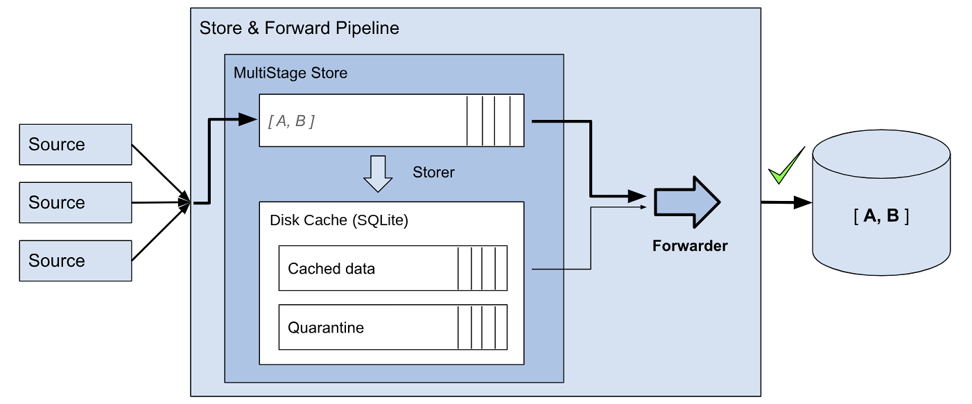

  1. Data A and B move into the memory buffer. Since no other data is being processed, A and B are forwarded to the data sink.
    Data A and B forwarded from the memory buffer to the data sink

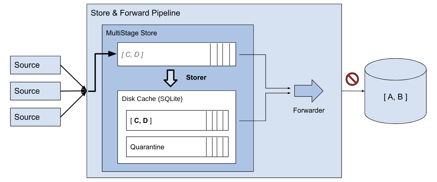

  2. Data C and D move into the memory buffer and are stored in the disk cache while A and B finish transferring.

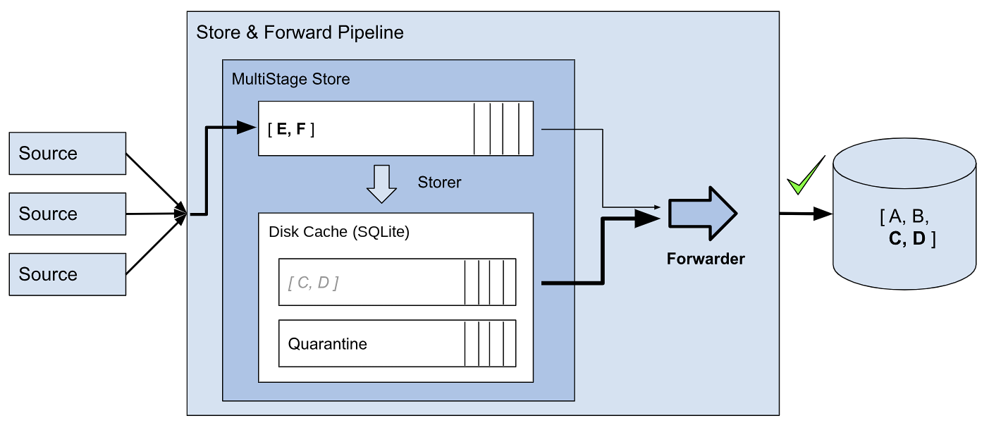

  3. Data C and D are forwarded from the disk cache to the data sink while data E and F move into the memory buffer.

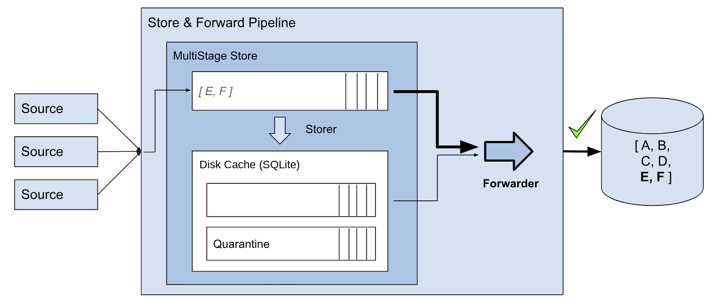

  4. Data E and F are forwarded directly to the data sink, since the disk cache is now empty.
    Data E and F forwarded directly from the memory buffer to the data sink
