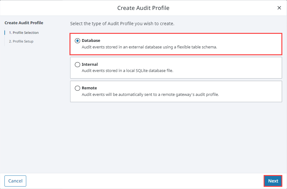

Create a Database Audit Profile​
- Go to the Platform section of the Gateway Webpage.
- Select Security > Audit Profiles from the menu on the left. The Audit Profile Logs page is displayed.
- Click Create Audit Profile +.

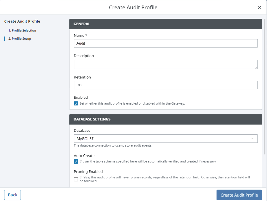

- Select Database and then Next.
- Enter the Name of the Audit Log and Description if desired.
- In the Retention field, set a value in days for how long you want audit records kept. The default is 90 days.
- Under the Database Settings, select the Database where the table will be stored, leave the Auto Create box checked.
- Enter a desired title im the Table Name field.
- Click Create Audit Profile.
Once some changes have been made to a tag or a Database table, Ignition will begin recording.

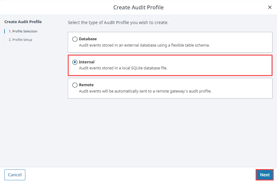

The Internal Audit Profile option allows an Ignition Gateway to store audit records without an external SQL database.
- Scroll down to the Security > Audit Profiles from the menu on the left. The Audit Profile Logs page is displayed.
- Select Internal.
- Enter a name for the Audit Log.
Internal Audit Profile Properties Table​

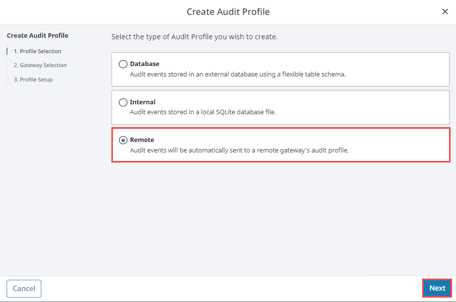

To have your audit events automatically sent to a remote Gateway's audit profile, select Remote, and click Next.

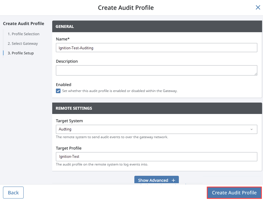

A list of known Gateways will be displayed. If you don't see a Gateway that you expected to see, check your Gateway Network settings to verify that the connections are valid. You also have the option to specify a Gateway manually. Once you've selected a valid Gateway, click Next.
If an Audit profile exists, the fields will auto-populate. The name of the Gateway will appear in the Name field prefaced with the Audit Profile name (i.e., Ignition_Test_Auditing), as shown in the following example. Click Create Audit Profile.
You will now receive a successful message stating your new Audit Profile was created.

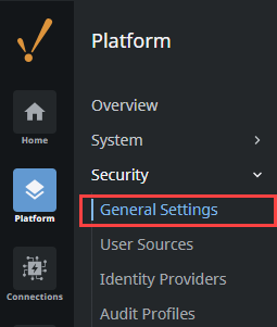

Enabling Auditing for Gateway-Scoped Actions​
After setting up an Audit Profile, you can have the Audit Log record Gateway events.
Navigate to the Gateway General Security Settings page. This is located under Platform > Security > General Settings.
Set the Gateway Audit Profile setting to the audit profile you want to record with, then save your settings.
A confirmation banner will now appear at the top of the page and your Gateway will begin recording events to the specified audit profile.

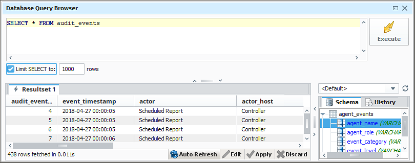

There are a few ways to view audit information: using a Table component, interface on the Gateway, or the Database Query Browser. Here is one example of viewing an Audit Log using the Database Query Browser.
In the Designer, go to Tools > Database Query Browser.
Under the Schema area, double click on a table, and it will expand the query in the Database Query Browser area.
Click Execute. All the Audit Log data will be displayed in the Resultset1 area.
