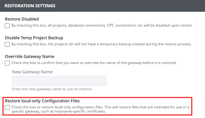

If you are cloning Gateways by restoring the same backup on multiple servers to then be connected via Gateway Network, it is important to notice that there is a Gateway unique identifier in %IgnitionInstallationDirectory%/data/config/local/ignition/gateway-network/uuid.txt. Since no two Gateways connected via Gateway Network should share a .uuid, each Gateway has a new .uuid generated when they are cloned to prevent any collisions.
If you do need Gateways to use the UUID from the backup, you can enable the Restore local-only Configuration Files property under the Backup & Restore page's Restoration Settings when restoring.
Restore local-only Configration Files

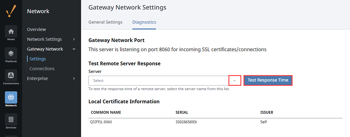

Gateway Network Diagnostics​
The Diagnostics tab on the Network > Gateway Network > Settings page gives you insight to the Gateway and and remote server response times.
  1. To test the response time of a remote server, select the server name from the Server dropdown list.
  2. Click Test Response Time.
The results will be displayed indicating if the call to the remote server was successful, what the response time was, and if there were any errors.

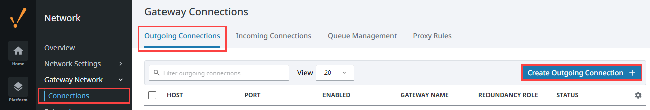

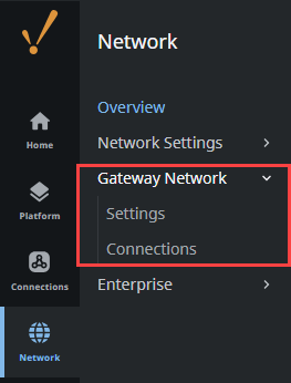

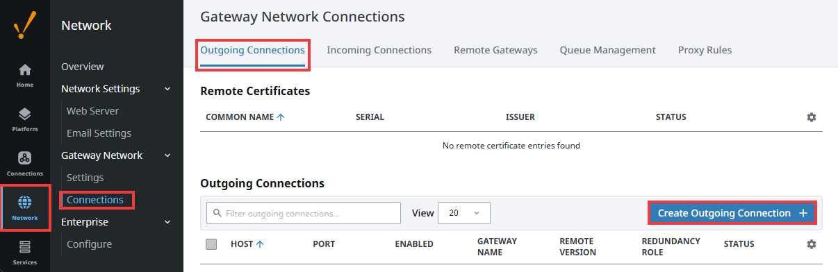

To establish a basic communication link between two Gateways, first log into the Gateway where you want to establish the outgoing connection. For this example, we use an SSL connection.

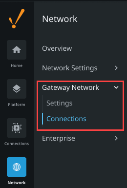

  1. On the Gateway Webpage, navigate to Network > Gateway Network > Connections.

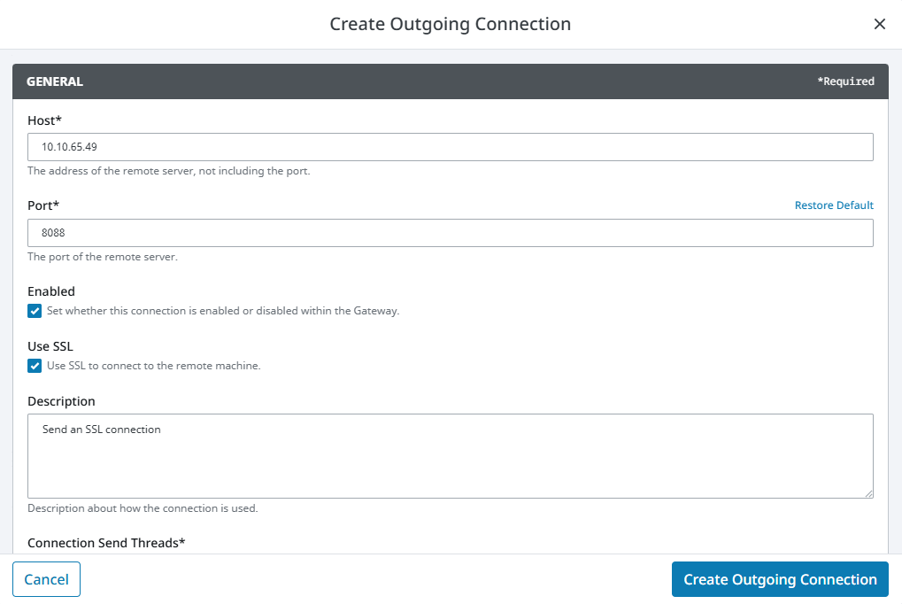

  2. Click on the Outgoing Connections tab. Click Create Outgoing Connection +.
    Gateay Network Connection Example Step 2
  3. In the Host field, enter the network address of the remote server.
  4. In the Port field, enter the SSL port used by the remote server. By default, this is set to 8060 (which is defined /data/gateway.xml).
    note
    This port is different from the default SSL port an Ignition Gateway would use when communicating to a client (default port 8043).
  5. Check the Use SSL checkbox.
  6. Enter any desired information in the Description field to easily identify how the connection is used from the Outgoing Connections list.
  7. Use the default settings in the Ping section and Timeouts section of the form.
  8. Click Create Outgoing Connection.
  9. You'll see a confirmation message that the connection was created.

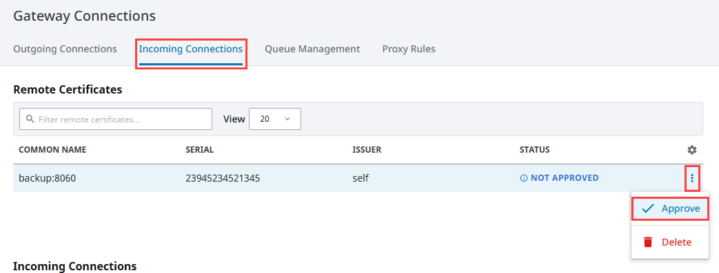

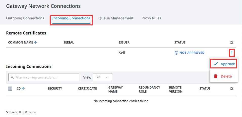

    If you have the Require Two Way Auth property enabled, you will first need to approve the certificate on the Gateway creating the outgoing connection.
  10. At this point, your Gateway transmitted its certificate to the connected Gateway, but the incoming connection is not yet allowed. The Gateway’s connection will not show up under the Incoming Connections section until after the certificate has been approved.

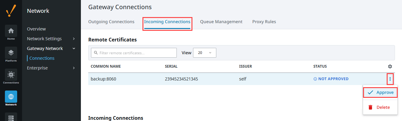

  11. Log into the other Gateway. Navigate to Network > Gateway Network > Connections.
  12. Click on the Incoming Connections tab. The first Gateway’s certificate should be present. The certificate Common Name field holds the network address of the machine that transmitted the certificate. The Serial field holds a numeric string that is automatically generated when the certificate is created, and is unique to every certificate.
    Gateway Network Connection Example Step 12

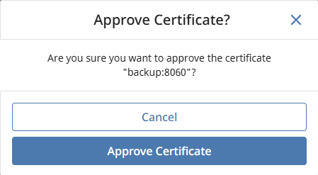

  13. Click the three dot menu and select approve to accept the certificate. You'll see a confirmation message. Click Approve Certificate.
  14. Now the Gateway’s connection will appear under the Incoming Connections section with a PendingApproval security status. Expand the three dots menu and select Approve to establish the connection.

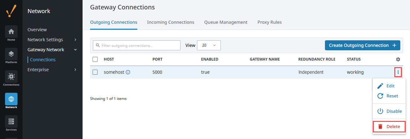

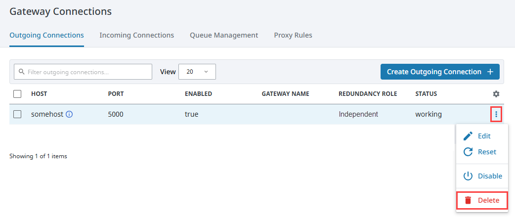

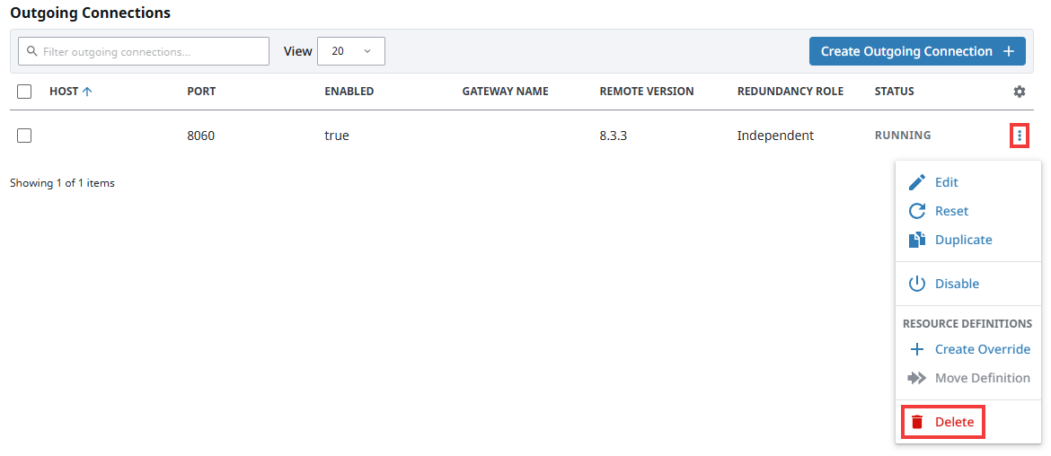

Deleting Connections​
Outgoing and incoming connections can be deleted for cases when the connection no longer exists on the other side.
  1. To delete a connection, navigate to Network > Gateway Network > Connections.
  2. Click on either the Outgoing Connections or Incoming Connections tab.
  3. Expand the three dots menu next to the connection and select Delete.
    note
    For incoming connections, if a remote machine is still connected to the local machine with an outgoing connection, a new incoming connection will be created after deletion. For these cases, you must log into the remote Gateway and delete the outgoing connection. Then you can delete the local incoming connection.
    Deleting Connections Step 3

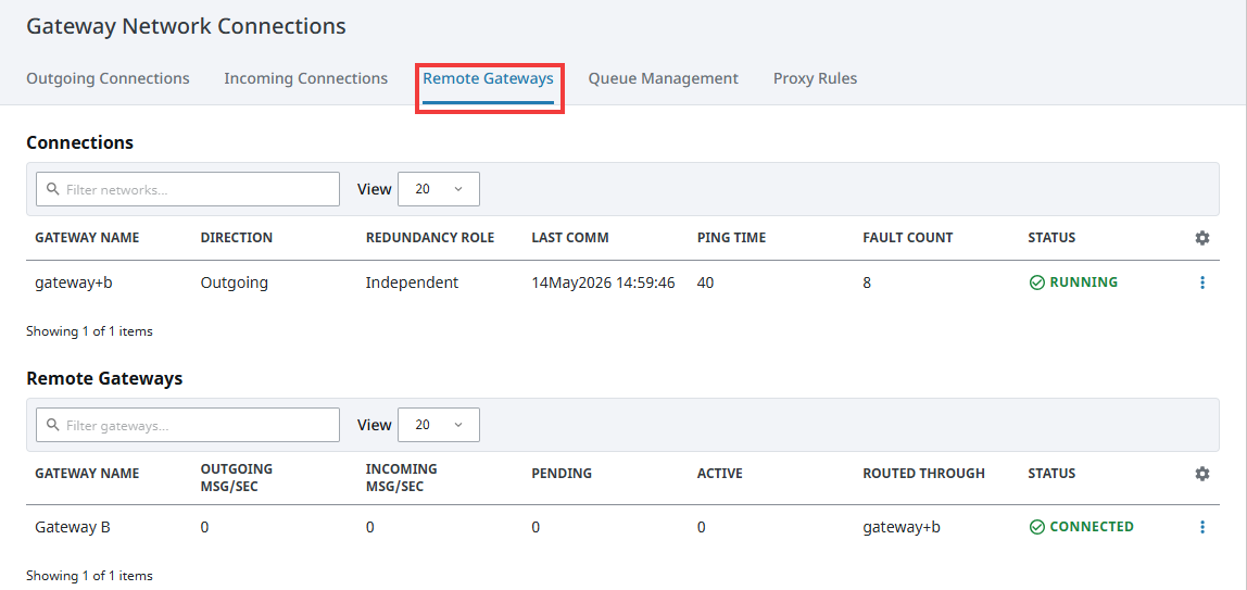

Remote Gateways​
New in 8.3.5
The Remote Gateways tab contains information about both your Gateway Network connections and any remote Gateways you are connected to. Each row in the Connections table will display various metrics for individual network connections, such as the Gateway's redundant role and the connection status. Similarly, each row in the Remote Gateways table will display various metrics for individual remote Gateways, such as the number of outgoing and incoming messages per second. See the Remote Gateways and Connections page for more information.
Gateway Network Outgoing and Incoming Connections

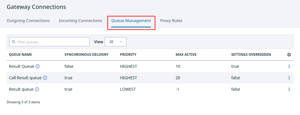

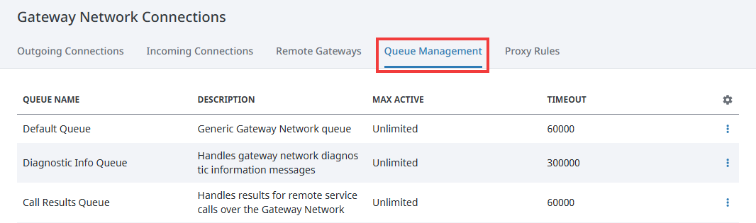

Gateway Network Queue Management​
The Gateway Network system shares information across Gateways using a configurable number of send and receive threads. Gateway Network Queues are named to reflect their purpose and enable Ignition to prioritize which subsystem should have access to send or receive a thread at any given time. The Queue Management tab allows users to further direct how a queue should behave.
Gateway Network Queue Management Tab
Queue Settings​
Expanding the three dot menu and selecting edit for a queue type accesses the Queue Settings panel where the following information is available to view or edit.
SettingDescription
Queue NameName of the queue you are modifying (read only).
DescriptionDescription for the queue you are modifying (read only).
Synchronous DeliveryThis setting is configured by the queue and is unchangeable. If true, the queue will not dispatch another task until the current active task has completed. When a queue uses synchronous delivery, the maximum number of allowed active tasks is fixed at 1 and cannot be changed. Default is false.
Note: Some queues are hard-coded as “Synchronous Delivery” queues, for example the Tag Value Update queue. For these queues, the Max Active setting is fixed at 1 and cannot be changed by the user. The user can only change the priority of the queue.

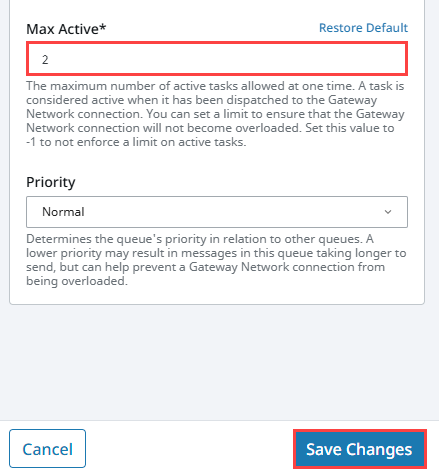

Max ActiveThe maximum number of active tasks allowed at a time. A task is considered active when it has been dispatched to the Gateway Network connection. You can set a limit to ensure that the Gateway Network connection will not become overloaded. Set this value to -1 to not enforce a limit on active tasks. Default is -1.
PriorityDetermines the queue's priority in relation to other queues. A lower priority may result in messages in this queue taking longer to send, but can help prevent a Gateway Network connection from being overloaded.
Adjust Queue Message Capacity​
Overloading a Gateway’s queue active messages can starve the send or receive threads for Gateway Network connections. Starving the send or receive threads for the connection can potentially prevent other subsystem messages from getting through. To solve this issue, edit the Max Active field to set a limit that will allow the Gateway Network connection to continue functioning correctly.
Since this is a known problem with Tag History Queues, we will use an example with a GatewayA and GatewayB, where GatewayA requests tag history data from GatewayB to display on a chart. A user has noticed other items related to the Gateway Network connection, such as remote tags, are no longer displaying properly. After confirming the network is not the issue, the problems indicate a slow database may be causing a cascading effect where other messages are delayed by all the Tag History Query calls.
This cascading effect happens because the Gateway Network asynchronously dispatches some functions. One Gateway thread handles the initial call, and a different Gateway thread dispatches the call’s results. In our example, GatewayA is unaware that GatewayB is taking a long time to run the queries and will continue to dispatch more tag history requests. When the limit of send and receive threads available to a Gateway Network connection is reached, other messages can no longer get through. This can be verified as the issue by checking GatewayB’s current Incoming/Outgoing Tasks and Results Response Time.
Adjusting queue message capacity controls the flow of requests to prevent thread starvation across the network. Select Edit from the three dot menu for the Tag History Queue to access Queue Settings and adjust capacity. Make sure the Gateway responsible for the thread requests is where the queue capacity is updated. In this example, GatewayA Tag History Queue Max Active count was set to 2 and saved by clicking Create New Queue Override Settings.
Since the Tag History Active upper limit has been met, your Remote Gateway will now have pending items. Pending tasks are ones that have not yet been picked up for dispatch by the Gateway Network connection. These will be discarded if not dispatched within 1 minute. Be aware these requests being deleted may show more errors on components like the GatewayA chart, but all other subsystem messages can now get through without issue.

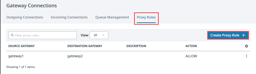

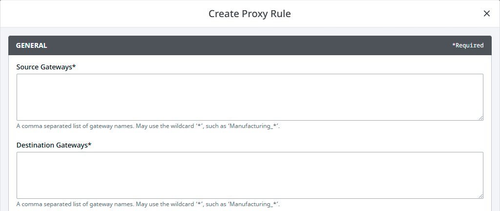

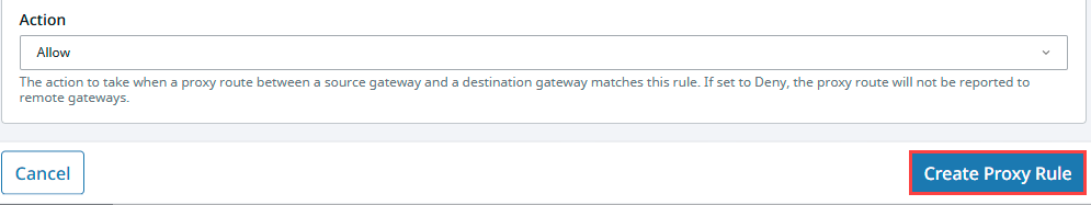

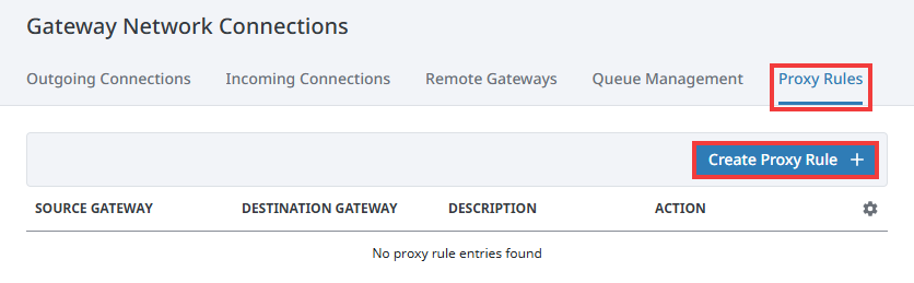

Gateway Network Proxy Rules​
Gateway Network Proxy Rules allow you to control the amount of service enumeration calls over your Gateway Network. Service enumeration calls run every 60 seconds against every other Gateway the local Gateway is aware of, including Gateways on the opposite side of a proxy connection. Given enough Gateways, this may result in a large amount of network traffic, negatively impacting your Gateway Network.
Changed in 8.3.4
Starting in version 8.3.4, backend polling for the Gateway Network has been replaced with an event-based system, helping to reduce the amount of Gateway Network traffic.
note
Setting up proxy rules is not mandatory when creating a proxy connection, as this is handled by the Allowed Proxy Hops property in the Security section above.
Proxy Rule Settings​
The following table represents the various configurable settings within a proxy rule. In addition to specifying individual Gateways, you can use wildcards to list out Gateways you want.
NameDescription
Source GatewaysThe list of Gateways that are asking for available routes. If the asking Gateway is on this list either by name or wildcard, the proxy Gateway will check the list of Destination Gateways to determine what to do next.

Setting up a Proxy Rule​
  1. Navigate to your Gateway Network configuration settings, located at Network > Gateway Network > Connections.
  2. Go to the Proxy Rules tab and click Create Proxy Rule +.
    Setting up a Proxy Rule Step 2
  3. Set up your list of Source Gateways and Destination Gateways. See Proxy Rule Settings for a description of each setting.
  4. Give your rule a description. This will make it easier to identify the purpose of your rule in the future.
  5. Set the Action setting to either allow the proxy route or deny the proxy route, then click Create Proxy Rule.
A few things to note about proxy rules:
  • Proxy rules are followed in a top-down order, with the rule at the top of the list having the highest priority.
  • Proxy rules are bidirectional. If a controller Gateway can access an agent Gateway with proxy rules, the agent Gateway can also access the controller Gateway.
  • Proxy rules view redundant Gateway pairs as a single entity.
