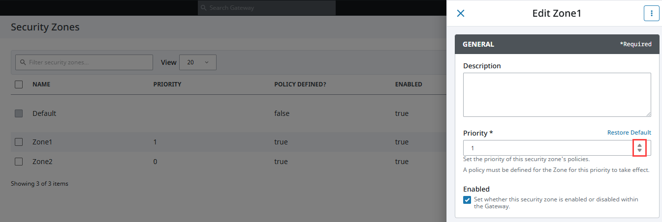

This is where Security Zones come in. While Security Zones themselves don't define the security, they instead define an area of the Gateway Network, breaking up Gateways and network locations into manageable zones that can then have a policy set on them. Once there are zones defined, a policy can be defined for each zone, and a priority of zones can be set in the event that more than one zone applies in a given situation. The priority of a Security Zone is set when it is created, but can be updated in the Edit panel. The policy from the highest priority Security Zone will be used.
For example, say there is a Zone1 and Zone2 configured. Zone1 includes specific Gateways, one of which is also contained in Zone2, that will have query and storage history access and read/write/edit access to tags. Zone2 dictates all requests coming from a range of IP addresses have query only history access, and read/write access to tags. We would want to make sure Zone1 is above Zone2 in priority, so that the Gateway in both Zone1 and Zone2 gets the full access rights afforded to it by the policy of Zone1, instead of getting the limited access rights from Zone2.

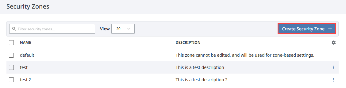

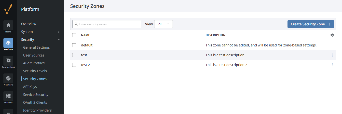

  1. Under the Platform section of the Gateway Webpage, go to Security > Security Zones.
  2. Select Create Security Zone +.

  4. If there will be multiple Security Zones, you may want to adjust the Priority value. Increase the value for a higher priority, and decrease the value for a lower priority.

PriorityThe priority of the Security Zone's policies. A policy must be defined for the zone for this priority to take effect.
EnabledSets whether the Security Zone is enabled or disabled within the Gateway.
