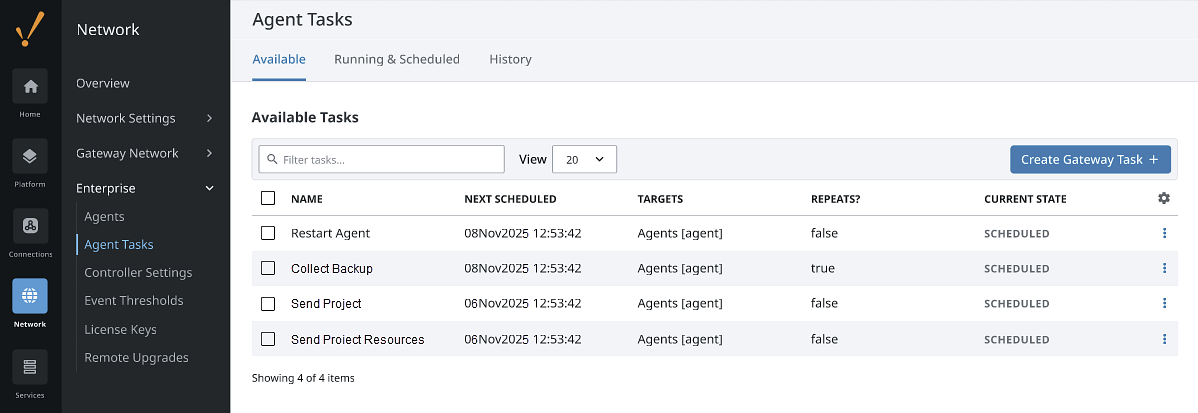

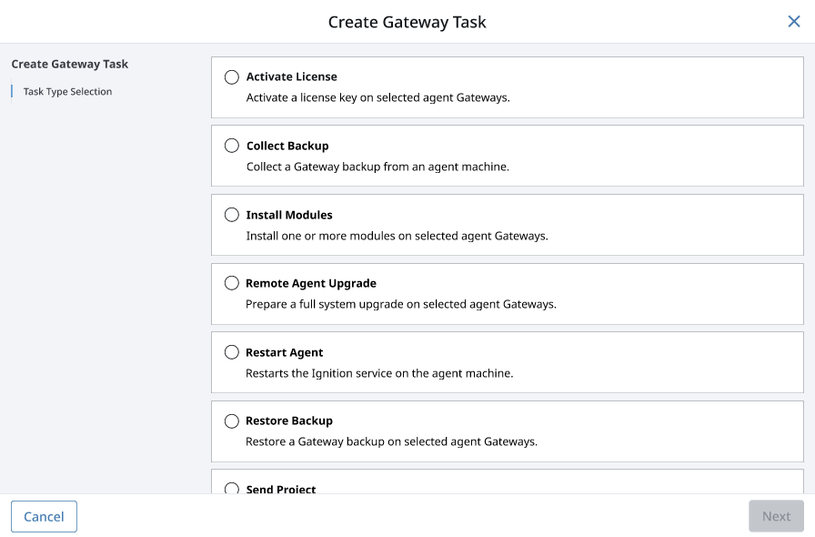

Task Managementβ
EAM allows you to schedule common Gateway tasks to execute against remote agent Gateways. Tasks are requests sent to an agent by the controller. These requests cause the agent to perform an action. Tasks include:
- Activate License
- Collect Backup
- Install Modules
- Remote Agent Upgrade
- Restart Agent
- Restore Backup
- Send Project
- Send Project Resources
- Send Tags
- Unactivate License
- Update License
On-Demand or Scheduledβ
Gateway tasks can be executed immediately, scheduled to run once at a later time, or set up as part of a recurring schedule. The Schedules can be freely modified or paused. Scheduled tasks can also execute on-demand, allowing the tasks to be called at will.
