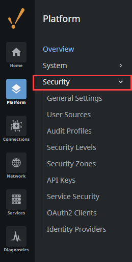

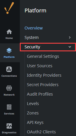

Security in Ignition falls into a few categories, tying into the various scopes (Designer, Gateway, Vision Clients and Perspective Sessions). In the Gateway scope, the bulk of security setup happens under the Platform section of the Gateway Webpage, under the Security header, you'll find pages for authentication, role mappings, and zones.
The primary purpose of Gateway security is to protect access to the two most critical areas of Ignition: the Designer and the Gateway. Many important resources are configured in these areas, so access to each Gateway section, as well as the Designer, can be limited by Security Level.
